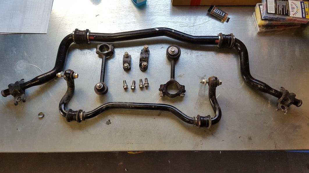

Removed the KDSS sway bars. The system is still in tact. Jacked up the pistons to fully collapsed and secured with steel cable. It's a trial to keep the system so it can be installed versus an entire gut.

I'm sure one stamp ought to cover the postage. So far, it does the trick. Didn't take but a couple of hours to do, and I had all the cable and clamps at the house, so I didn't even have to run to the hardware store.
