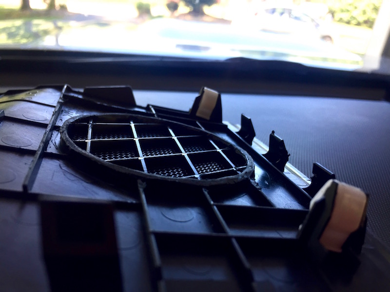

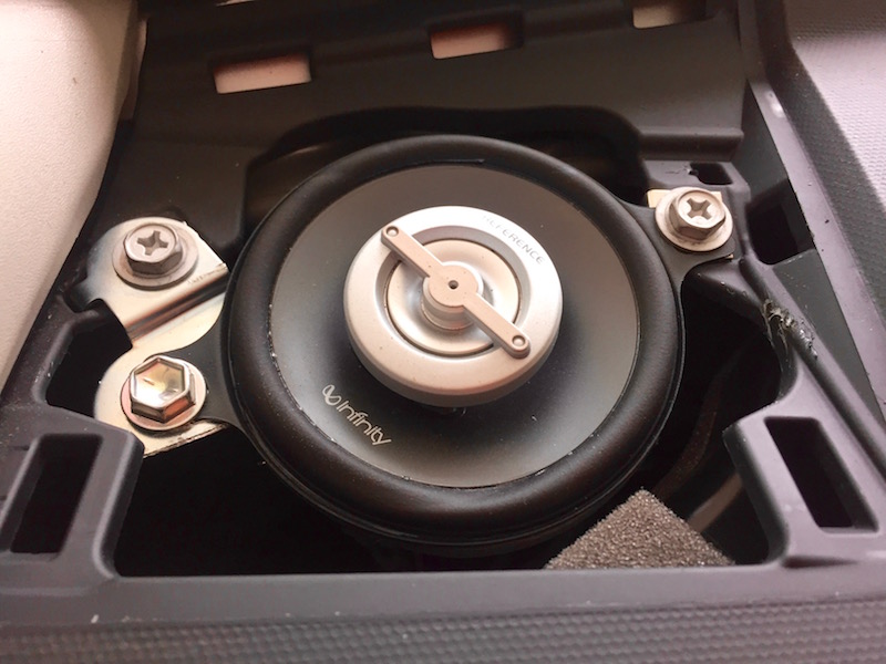

Trimmed the back of the dash speaker grills because I believe they were hitting the cones or surrounds of the Infinitys at higher volumes. Now, much better bass and no weird popping noises. Still can't believe how much better the stock stereo sounds with the dash speaker upgrade and the party mode mod.:rockon:

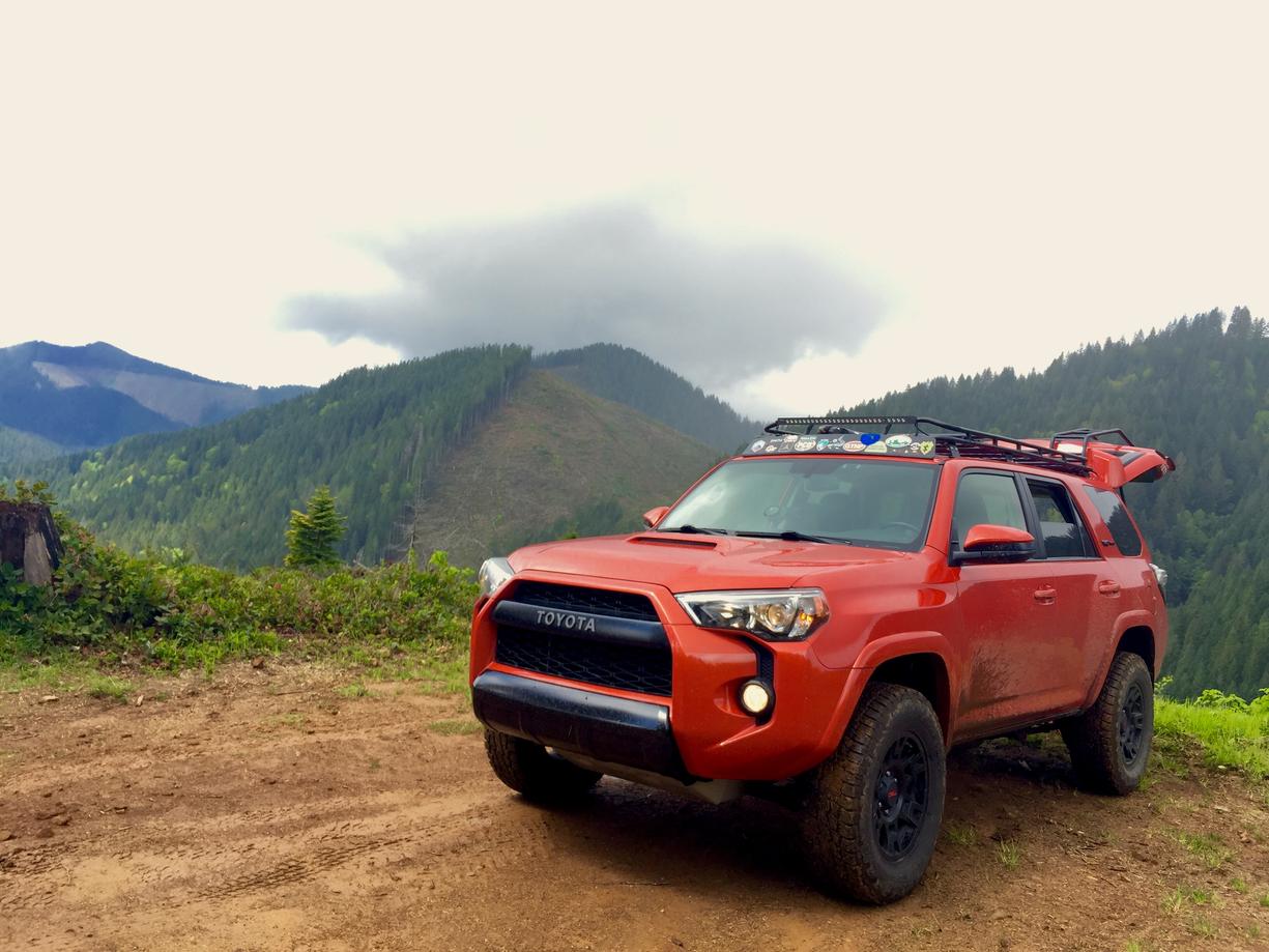

Hiked up an old access road to see if the Pro would make it. I think it will. Will return with my copilot to spot me over some tricky boulders.
