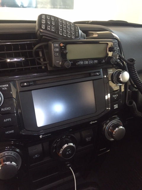

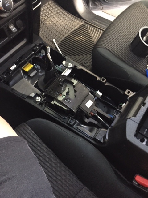

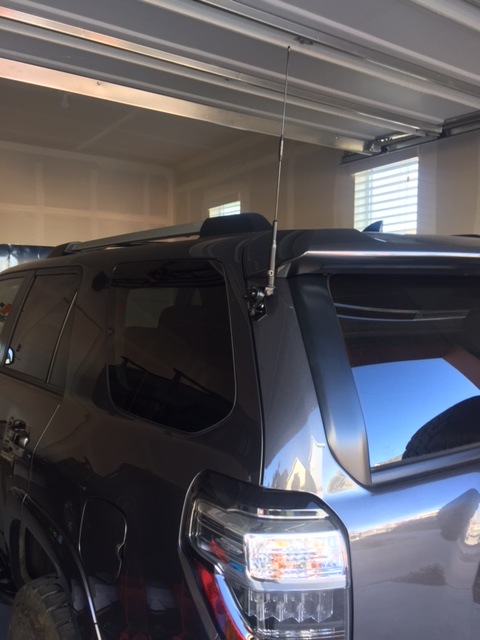

Installed my mobile ham radio and 2m/70cm antenna.
Icom 2730A, Comet SBB-2, CP5 mount. Antenna cable runs through cargo headliner, down through the passenger side kick panels, and underneath front passenger seat where the Icom brains are located. Power to the brain runs under center console, underneath steering column and out through the firewall rubber grommet. Cable from brains to head unit runs under center console, up behind AC controls, and into the back of glove box through the dummy switch cover.
Haven't finalized head unit mount or mic hanger.
