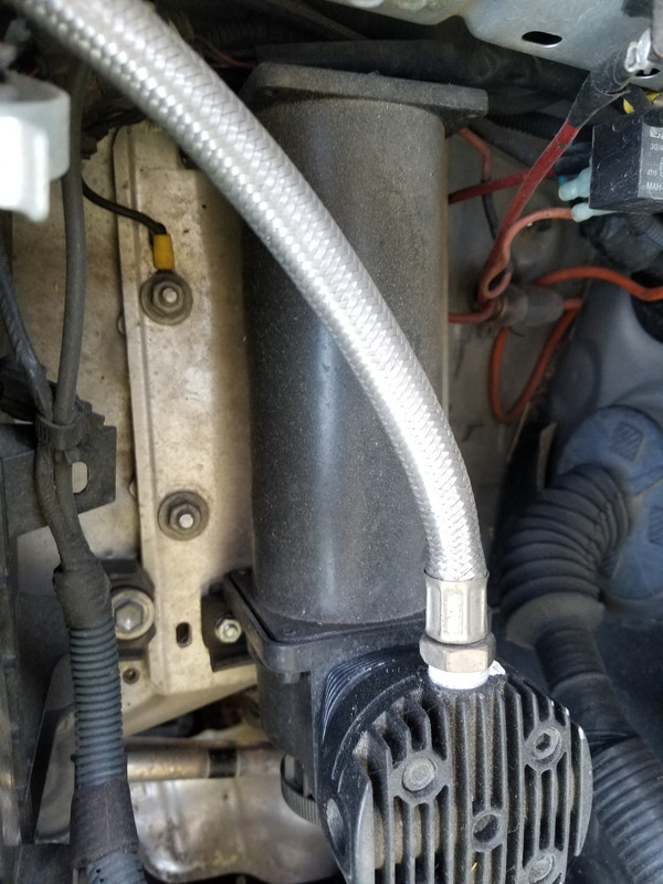

What did you use to mount your Viar pump in that location?
I used 2 license plates that I got from the dealer I used to work at. Put the metal side up, drilled holes to match the places where the threaded studs are and bolted it down there.
