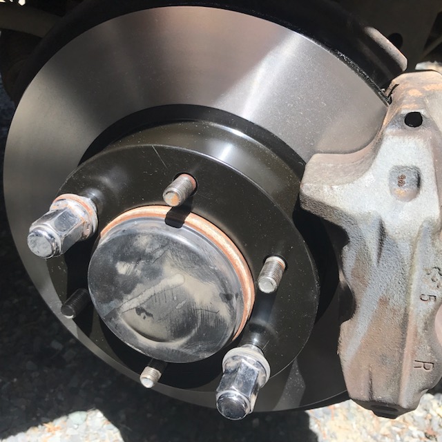

New pads and rotors.

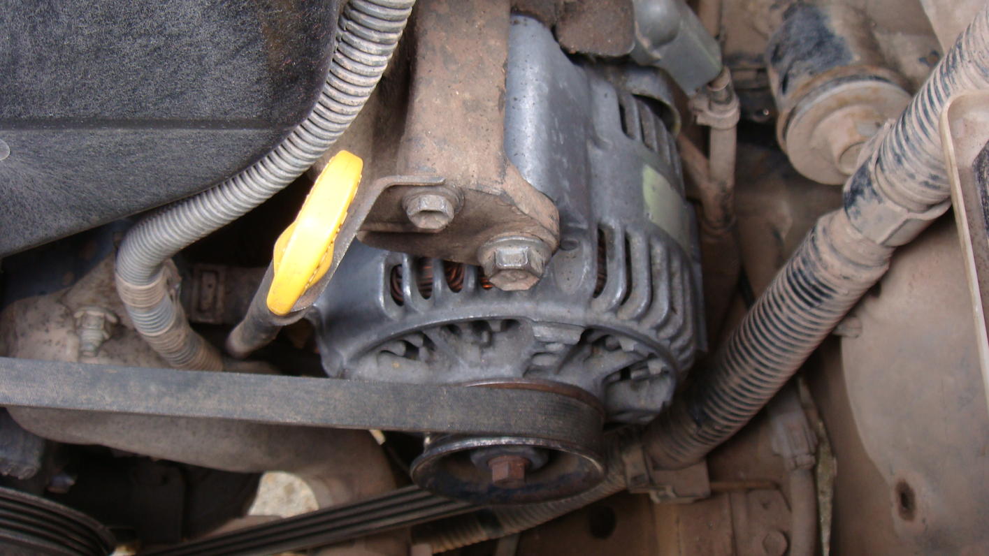

Today my bro & I visited a local junkyard in search of an OEM alternator for my 2001. Fortunately, there was a '99 that had been wrecked and was there, so naturally I went straight to it. Found the alternator still in tact with the vehicle, unhook and unbolt everything and snag that bad boy. Pretty clean to be rather honest. No mud inside or any signs of potential harm done to it. Also scored a chrome grill with gold emblem with ALL the clips on it, none broken, except for half of one, but it didn't cause any issues. So I replaced my black bed lined, satoshi grill with the new chrome and gold one. I won't clutter this thread with photos, so here are only two. Alternator all cleaned up and in my Runner along with the new grill. Also to mention, I needed another alternator because the aftermarket remanufactured one that I had in place had a bad bearing inside of it, causing it to whine obnoxiously.

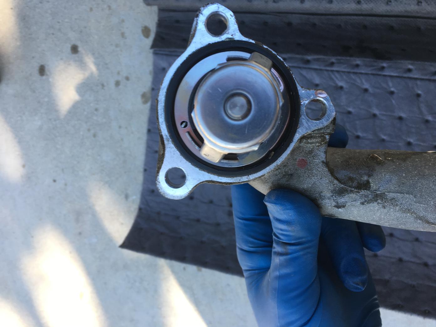

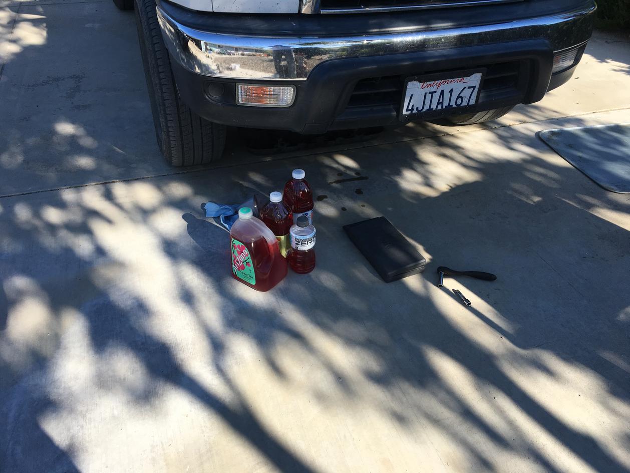

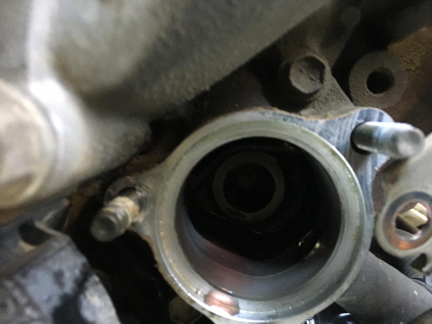

Since I was running temps of 203 avg and as high as 208.4. I thought I would put in a new Toyota thermostat and cap. I put the new cap on a few days ago and it did not make a difference.
Drained the coolant and I got about 2 gallons out, I was expecting about 1 to 1.5.
When i removed the thermostat housing the thermostat came out with it, and sure enough the jiggle valve (original) was at 12 position.
Everything else looke good so I buttoned up with the jiggle valve at 6 position. Went for a drive and the temps never got above 194.4
