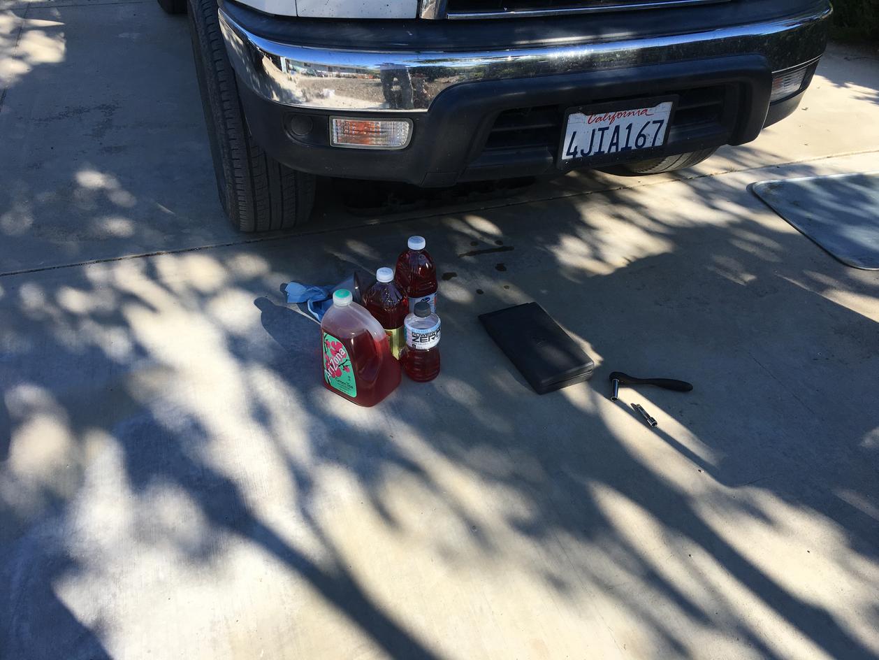

Drained the coolant and I got about 2 gallons out, I was expecting about 1 to 1.5.

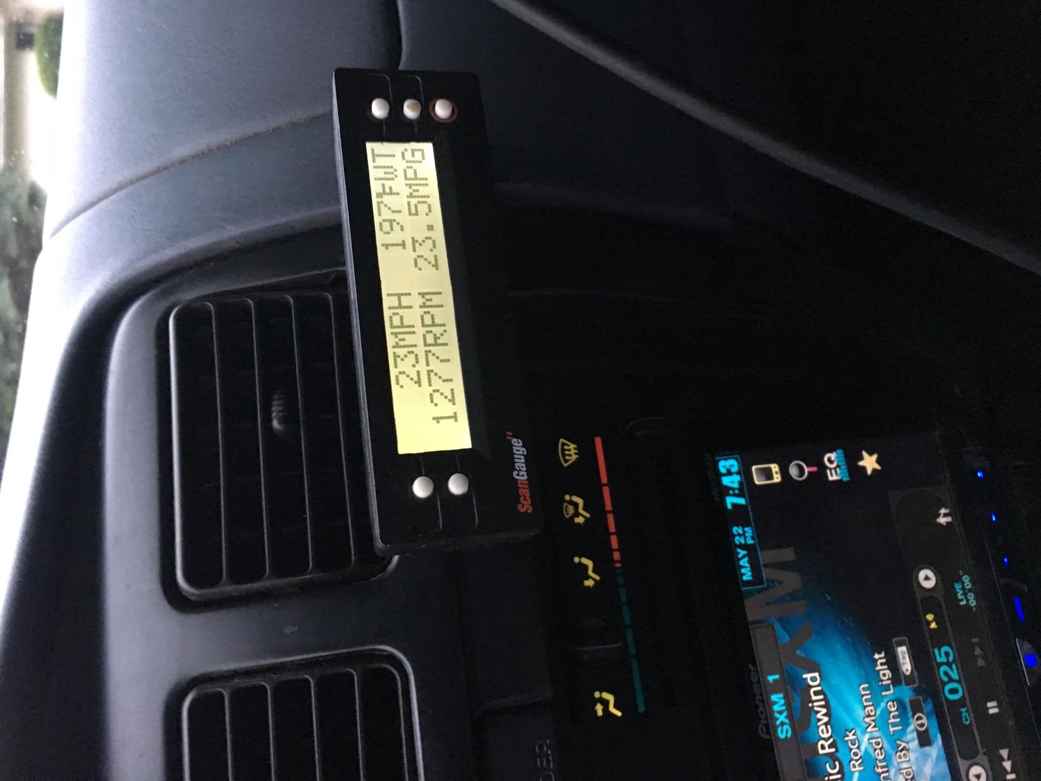

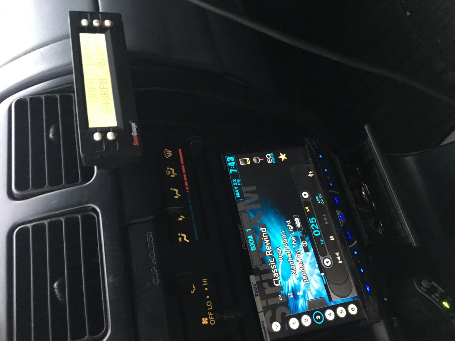

Scan Gague
One of the things I got done today was to mount my scan gague today.

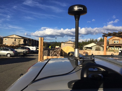

Today was a day of tidying up things... I gave her a couple of pieces of shiny shiny and finished up my home brew satellite radio install!
The ridiculous antenna is a necessity here. The angle of the satellites is so shallow up north that a tree can block the signal. Total cost, was about $3 because I had to buy some new hardware. Everything else was laying about the house.

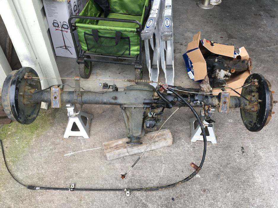

Getting the spare regular rear axle ready for an eLocker!

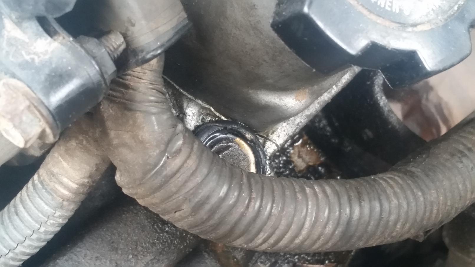

a co-worker helped me do my valve cover gaskets today. torqued to spec. when i got home, notice oil leaking, opened the hood and found a crack in the valve cover. lucky it's not my daily driver.
