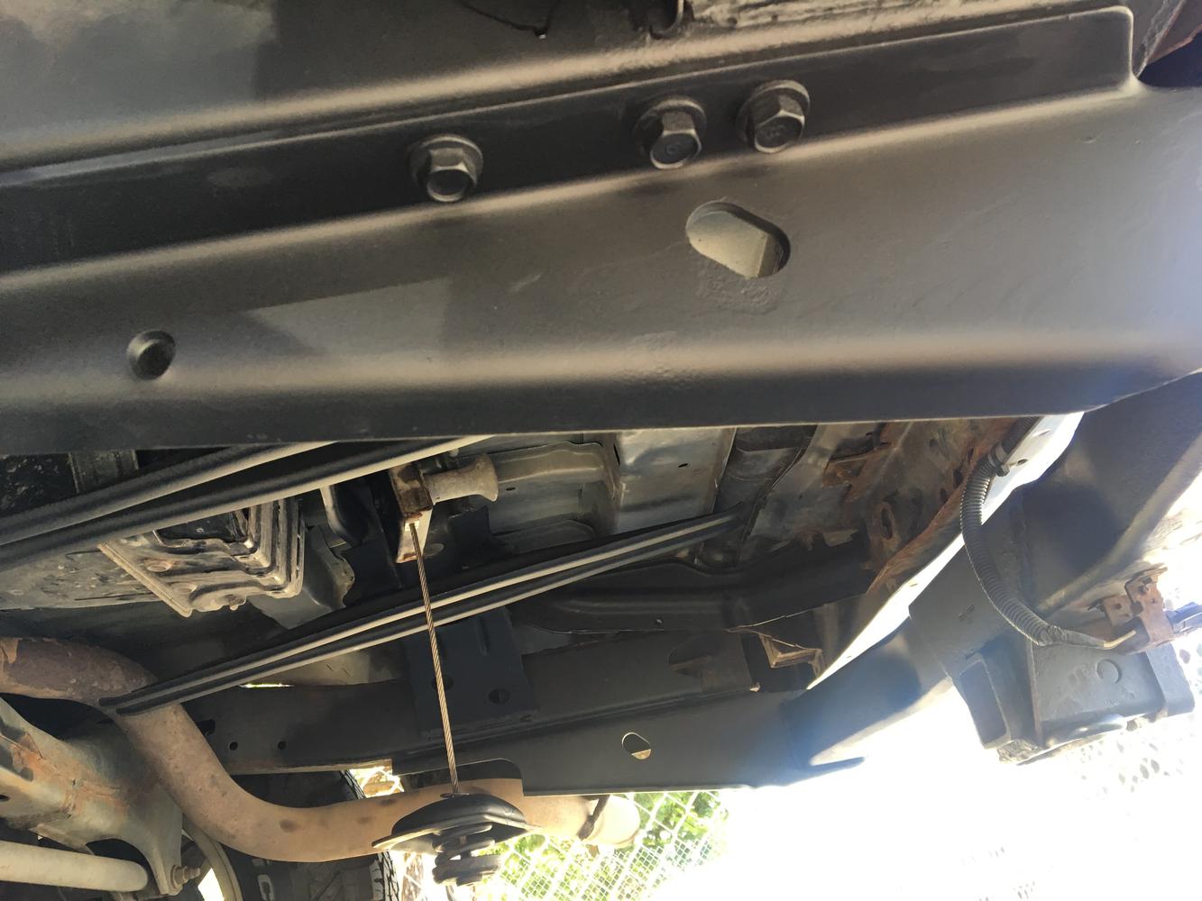

I also finally started removing and painting over the rust on the frame underneath. That cross piece by the axle had a lot, I spent a good hour grinding / dremmelling off the loose stuff and that was only on the bottom and back side of it, I can't access the front and top of it. That will have to wait until I get a body lift and the axle comes off to allow access. I had four spray bottles, one with soapy wooder as Chrix Fix says, one with plain wooder, then methanol, then acetone. Cleaned it up nice, I didn't even need to touch it after that before painting.
Toyota really skimped on the black underside paint, that stuff its really thin. With any gravel hitting it you will get a ding which will start rusting, what do they expect to happen? It would have been nice if they galvanized the frame first. I used a couple coats of Rust Trap and I'll put one coat of black Rust Oleum black rim paint over that to protect from UV. That should hold up a couple decades. Inside I'll spray fluid film or some other anti-rust coating.

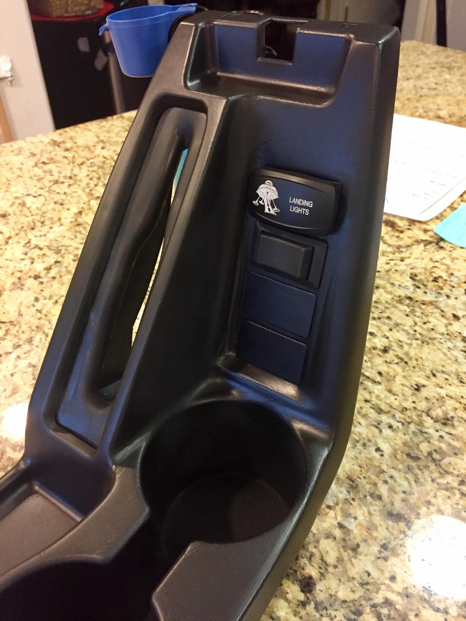

Thanks [MENTION=74071]Brilliant[/MENTION] For Cupholder Switch Mod idea... I didn't execute as well as you but it is totally functional! I could have used more body filler and sanding...settled for good enough :cool:
