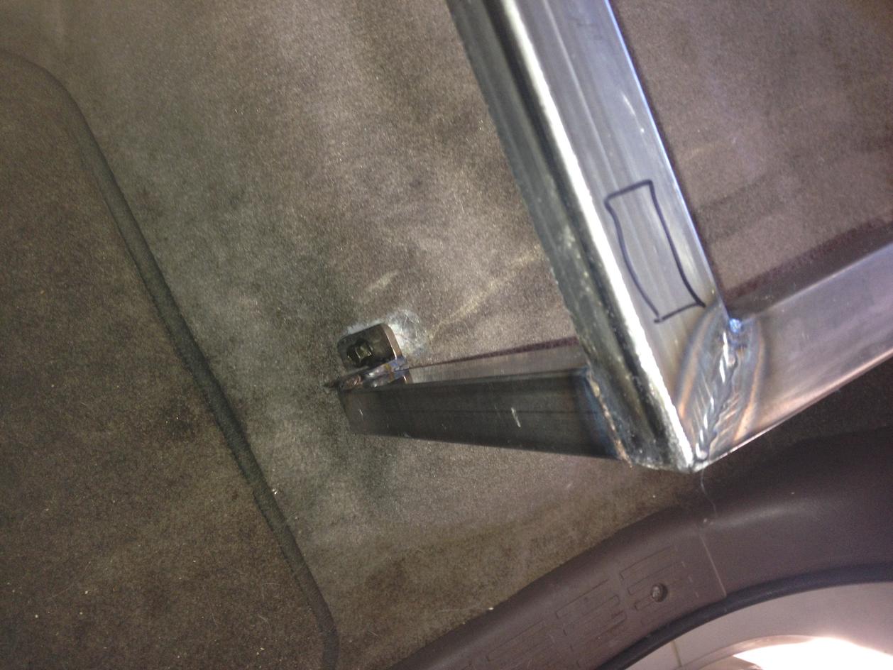

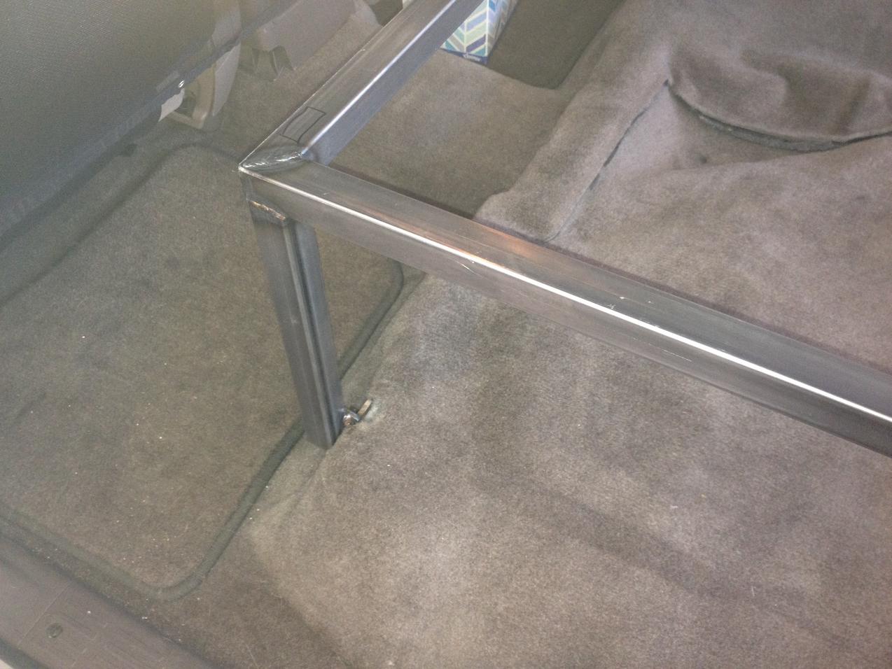

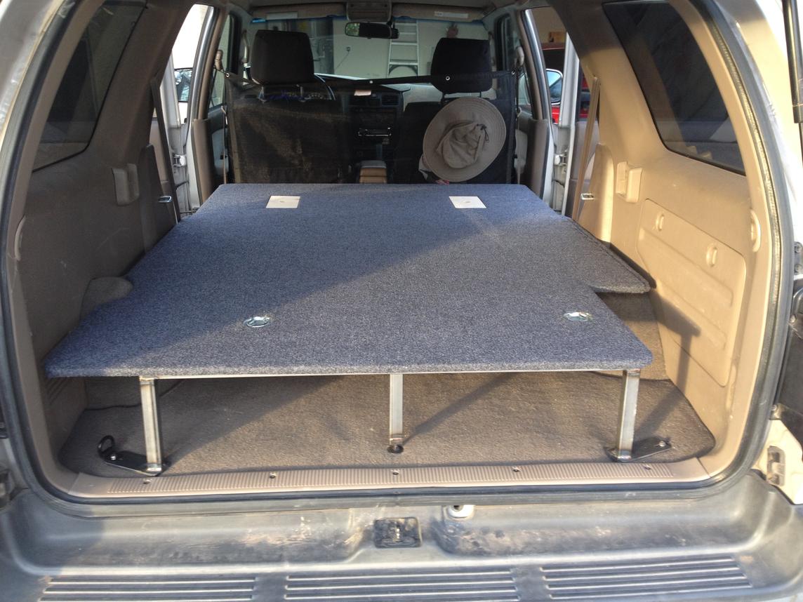

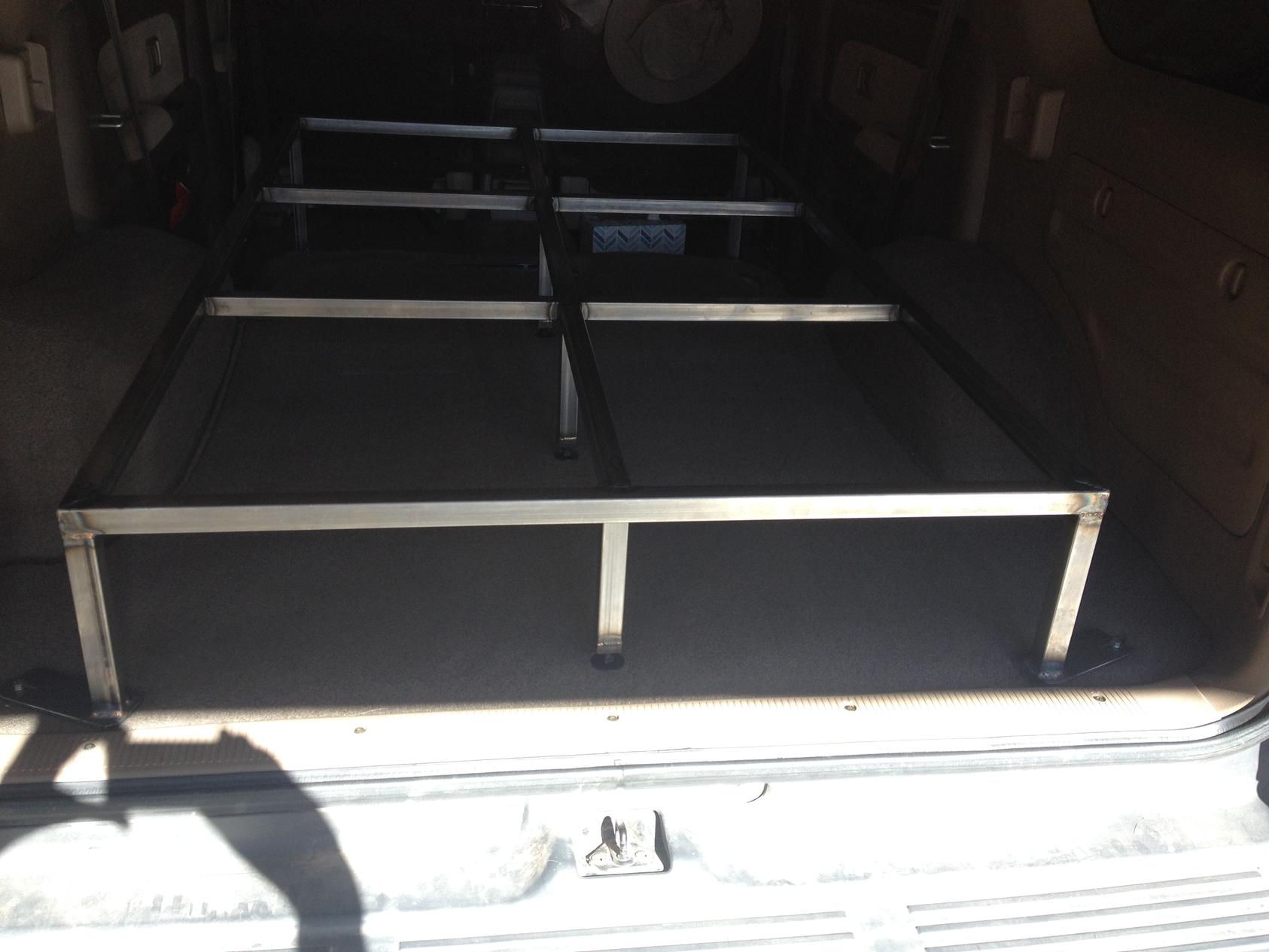

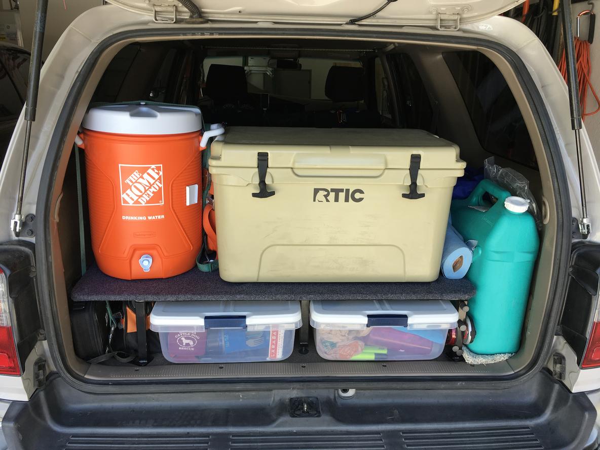

I've been working on this for months and finally built something that works for my needs. Thanks to the T4R community for the wealth of information and ideas. I'm not much of a poster, it thought I'd share my platform build just in case someone else out there is looking for ideas.
Materials used were 1" square steel tube, 1/2" plywood, piano hinge, speaker carpet and lots of time at the drawing board. The whole thing weighs less than the seats that were taken out and nothing was altered with the vehicle.

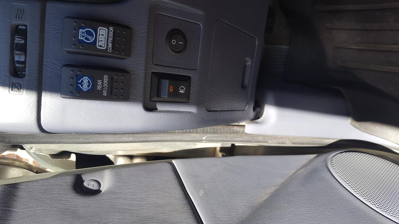

Installed ARB switches and wiring... Installing locker next weekend.
Still not sure where to mount the compressor. Any suggestions?
