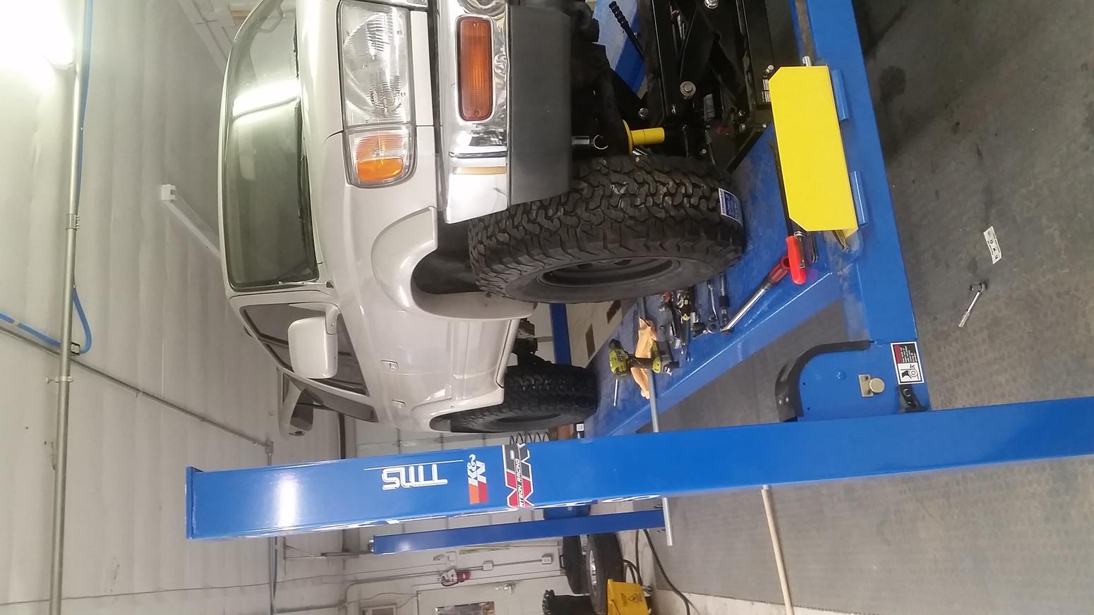

[MENTION=95183]octanejunkie[/MENTION]. My original post I bought my 2000 T4R pre-owned 8 months ago but unfortunately the person I bought it from did a crap job at maintaining it apparently. I just found out the Cat converter was welded back on both sides so my truck is now struggling to drive normally because the cat seems to be clogged and the o2 sensors seem to come up bad based on a reading I recently got. Then I find it has two o2 sensors and one is apparently hard to find from what I was told. Not sure what type o2 sensors to even look for this model. As if that wasn't enough my battery is dead as well so it dies on me as soon as the truck is turned off and I have to get a jump in order to get to work. I took it to Advance Auto Parts and they ran a test on the battery. It's definitely not the starter. So I have no choice but to get a new battery. Any suggestions where I can get these parts for a decent price?
Also it's already at 200+ miles and I was concerned as to how much longer my truck would last me with proper maintenance. I provided pics in my previous post.

Wow, you've got a lot going on here.
Any competent muffler shop should be able to assess your exhaust issue. You can find out easily which sensors your truck needs by inputting your vehicle's VIN into one of the many online Toyota parts sites. You could also research it here as this is not a new issue - I'm also sure a parts store could look it up while you're buying a battery.
Good that you're willing to do the maintenance needed to get your truck running right and reliably - which will cost some money.
