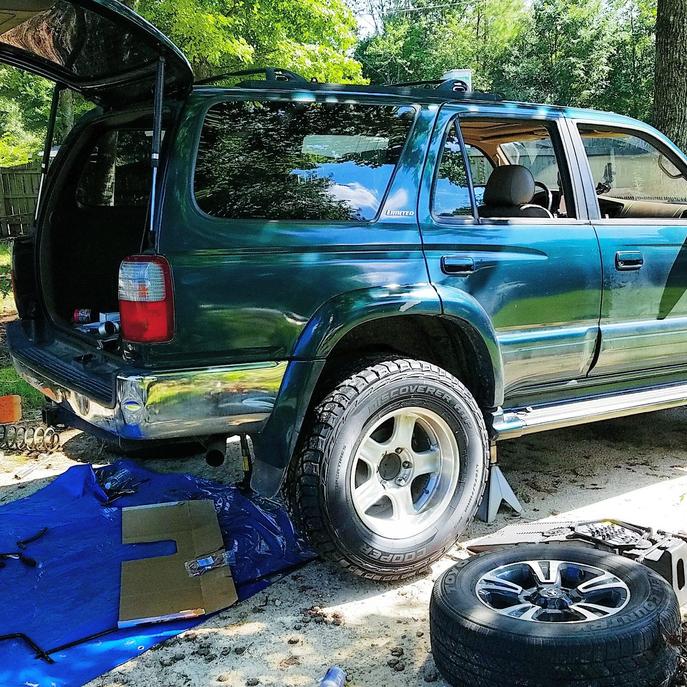

finally installed my wheels tires and left took to long but i am glad now
lol dont worry guys this time i used 2 6 ton jack stands 2 bottle jacks ramps and wheel chocks

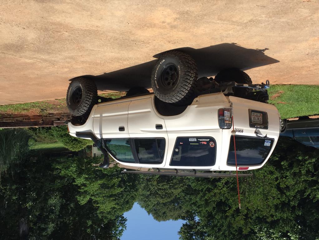

Looks good, but are you sure that will support the weight of the truck? ;)

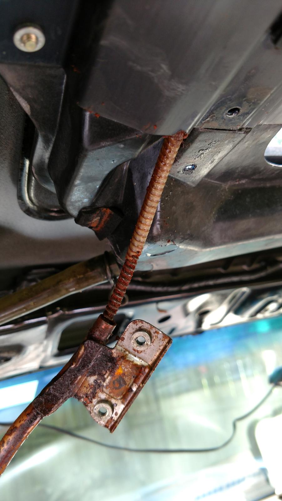

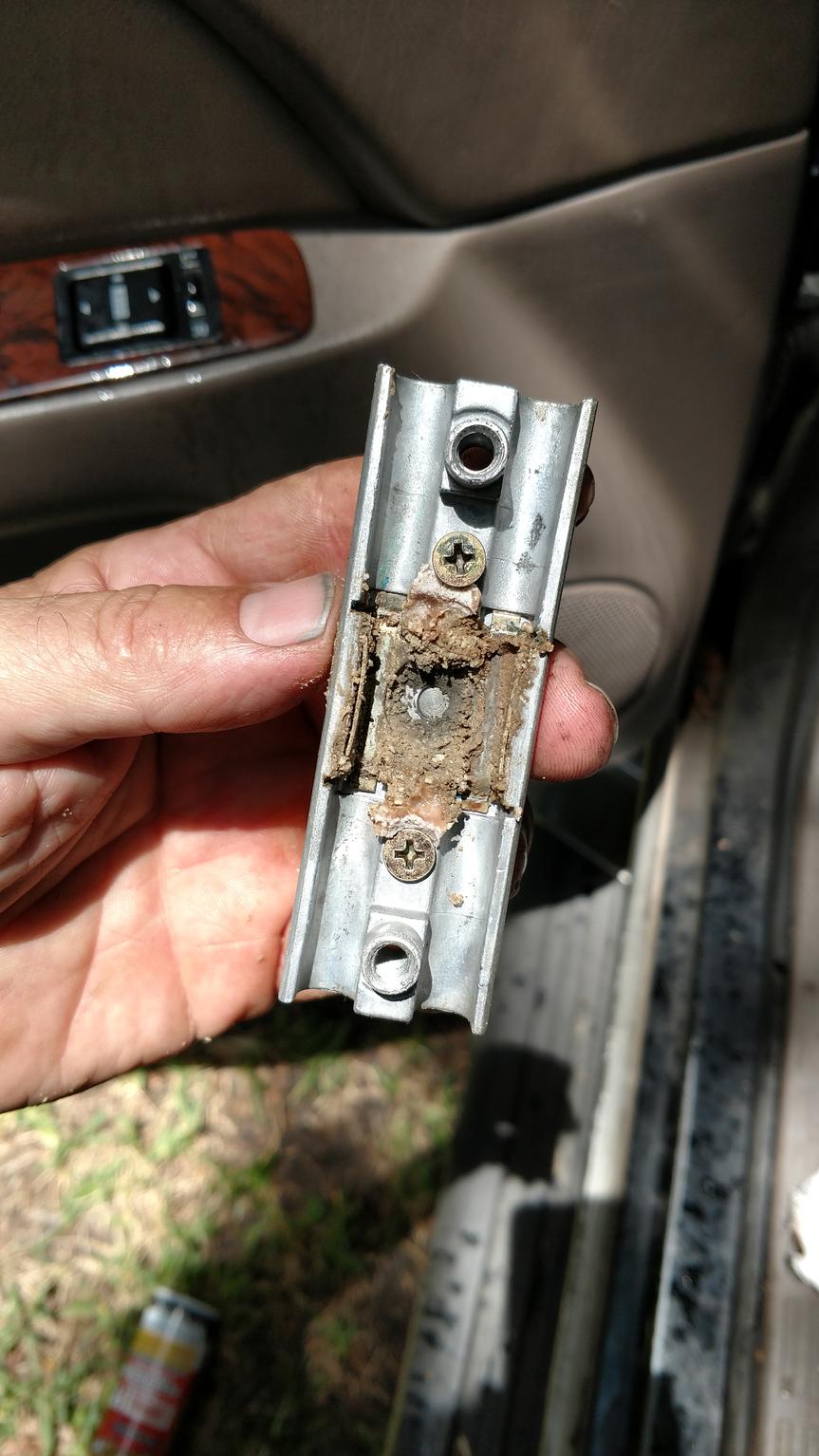

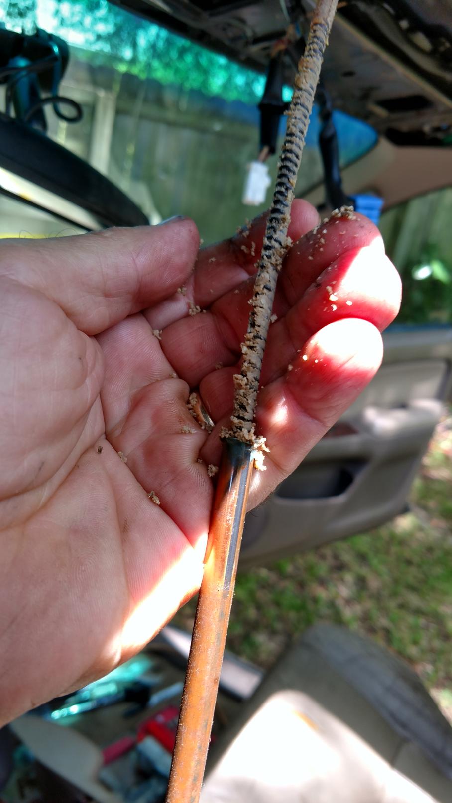

sunroof
tore apart the sunroof. 85% closed wouldnt move and leaking. motor was trying to go. CHALLENGE ACCEPTED =fatal last words. Got it apart this is what I found
Gear housing was the first warning
The cables were frozen in the tubes.
Packed in there was this nastyness. feels like hand cleaner with pumice. I guess just packed in for almost 20 years.
Got three of the 4 cable covers off. the 2 return covers came off fairly easily. the drivers side Had to be persuaded with MAAP gas. The last one is still fighting me. But challenge has been accepted so it will come off one way or another.

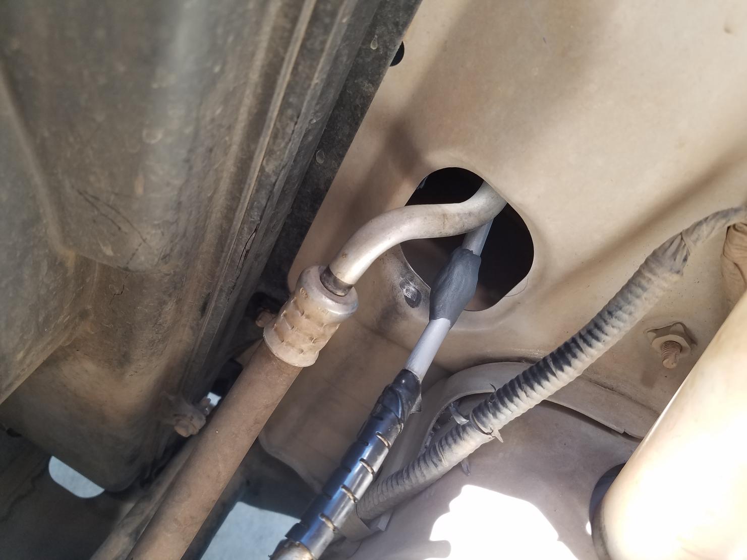

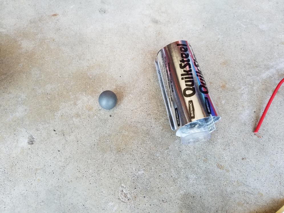

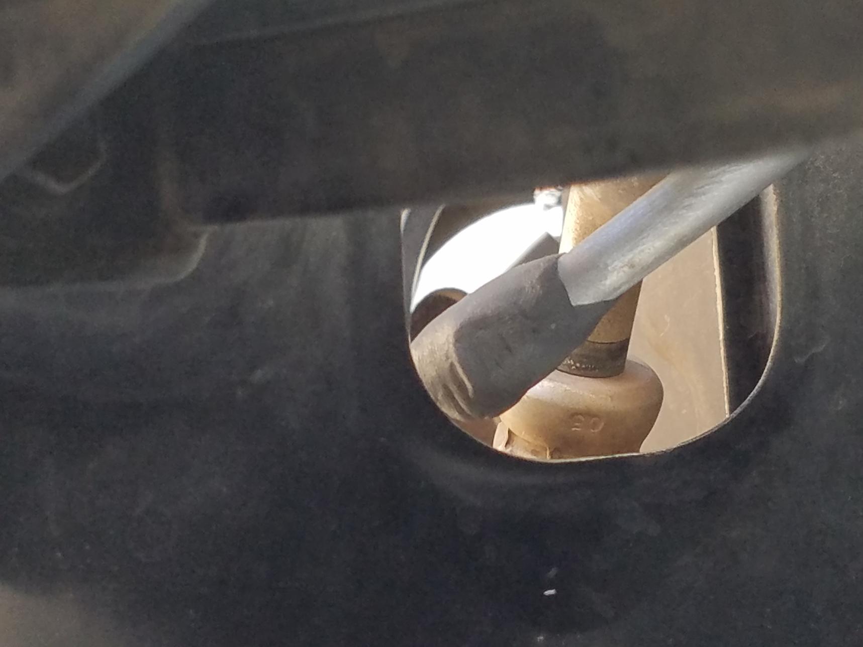

Fixed an AC line over the weekend with some quick steel. Worked great. Just recharged the system tonight. Used the AC Pro recharge kit from Walmart. $35. The system took entire can. Quick steel patch held no problem. AC blows colder than ever. Very pleased with the outcome.

Just wondering how you found the leak
Sent from my SAMSUNG-SM-G890A using Tapatalk
I heard a hissing under hood. Popped hood and took a face full of refrigerant. The line rubbed the chassis cutting through it. It was an easy find since leak was so large.
I had used JB Weld before on my f150 to fix the AC line as well a few years ago. Worked perfectly for years until I sold the truck.
I wonder if that a common place for failure? I ran my tranny cooler lines through that hole and used some spare transmission tubing to use as a grommet for it. So that should keep mine from running through.

Stuff is so handy to have around...
Great emergency repair items to keep
SteelStik or JB weld
Plasti-weld
High-temp rtv
Electrical tape.
Saved my butt a few times in the past

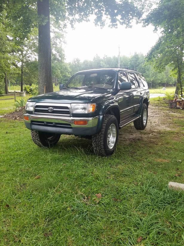

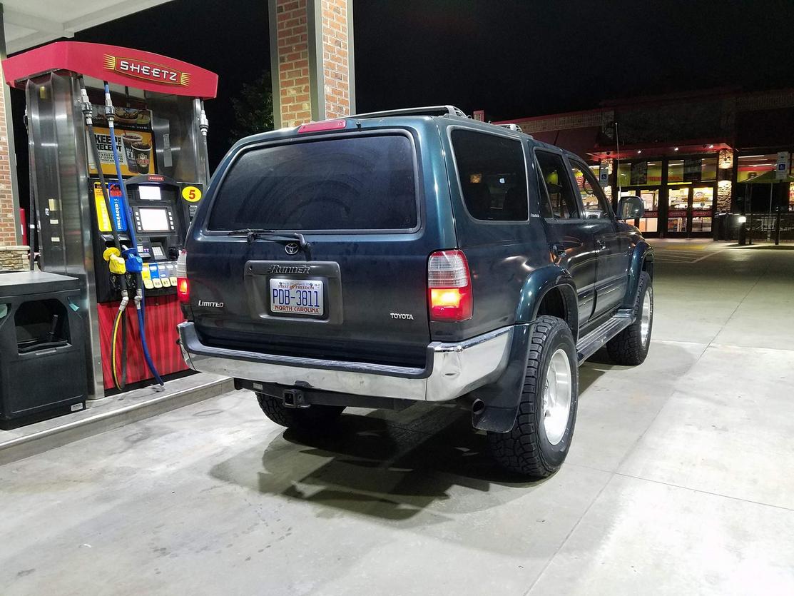

Before
After
Well not today but added two trim packers on each side of the rear to get rear of my reverse rake. Loved the end result.
This is how I ended up replacing my sunroof last week.
Hint: If you run the tube over a torch, you WILL loosen up what's inside, but you'll also make the tube easier to accidentally bend, may melt the plastic casing off the cable, may also burn your hand like I did.
I finally decided $150 from a local junk yard for a verified working unit was just fine to pay.
