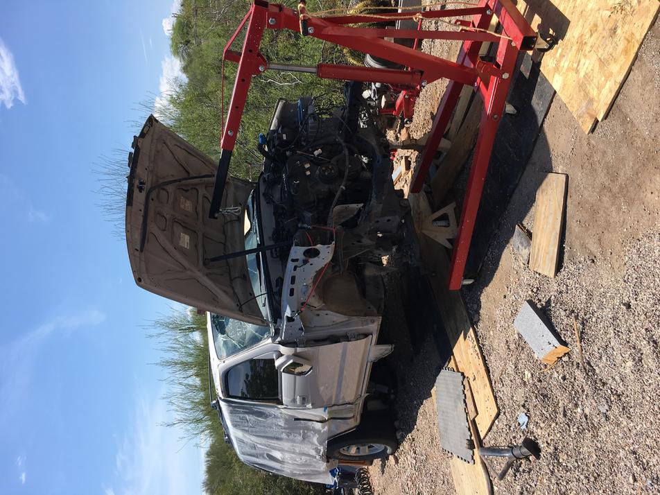

Pulled the engine and transmission/tc with my friends help we got it done. Tricky on sloped gravel. Used another 4Runner to help pull the engine hoist back from the chassis. So cool to see how the come apart.
I'm going to be getting rid of the rest of the truck. Is there any interest in the the frame and totally smashed body?97 az no rust frame !! And what would be a fair price to fellow members? I'll post it on the for sale thread and put up pictures, but I'm wondering if it's better to just scrap her? If y'all have prior experience let me know you're thoughts? Thanks

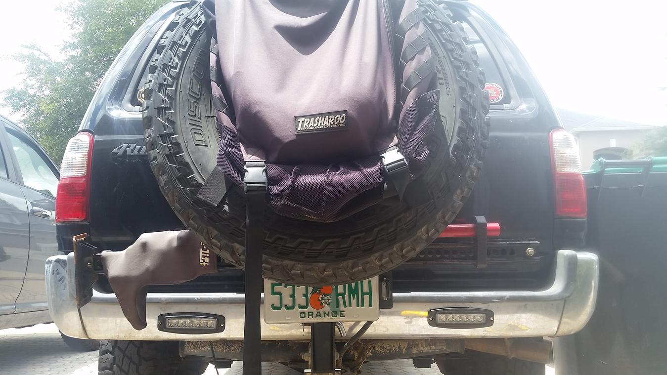

bit un-even, good thing i'm not ocd; mounted these reverse lights, wiring another day, storm rolling in.

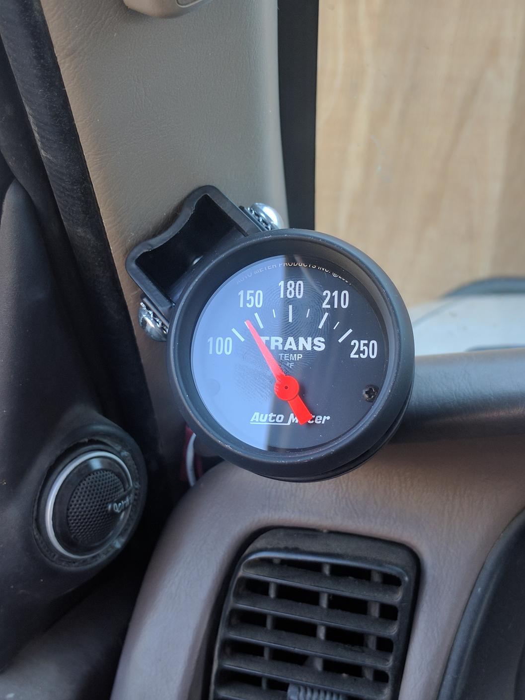

I also got the Auto Meter trans temp gauge and pillar mount wired up and in place. I was so glad to rip that Glow Shift POS out of there. Amazon even gave me a full refund. The Auto Meter is easy to read, the pillar mount is bomber and I can read it in the sun. For those of you not following along Glow Shift Gauges are crap, junk, POS. I'll repeat it again in case you don't get it. Glow Shift is garbage. Do not use. lol
With the trans cooler in series with my newish rad I'm seeing temps at 150 around town and 170 highway. I hit 180 pulling a long(7 miles) steep grade. It's worth the money and time to do this.
