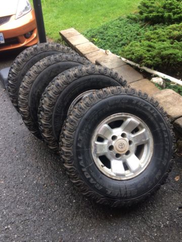

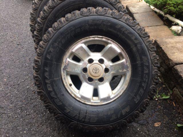

Haven't done it yet, but I'm picking up a used set of tires & wheels tonight.
I bought my rig with 285/75R16 Treadwright Retreads (BFG KM cores) on factory Limited 16" wheels and 1" All-Pro spacer/adapters. I absolutely love the stance and look, but honestly, it's a little "much" for the light duty I put my 4runner through.
So I came across these on Kijiji and am snagging them up for 600$.
They're ETS TrailMaster M/T Remolds in 265/75R16 on factory Limited 16" wheels. I'll be giving the wheels a quick wirewheel and paint to give them a face lift as well as getting them balanced. I'll try running them on my adapters at first, so if that works out I can at least keep a bit of that stance, but the main goal is/was to have the option of ditching the spacers, which I am not currently able to do with my tire/wheel combo. I also just want the 4runner to be a little bit more daily driver friendly, even though I'm sticking with an aggressive M/T.
Anywho, I'm stoked to get these home. And the best part is that I can still keep my 285's for trail days if need be.
