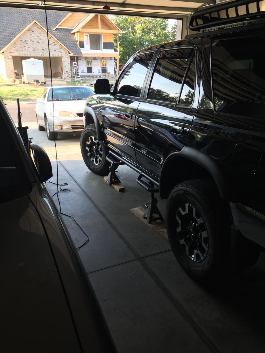

I bought a pair of nfab steps from a 5th gen owner today. If I can fab up some brackets, I think they're gonna look spot on!
