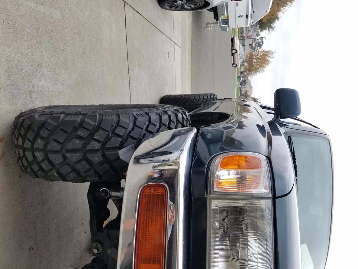

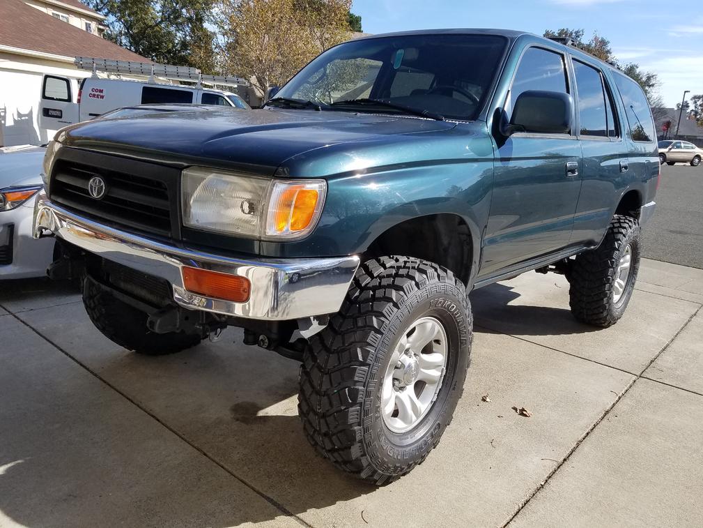

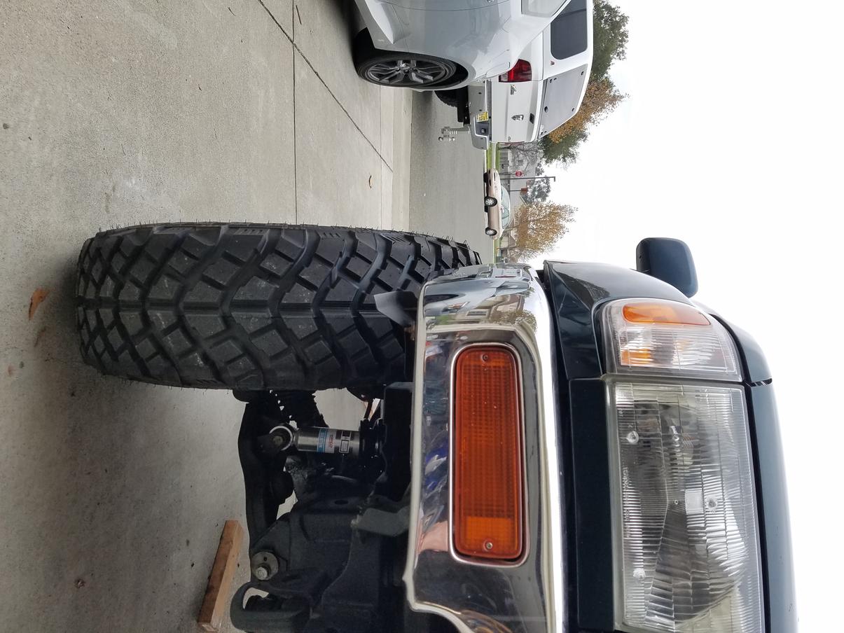

Installed some 1.25" spacers yesterday. The 285s rubbed hard on the UCAs. Sorry that everyone will have to turn their heads to see the stance :rofl:
