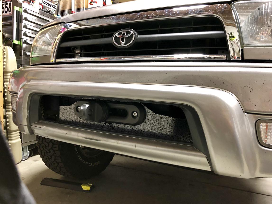

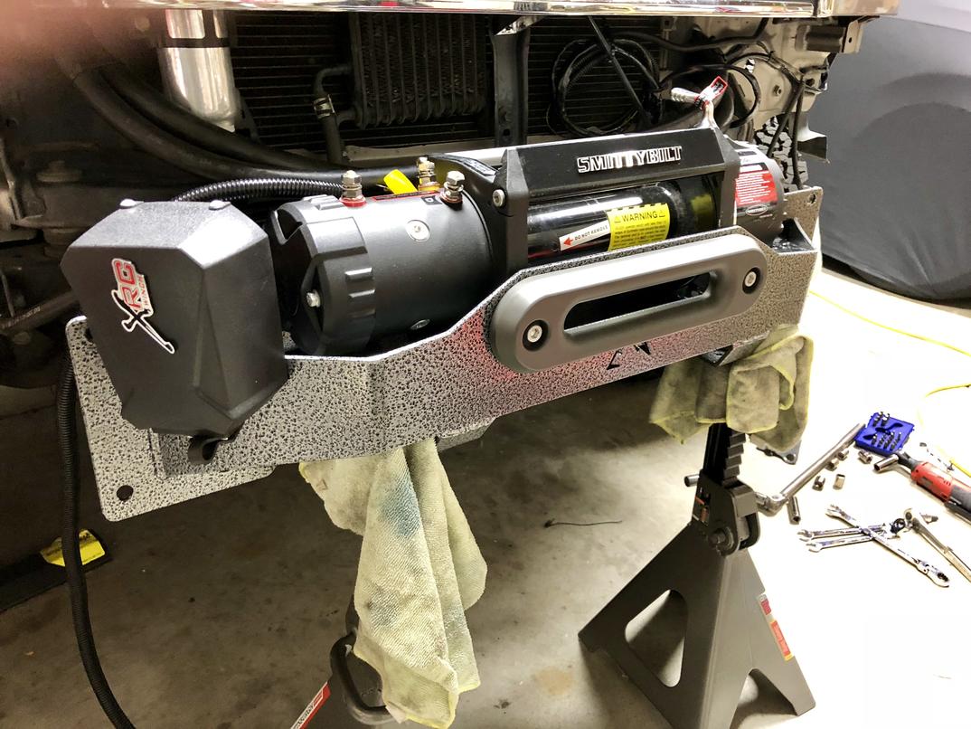

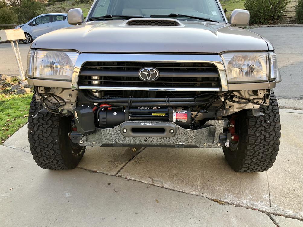

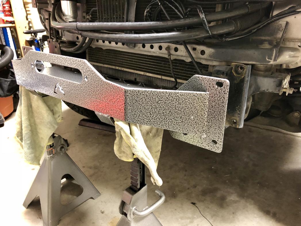

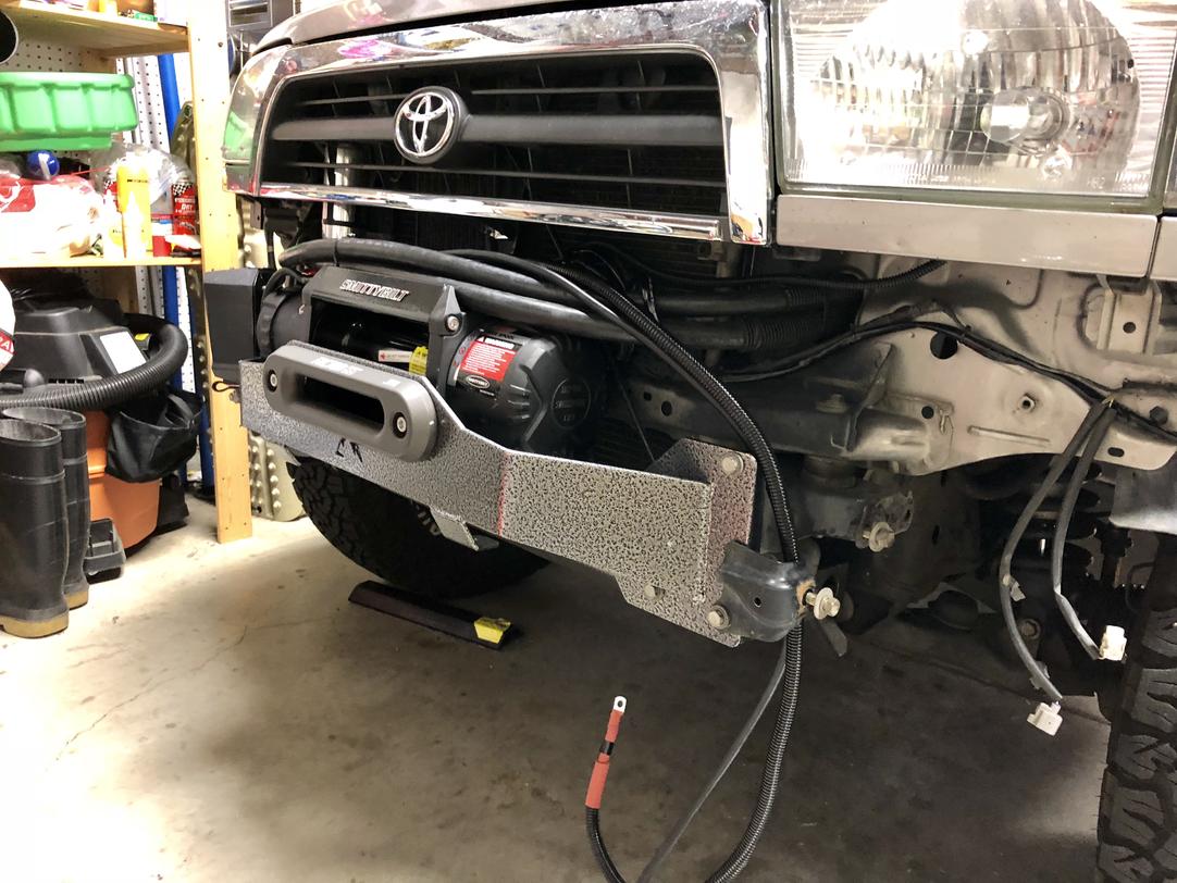

Finally got a chance to install my Treadstone Offroad stealth winch plate for the fat lip 3rd gens. Now I need to figure out a solution to remount the front license plate.

Looks good! Is there only 3 mounting bolts on each side?
Yeah its 3 bolts per side (14mm heads...not sure of the size. I believe grade 10.9). This one is the prototype to evaluate for full production. We have considered adding wrap around pieces to allow additional bolting into the sides of the frame rails but that would require drilling into the factory stuff. Also looking at including the two black additional brackets for bumper mounting as part of the plate itself.
I would definitely be interested pending price point
looks good, weight with winch ? Price ?
I'd hate to piss in your cornflakes, but there's no way those 3 bolts will hold up to heavy winching. The bolts aren't the major problem, it's where they're located and what they're connected to. That end plate is tack welded onto the frame. If you want to add strength, have it tie into the factory tow hook mounts

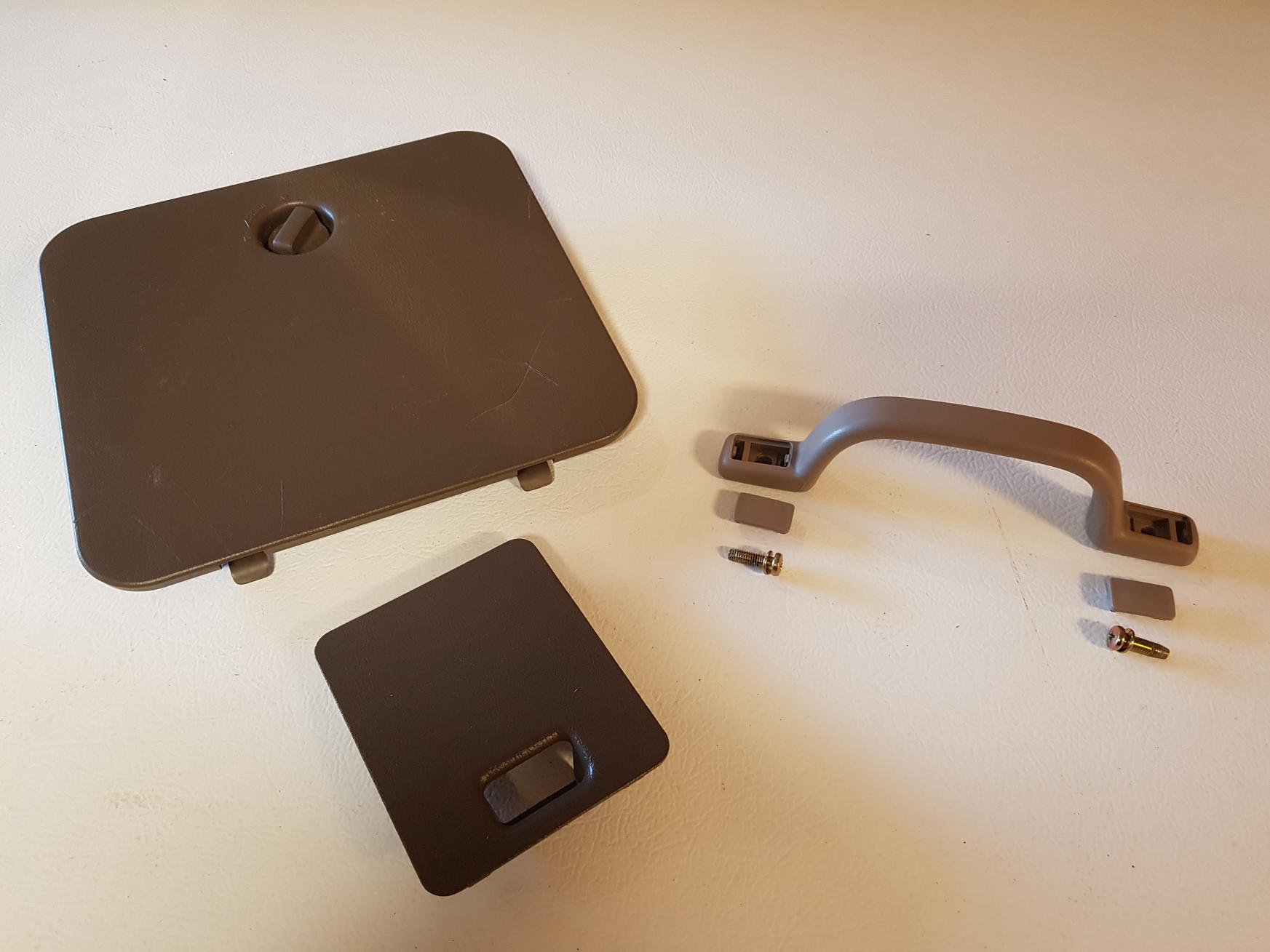

My OCD is getting the better of me again. Grabbed a couple of plastic interior pieces from a part out to replace the ones on my 97 limited that were bend or broken and also scored a grab handle for the drivers side.
Dude, are you kidding?
It took me 10 minutes with a hacksaw to cut those plates off the frame. :AK47:
I think we both know those plates won't hold the weight of the vehicle when PULLING as the crush bar (push force) mounts to them Lol
Personally, I'd like to have seen integration to the bottom AND side of the frame as well. That way there would be more bolting security, and load displacement. Which is why I went with the TrailGear bumper for my winch mount. That bastard aint going anywhere.
Which is why I went with ARB for my winch mount :bigok:
I dig it and that’s exactly where I wanted to put mine. I think more bolt holes and brackets would be ideal though.
