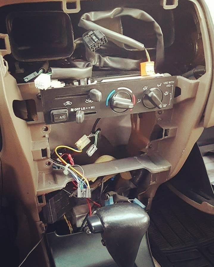

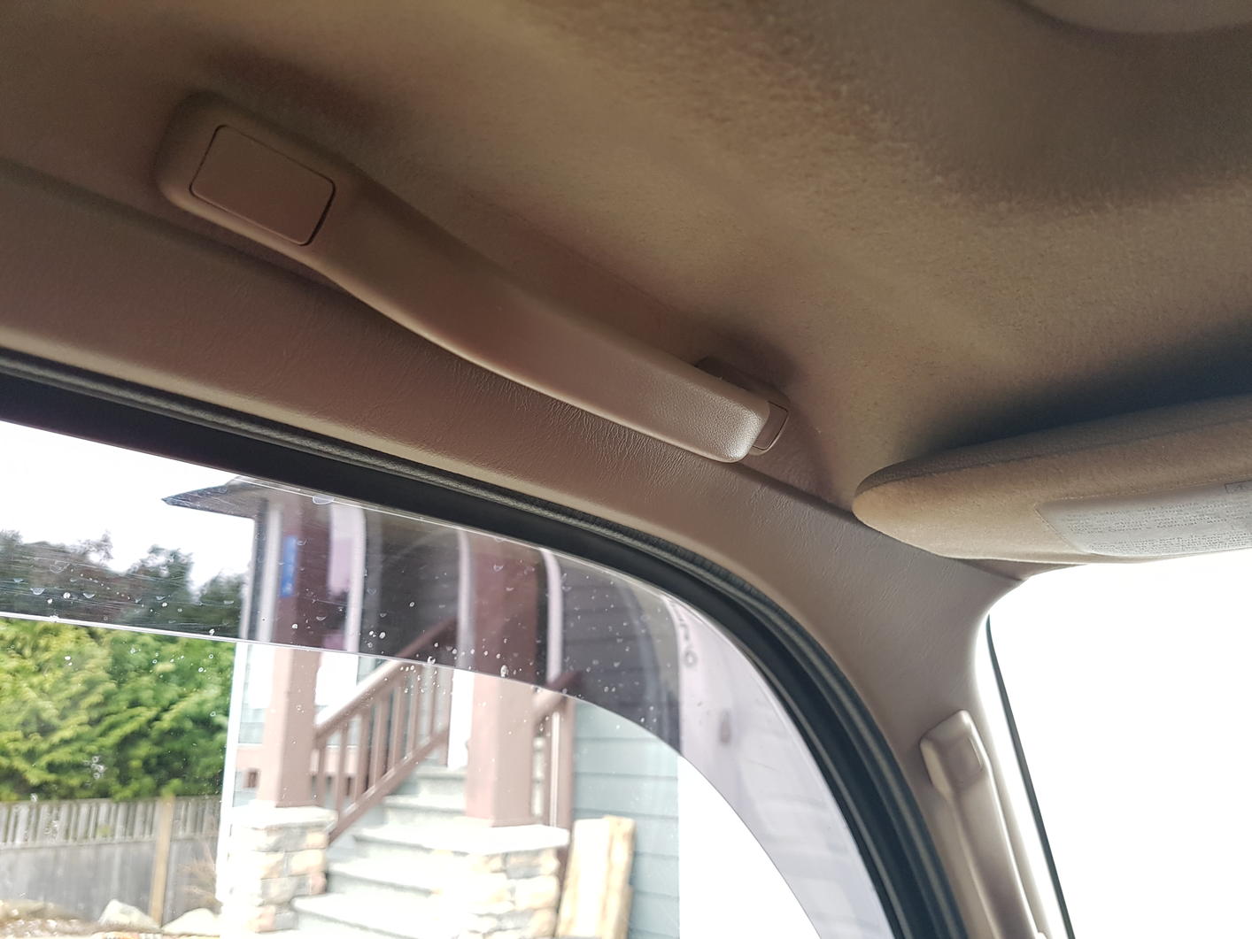

Installed a grab handle on thw driver's side and washed the 97. Then dug into the dash on the Mrs' 00 to fix the clock and get the stereo working.

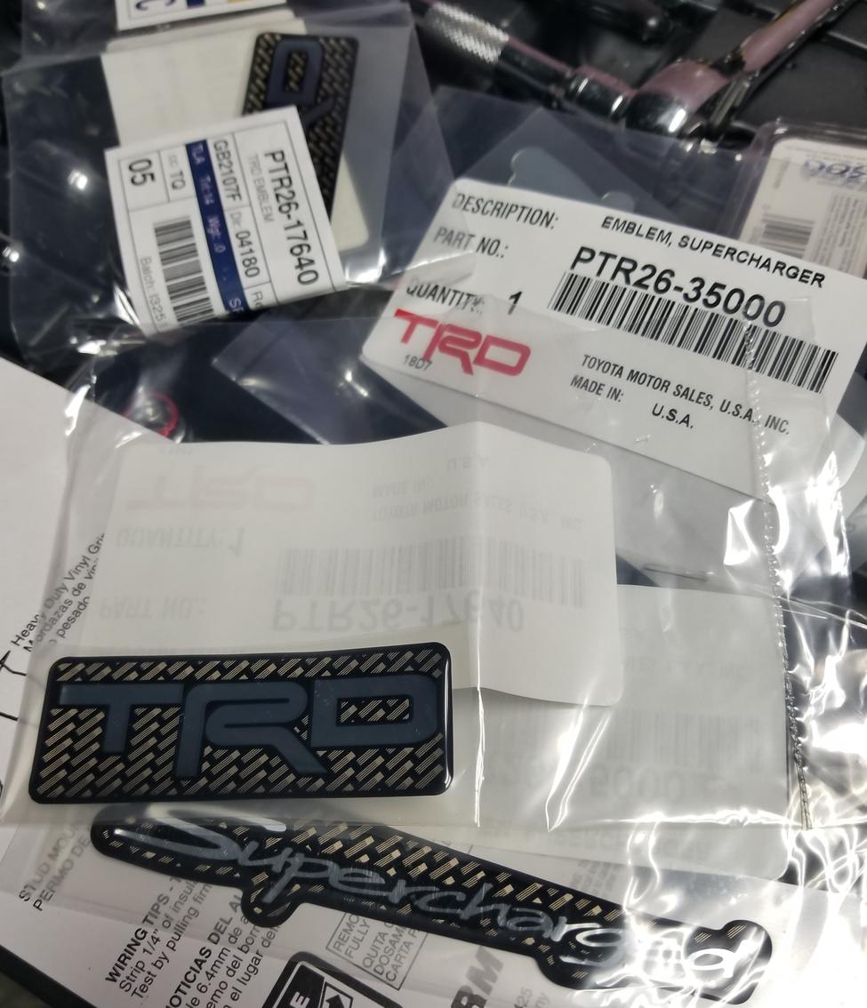

These need a home on my truck. Thinking about replacing the limited emblems on the side with these, Anyone have these or know where they are usually placed?

Hey, I wanted to install a grab handle on my 00 2WD limited as well! How did it go? which type did you use? I think there are different bases for some grab handles on toyota vehicles. Help appreciated!
Get the same handle as exists on the passenger side from a junkyard, the screw bosses are already there under the headliner. Tall guys beware this mod becomes an obstacle for the grape on the daily.

I just got a rear drivers side grab handle from another 97 that was being parted out locally. As previously mentioned the screw bosses and under the headliner. Just made two small cuts with and exacto knife and then screwed them in. Im 6'1" and dont hit my head getting in but i can see that happening if youre any taller.

I got mine at Toyota parts deals. came in the OEM TRD packaging. I just googled the part # and found them
I don't know why I thought you meant the EO stickers for the supercharger. Im looking for a set for when I install the supercharger and have to get the Runner smogged, but I will be getting those emblems when I do install the SC.
