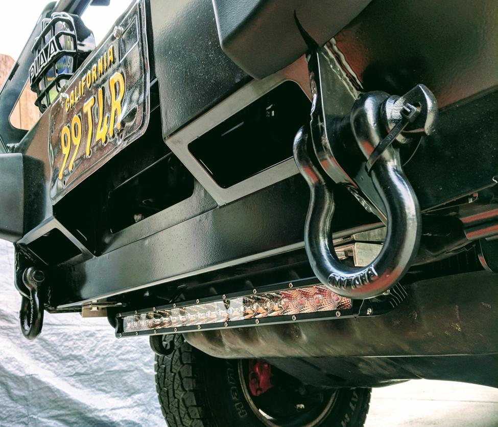

Installed this light bar under the bumper which can easily be uninstalled by removing 2 x 13mm bolts before hitting the trails

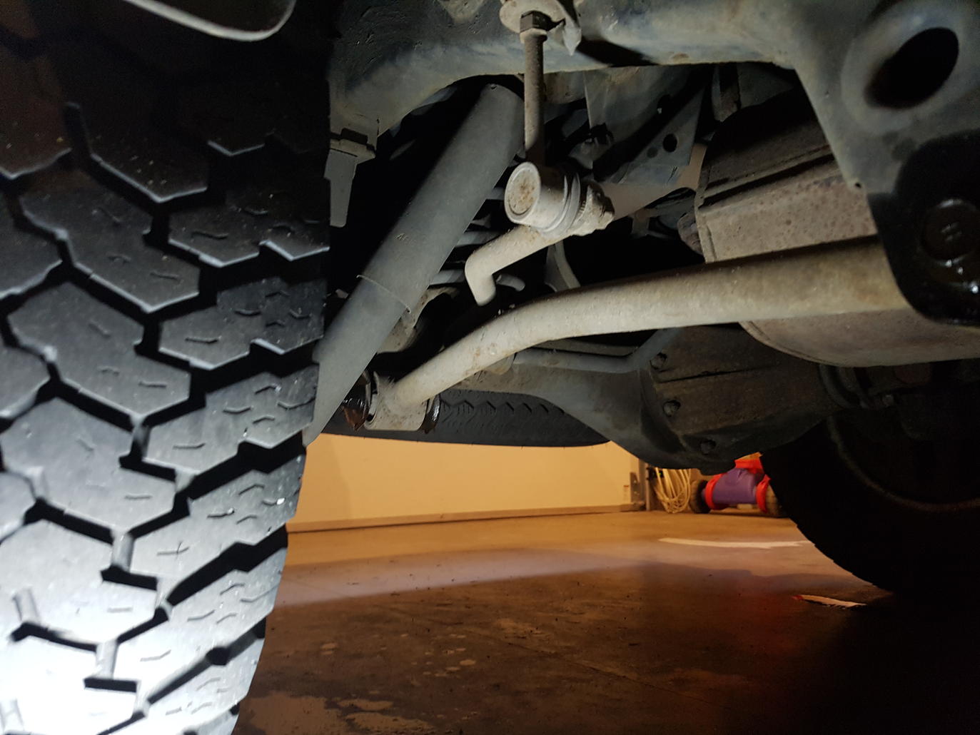

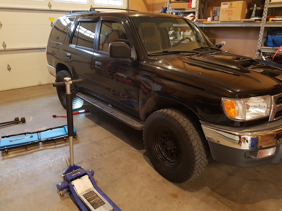

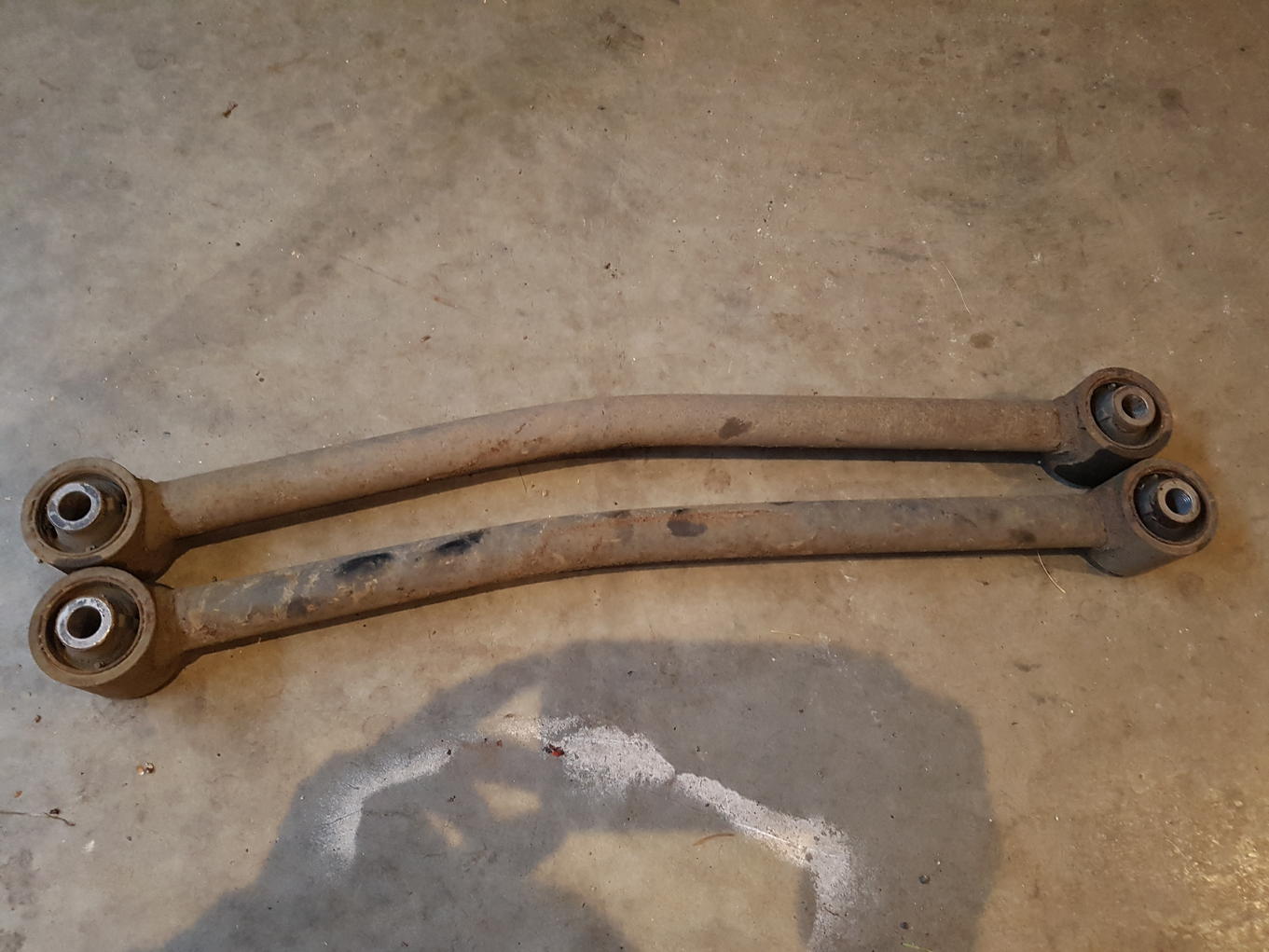

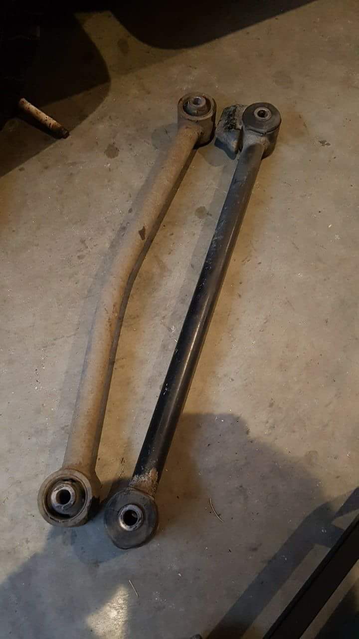

More work on the wifes 00 4runner. Replaced her bent rear lower control arms with a pair of straight ones from my 97. Also took the front wheels off to check the brake pads and rotors. Also checked the lbjs and found no play whatsoever.

Replacing those rear lowers I'd suggest being extra extra sure it is tightened down properly, perhaps even with locktight. When they come off it can be catastrophic. Most folks (like me) are running factory still after all these years. Never removed and little chance they'll come loose. But I have seen here on T4R the aftermath of one coming loose and it basically totalled the whole rear suspension.
