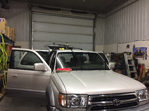

Well... I gave her a reeeeeal good bath. Then I took her in to the shop to thaw out (it's -25C here today and not expected to warm up until next year). Then I was wrapping some presents, and saw a new bottle of Chemical Guys wax. So I also gave the truck a quick wax by hand.
Then I noticed how bad my roof rack looks. Pulled the little crossbars off and gave them a quick hit of flat black paint as they were weathered.
