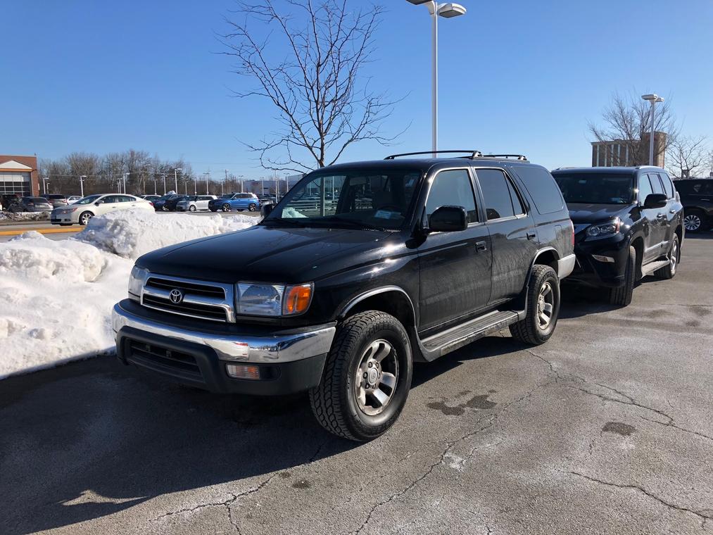

I am blessed to say the least, I have really great friends with an amazing German shop who let me work on my Japanese truck.
Traded it in with 65k miles. Idea of doing timing belt, spark plugs, lower ball joints, struts all around, replacing rusting running boards and rear bumper pieces was just too much for me. Catalytic coverter also had a pinhole or two in it. Frame was very solid, but still more rust than I'd like.
Dealer got a killer trade in deal though, only gave me $2750. If I had more time, I would have sold it privately, but it is what it is. Cosmetically, the car looked great. Going to regret it, but hopefully the person who picks it up can give it the attention it needs. Has been in the family since being bought off the showroom floor in 2000, itll be missed
