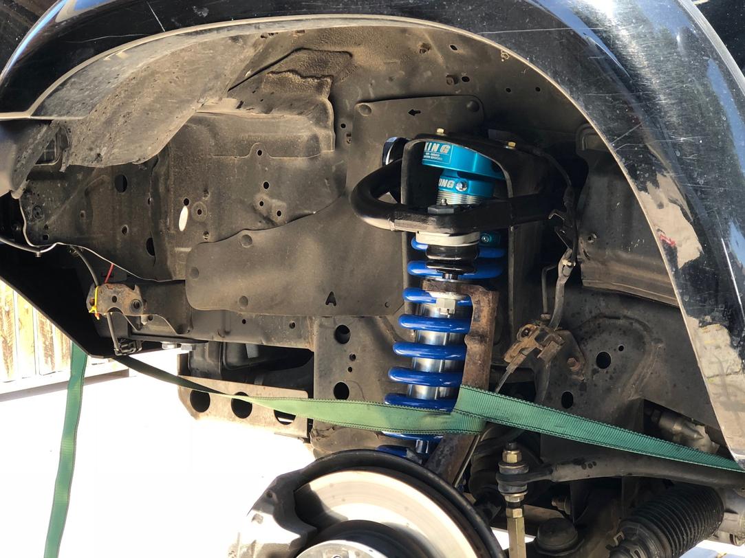

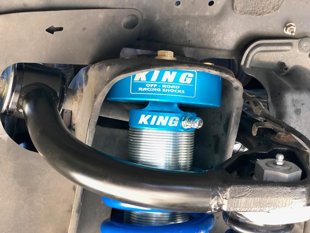

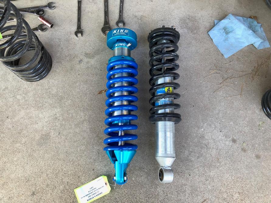

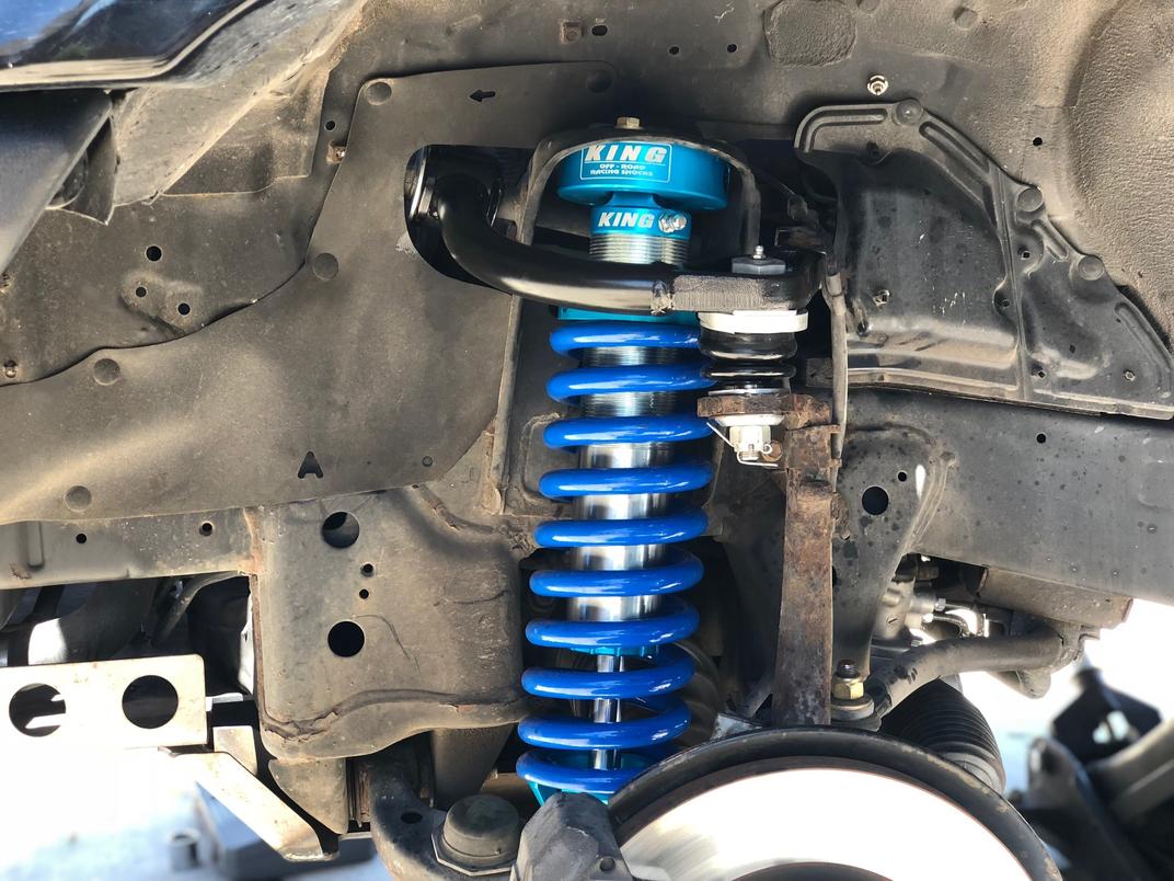

Removed 6112's and installed:
Kings
650lb coils
Ext travel
SPC UCA
Upper ball joints suck

Are those the King 25001-151?
They are, got em from DSM right before the price increase. Really good experience, I would recommend them to anyone looking for Kings/Fox, whatever else they sell. Good dudes.
What position did you install the SPC caster cam in, D (2°) or other?
Installed at setting D. After alignment, caster was right at 2.1*. It helped alleviate the rubbing I was getting in the rear of the wheel well.
They are, got em from DSM right before the price increase. Really good experience, I would recommend them to anyone looking for Kings/Fox, whatever else they sell. Good dudes....
Looks like the bump is about 200 bucks too, up to about $1,200 for a pair (fronts). I have not seen the price increase just yet though, at least with one vendor in the GB section. With the Memorial Day discount in effect, cart price is 950 bucks. More than I was planning to spend, but for those who want King, looks like now is the time...
Great info, my 265/70-17s rub at the rear too - can't wait to install these UCAs!
How did you handle the UBJs?

Mine were a pain in the ass. The cotter pin was pushed in too far by whoever serviced them prior and they were rusted in. I ended up removing the long bolt that holds the arm to the frame, spun it around and hit it with a cutting disk to cut that actual ball joint out. From there I rented the ball joint press kit from O'Reiley's and pressed em out. I will say that tool is a knuckle buster and soaking the ball joint with WD helped a bit.

How did the pressing of the SPC adapter on go?
Aside from cotter pin issues, would you say this is a solo, on-vehicle job or would pulling the spindle completely make it easier?

The SPC adapter was a tight fit, I sanded the inside of the spindle with some 800 to clean it up and just beat it in with a sledge, seemed to work fine.
I did it solo, I will say this would have been a lot easier if there was a helping hand, mostly because holding a grinder with one hand while holding up an UCA with the other is pretty sketchy.
I did everything on the truck, you should be fine. I don't think the extra work of removing the whole spindle would be worth the hassle. I just used a ratchet strap to hold the spindle up so the CV and lower ball joint didn't get destroyed.
