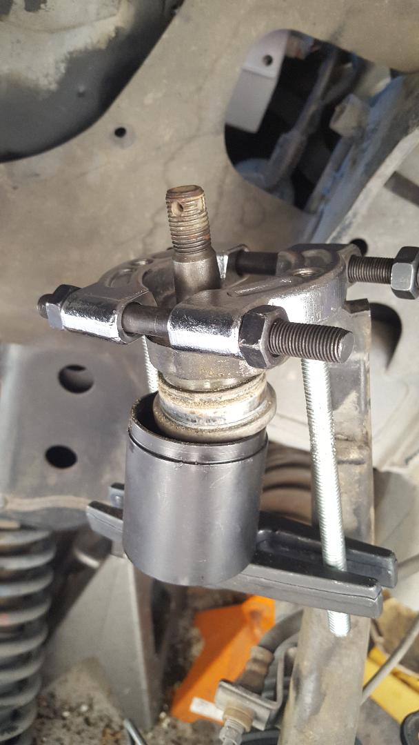

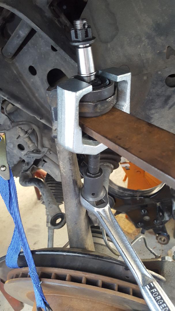

I was debating pulling mine to get the UBJ but came up with the bearing splitter pulling down and a sleeve over the UBJ up against the bottom of the arm. I have the big C clamp press but the stupid big ass thing won't fit in the wheel well. To press the new ones in I came up with this other deal. I had to cut a ~1/2" piece off of a sleeve to use on top. Not pretty but it works. Hardest part was getting the new UBJ to go in straight.
I like the pitman arm puller press :D I already own one of those
As far as driving the UBJ out, I think a BJ press/4WD press kit from AutoZone should cover the removal, but I will expect to have to sweat it some
