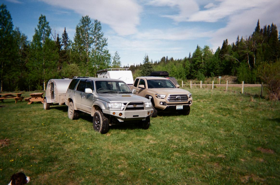

Not today, but recently...
Shrockworks rear, 4xInnovation front, bedline all around. OME and Bilsteins, and FJ TRD wheels
Here is a shot next to my bros Taco during a recent camping trip

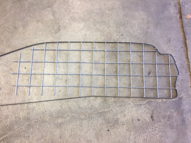

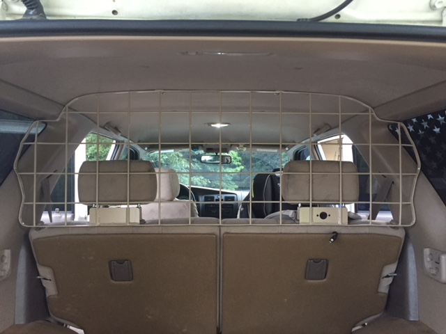

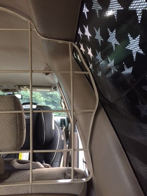

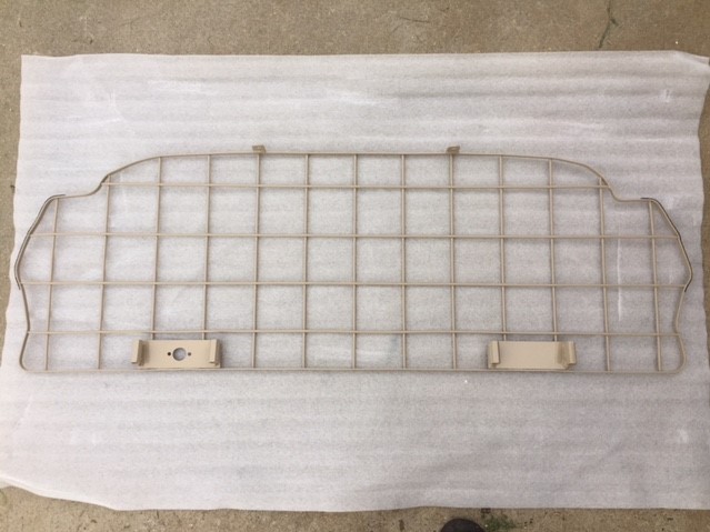

Installed a divider that I built between the rear seats and cargo area. It's made with 4"x4" opening goat fencing panel, wrapped with 1/2" x 1/8" flat bar. The flat bar was drilled and countersunk for the fence to stick through, then tacked on the back side and ground flat. Brackets made to attach to the headrests out of 1/8" sheet and 7/16" coupling nuts, drilled out to 1/2". 2, 1/8" tabs at the top bolt it to the ceiling where the headliner clips use to be. Ceiling was drilled and M8x1.25 rivet nuts were installed (there's a dual layer so it didn't drill through the roof). Had it powder coated to match the interior when it was finished.
