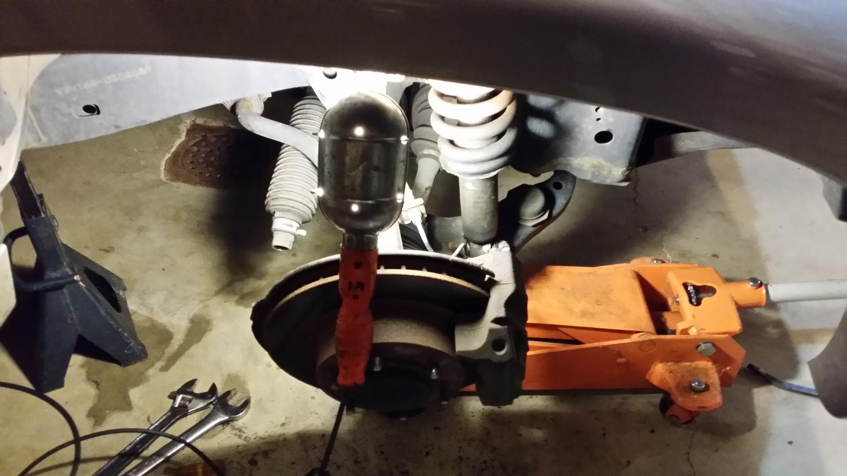

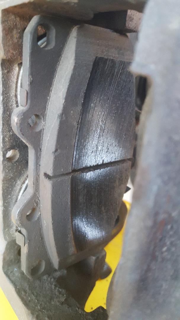

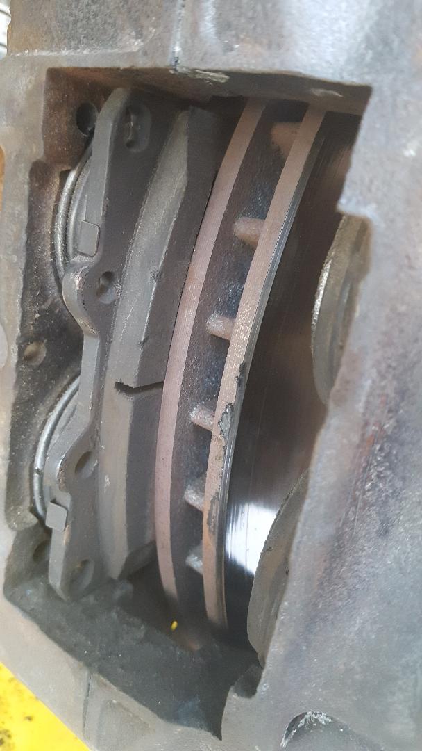

Was changing the pads & rotors and found this;
Did they put on a smaller size rotor or is that normal ?
Both sides are like that.

[MENTION=211420]Wedgy[/MENTION] That's freaky. What's the casting on your brake calipers?
I'm glad you're okay! That's the important part, although you've got a really nice rig. If it kept you alive (and unscathed), it did it's job.
Yea no injuries and no accident report. So I just gotta fix my bent up rig. Eh, broken parts are one of my favorite excuses for upgrading stuff.
Hoping it’s just a swap out deal, not bent frame level stuff. If thats the case I’ll find a manual to swap all my stuff into. Or maaaaybe a taco?
Sent from my iPhone, so probably some stupid typos and autocorrects
Sorry, but what is the Casting you are talking about ?
They just look way undersized. I measured the rotors and ordered a new set of rotors & pads and the found this.....
Wrong size rotor or even pad. How has your braking been? Stick the left foot out the door sometimes?
Braking is a bit spongy and pulls to the left under hard braking, even after bleeding so I sprayed the rotors with brake cleaner in case there was oil or something but no change so I ordered new pads and rotors. Wear on both sides is even. I measured the rotor as there are 2 sizes 297 and 319mm and mine were 297 so That's what I ordered....I guess they were supposed to be 319mm. It appears there is plenty of room to fit the bigger rotor and the pads are for the bigger rotor:wtf:
What size rims do you have?
If it was me I would go to the local chain auto parts store and buy one of the bigger rotors and just install it to see if the rotor size is my problem to start with. Return it if it isn't.
I wouldn't drive a mile away from my house with such little pad contact.

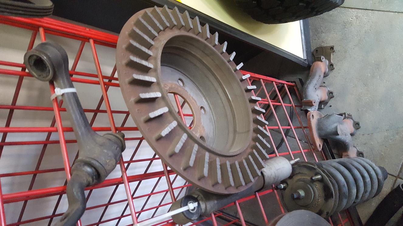

This rotor isn't mine but I think it's in the same category of stupidity
