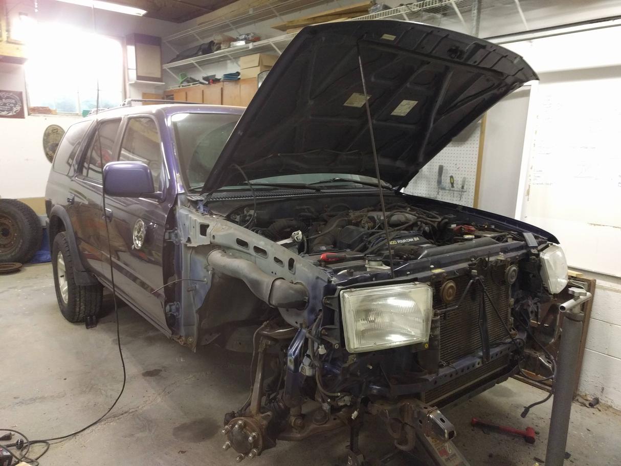

Finally got around to the oil change now the valve cover gasket is done and looks good.
5.5 qts (actually more like 6 after the filter had sucked it up) of Pennzoil High Mileage 5W30 and OEM filter.
Also passenger side spark plugs, need to find time to do driver side...lol
That picture make me cringe seeing that magnetic tool tray stuck to the passenger door panel. I can feel all the scratches its putting into your paint.
:cry2::cry2::cry2:
:cry2::cry2::cry2:
If it's the Hong Kong Freight one like I have the magnet is very rubbery like it's made of some non-skid stuff....and I don't think he's too worried about the paint anyways.

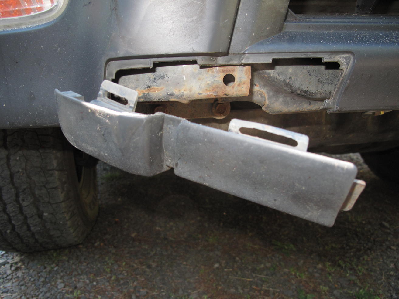

Cannot find what this goofy part does for the front bumper.
Anyone gotta clue out there ??
