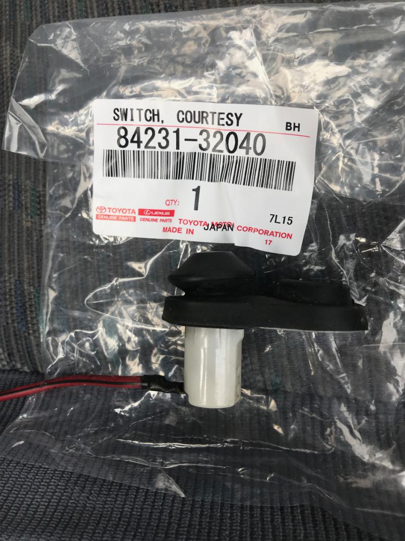

Replaced all the door switches as the originals were getting to be a little intermittent. Can't really complain though, after 23 years of service!

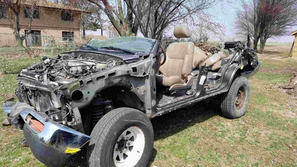

Went to check out an E locker for sale and when I got there I find this. IT STILL DRIVES of course haha. The guy was really cool and let me drive it around to test the locker and it works, but the panhard bar, upper control arms and who knows what else are bent up from a rear collision and I wasn't sure what I would be getting in to with tweaked arm mounts or whatever so decided to pass. Plus the axle was more rusty than I hoped and I'd rather do a full swap with one that's cleaner that mine.

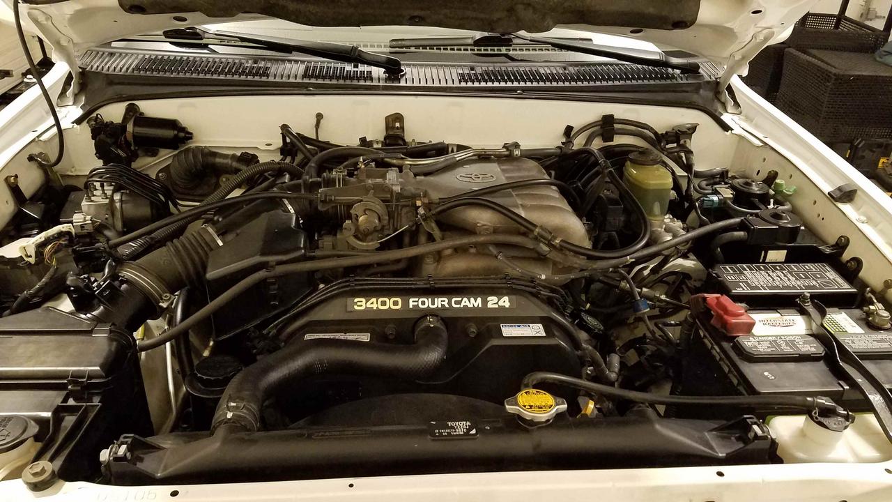

This is more 'what I did this week':
Front pump seal, rear main seal, new flexplate (done by Toyo Techs in Omaha, great place).

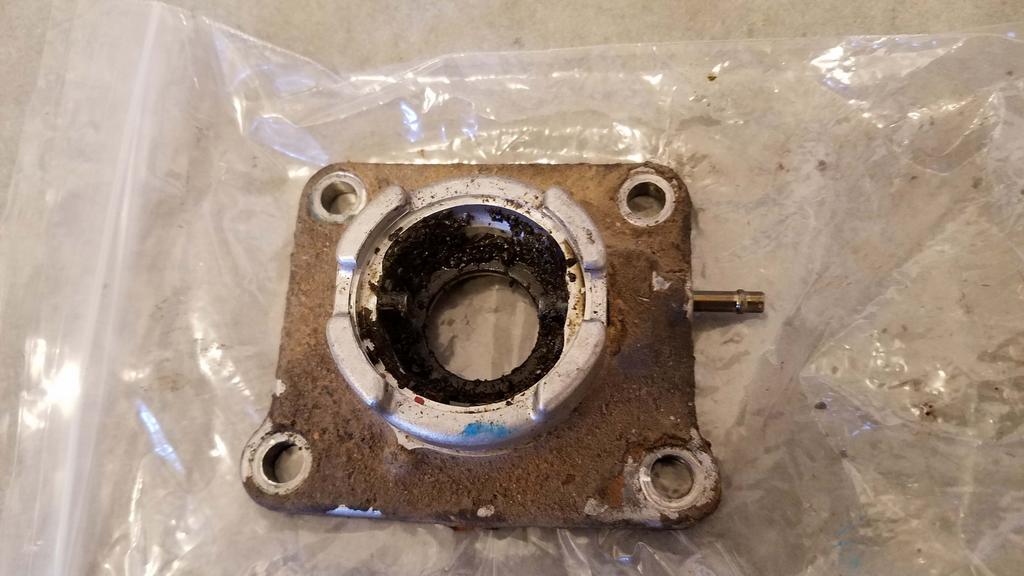

New transfer case shifter bushing. Old one had disintegrated.
Brake fluid flush (Prestone DOT4).
Radiator drain and fill (Valvoline Zerex Toyota).
Oil and filter change (Mobil1 and Toyota filter).
Front differential fluid (Lucas 75w-90).
Transfer case fluid (Lucas 75W-90).
Rear differential fluid (Walmart 80W-90 conventional).
Cleaned out the air filter.

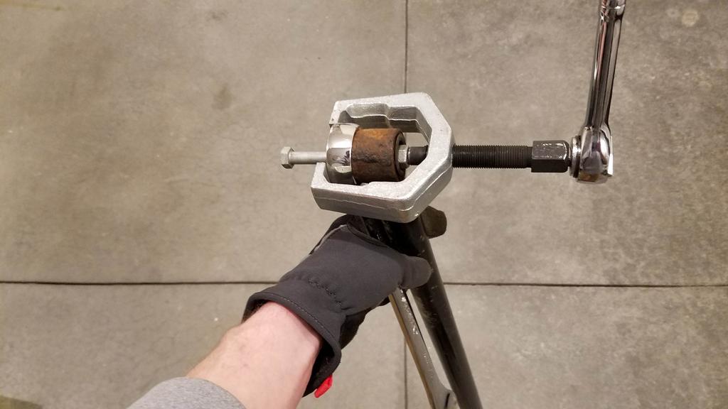

Panhard poly bushings (Strongflex from Sonoran Steel). Not sure if I greased the right areas, I greased the inside of the poly bushing where it has the textures surface, and the face where the poly contacts the axle/frame mount? It doesn't squeak anyway. I used my ball joint separator and a 30mm box wrench to push out the old bushings.

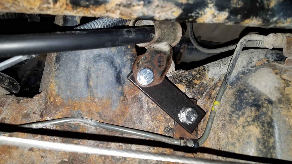

Parking brake relocation from Sonoran Steel.

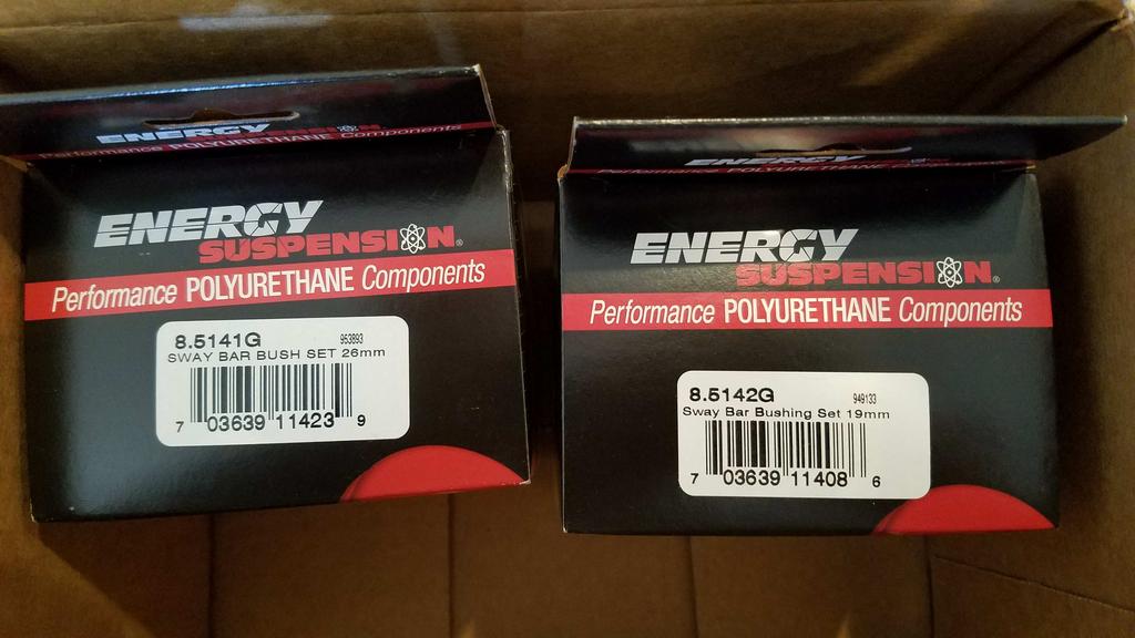

Front and rear swaybar and endlink bushings (Energy suspension). These fit great. I remember last time I did it a few years ago the front endlink bushings where too big and the rear swaybar didn't fit the Toyota bracket. But these kits fit perfect now.
Gave it a wash and cleaned up the engine compartment and cleaned the battery terminals.
