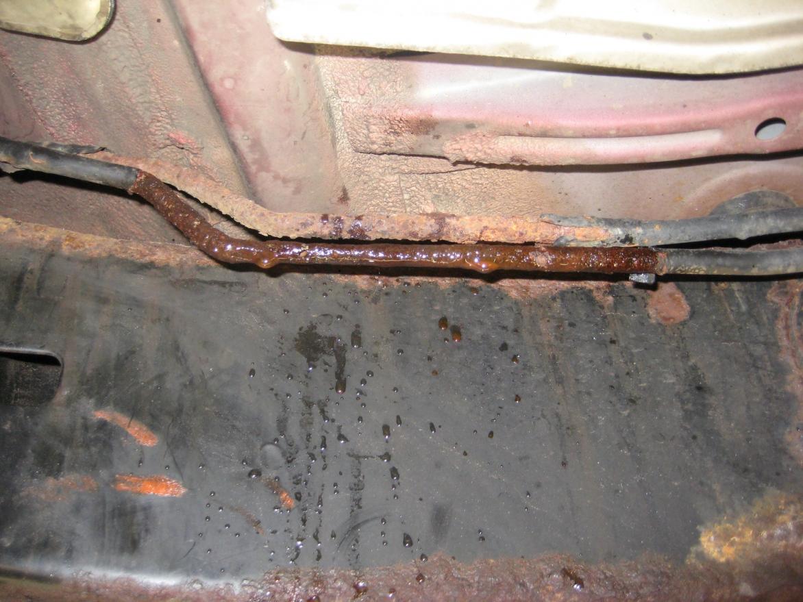

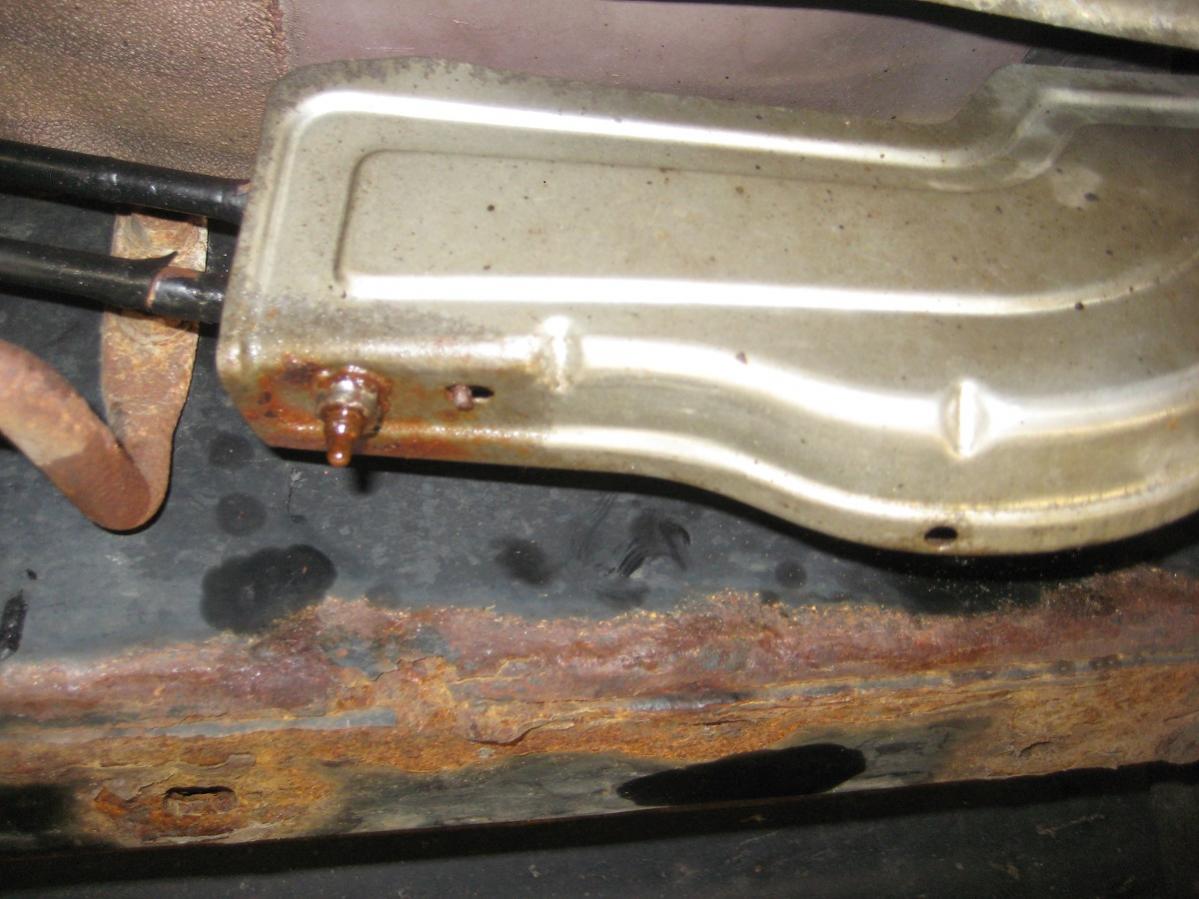

I'm trying to replace the cat converter on my 00 4runner SR5. I'm having 2 problems, I can't get the nut off where the front exhaust pipe connects towards the engine the one nut (or is it a bolt) on the extreme outside(passenger side). The second thing is as I was doing some banging the pipe along the frame rail split in two and liquid sprayed out. What is that pipe( there are 2 there)? The cover plate is shown in the second picture and it transition from a a hard line to flexible tubing with a hose clamp.
DO NOT DRIVE YOUR TRUCK or you will overheat your engine. Those are the coolant lines to the rear seat heaters and they rust out and drain all your coolant. You will need to follow them to the engine bay near to where they branch off and snip them where it is clean metal. Then seal up the cut ends so you can run the cooling system. I welded them shut but maybe there is dome rubber fitting you can use.
Thanks so much !!! I don't need the rear seat heater so I'll just block it off. Thanks again.
I think you can get to them by the heater control valve in the engine compartment and just run a loop from one to the other to eliminate the back heater. One line goes in ( to back) and one comes out ( to front) .
Or replace the rusted metal lines with rubber, seen that done.
For me , the rear heater is nice to have, and if you bypass it now, the lines and the heater will drain, and if you ever go back to try to reuse, the core will be dried out and possibly no good.
