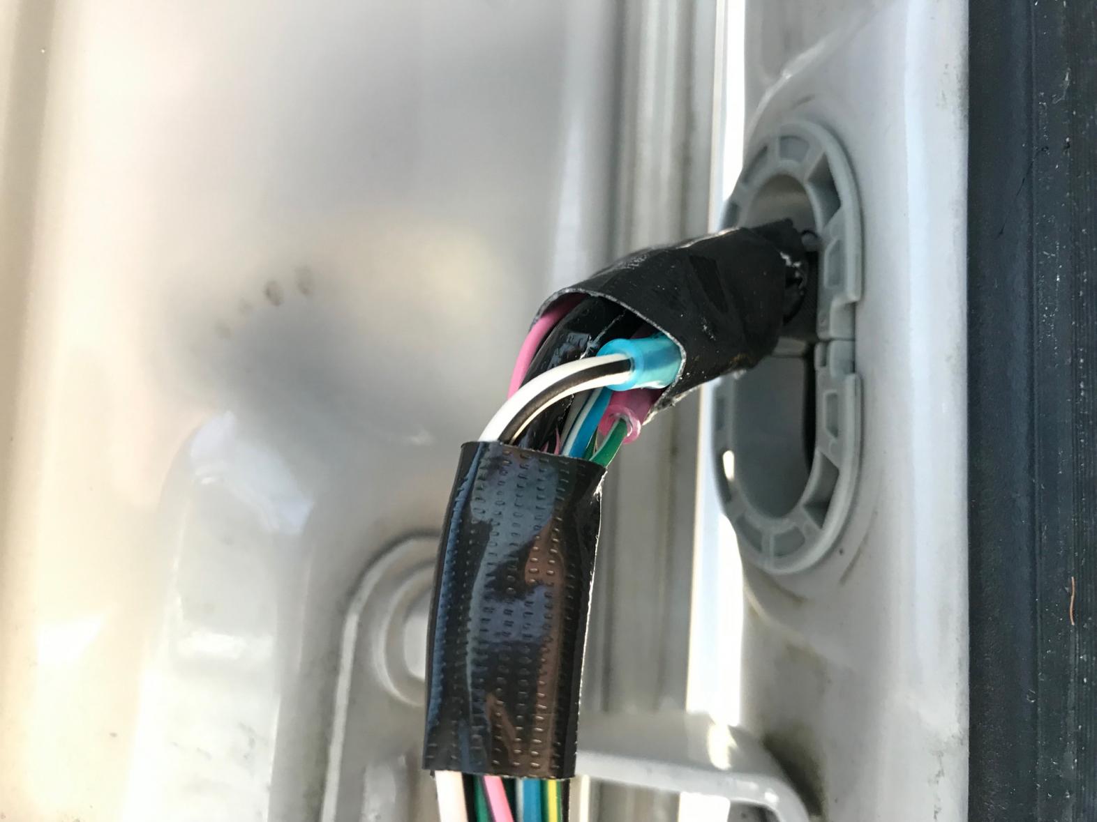

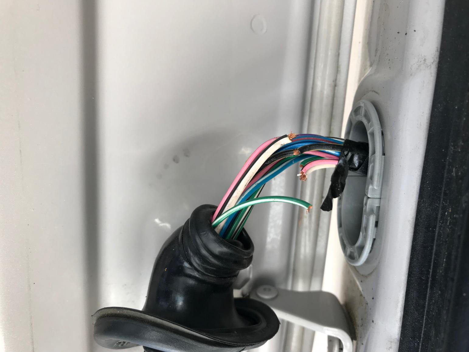

I finally figured out where my electrical problem was originating.
I had intermittent rear window, A/T gear selector, brake light and 10 amp STOP fuse issues. Turns out the wiring harness from body to rear door had worn through 4 wires. Spliced, reinforced and replaced brake light bulbs, all 3, 10 amp fuse and replaced gear selector over ride button cover.
Everything works great agin.
That has been bugging me for 3 weeks.
I used this forum a lot to help find the problem. I was on my way to look at the trailer wire harness but decided to pull the boot back on the door harness and there it was.
Thanks for the help and I hope this helps someone else locate the source of the problem.

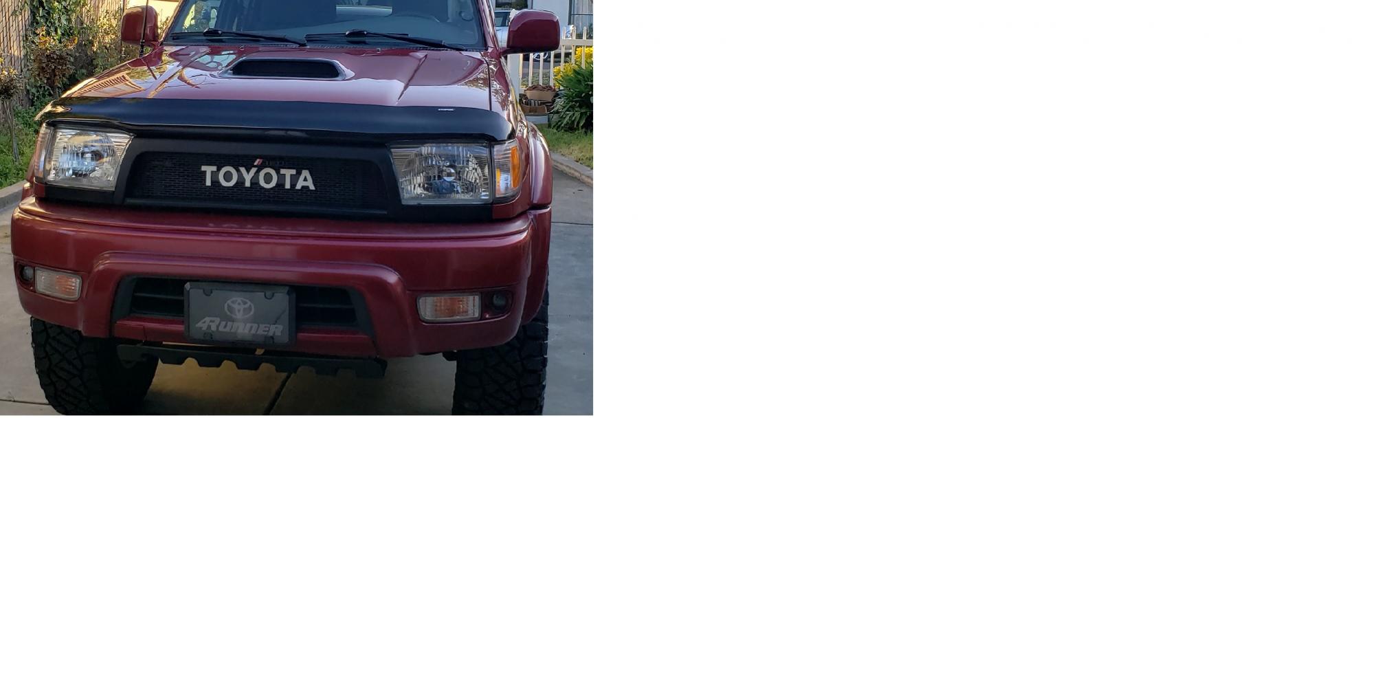

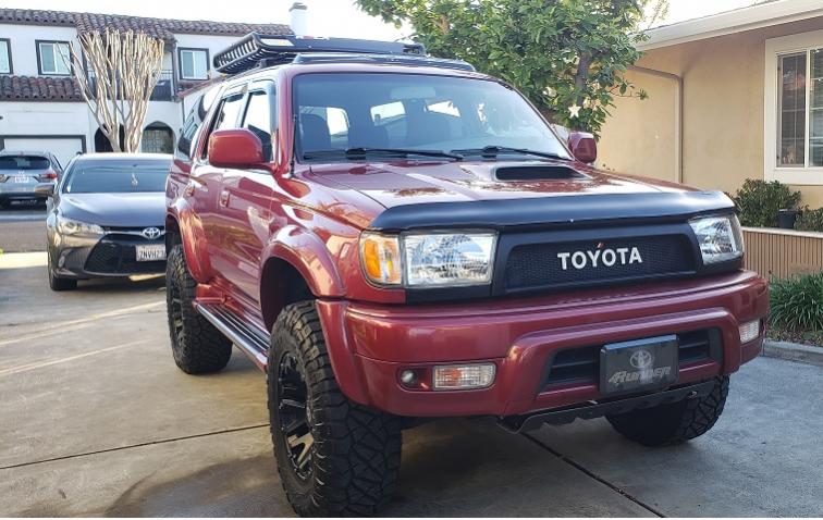

Installed the Satoshi Grill Mod that I've been working on for 3 days
I've been wanting to do this mod for a while and finally did it. Bought a 96 grill from PartsGeek.com and the prefab grill with Toyota logo from CustomCarGrills.
Cutting the grill and applying bondo then smoothing it out is the most laborious part of the whole process. I went the lazy route in painting and just used black Plasti Dip. Happy with the result but man, I should have just bought one from SRQ fabrications especially they have the group buy offer that closed about a week ago.

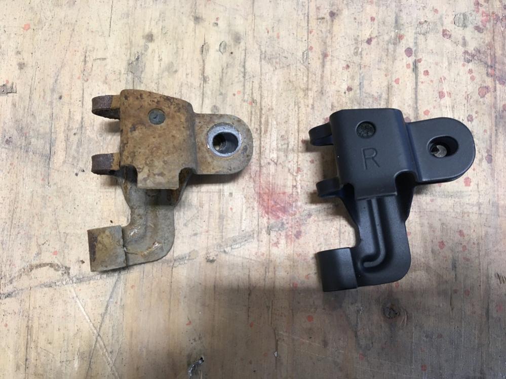

Replaced all the various front ABS line brackets. Mine were all pretty rusty. New one is Arizona junkyard fresh with a quick shot of black spray paint.
You guys who live in the sunshine states sure are lucky.

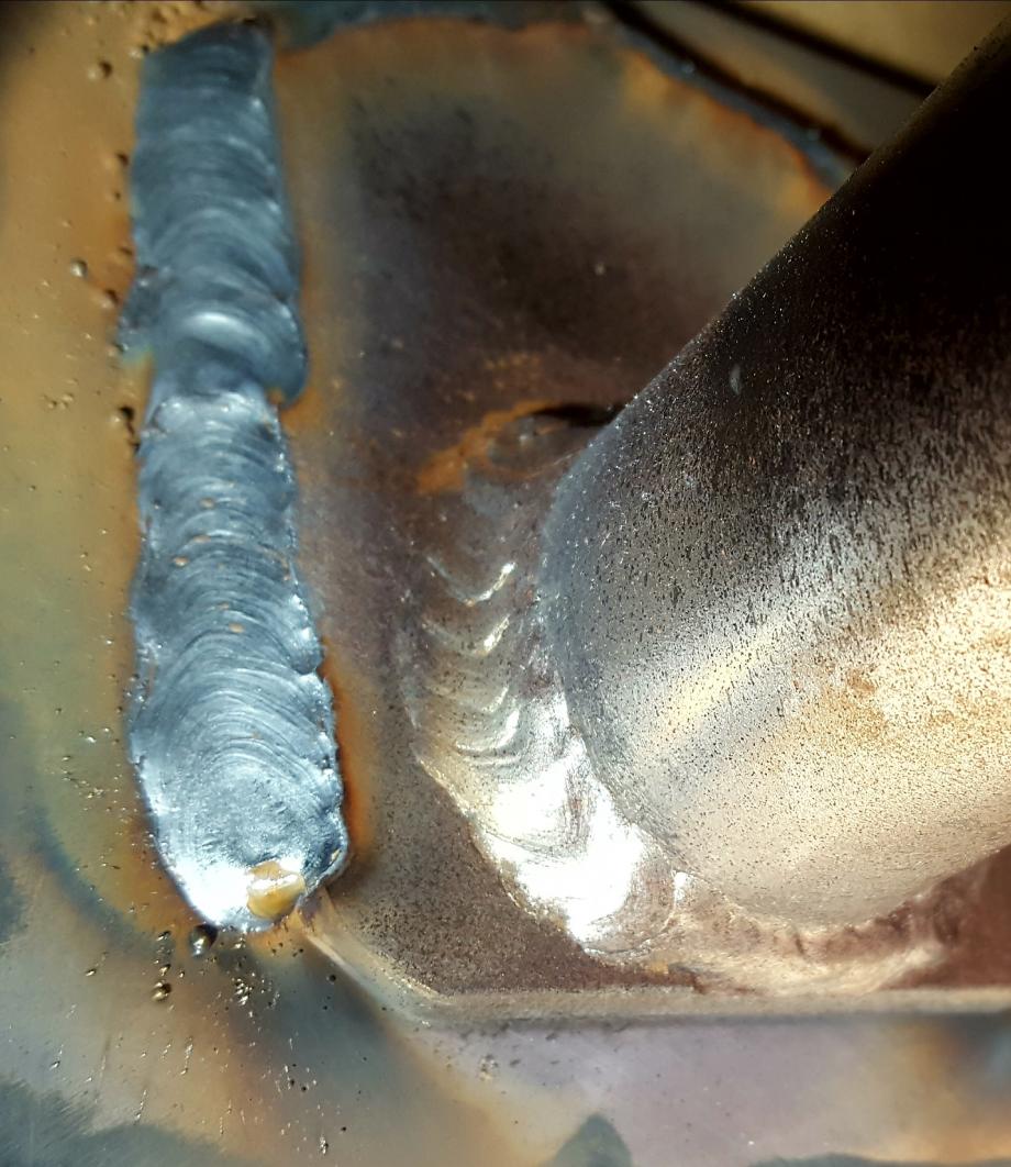

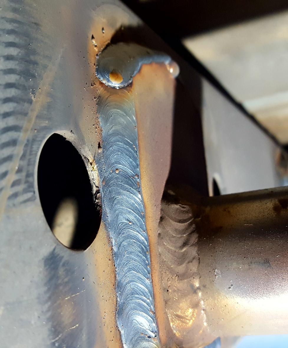

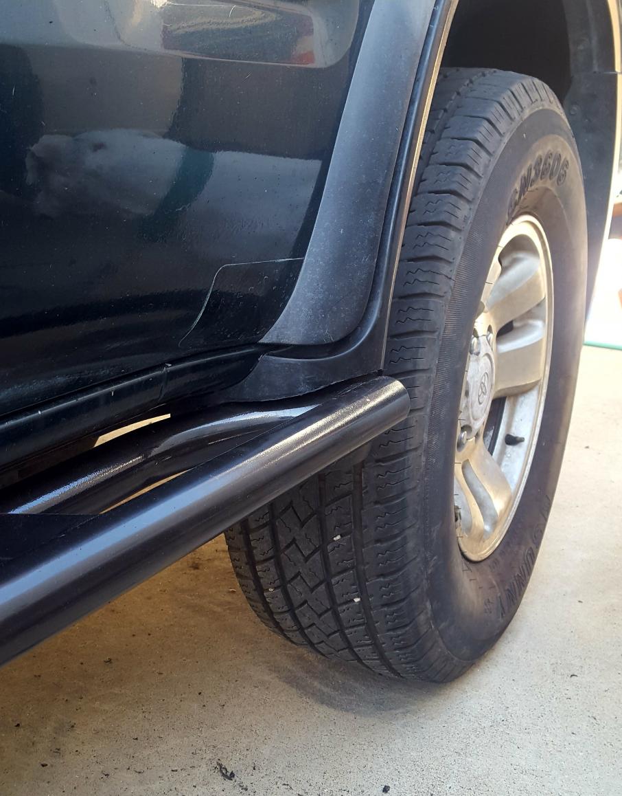

Welded the Stubbs HD-SKO's on and integrated them into one of the rear flairs. Have to do the other rear flair and I'm still waiting for the front flair cap that covers the running board gap. I'm surprised the welds came out OK looking in spite of all the clearance/angle issues getting in there.
