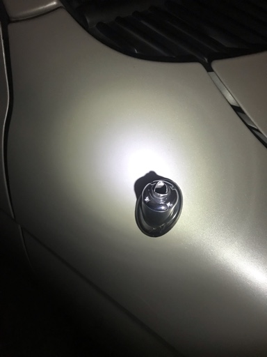

<a data-flickr-embed="true" href="https://www.flickr.com/photos/155058591@N05/48964234627/" title="SC"><img src="https://live.staticflickr.com/65535/48964234627_f4d9e2bb63_c.jpg" width="600" height="800" alt="SC"></a><script async src="//embedr.flickr.com/assets/client-code.js" charset="utf-8"></script>
:whip2::whip2::whip2:
Hoping to instal it one of these next few weekends.

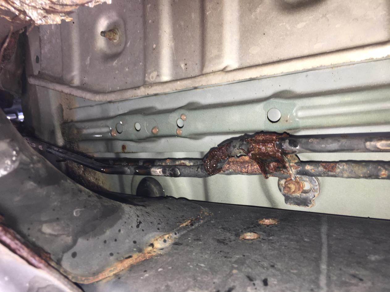

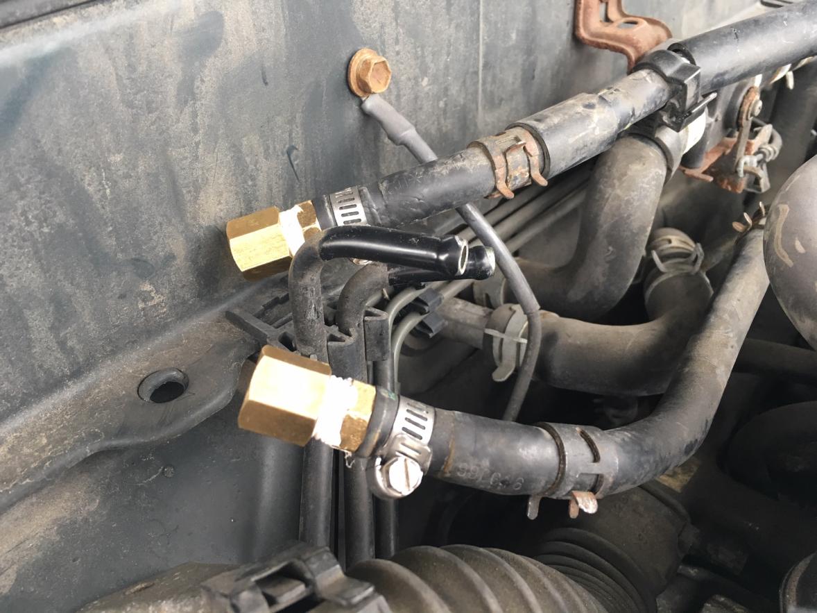

Frugal Heater repair - extra socks now
youngest boy (newly minted driver) drives down his coolant and overheats - turns out to be tiny hole in one of the lines going to the rear heater --
a couple of plumbing fittings to eliminate the flow up near the firewall - until he can save up for new lines or find some on a junker - and no problem.
anyone in the back will have to wear an extra layer now.
Note to anyone with slight frame corrosion - might be a spot to check and be proactive on - wish I had been - especially when he called at 11 at night with temp in the red!
