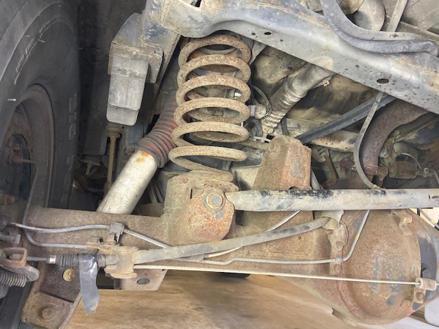

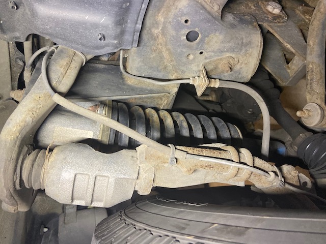

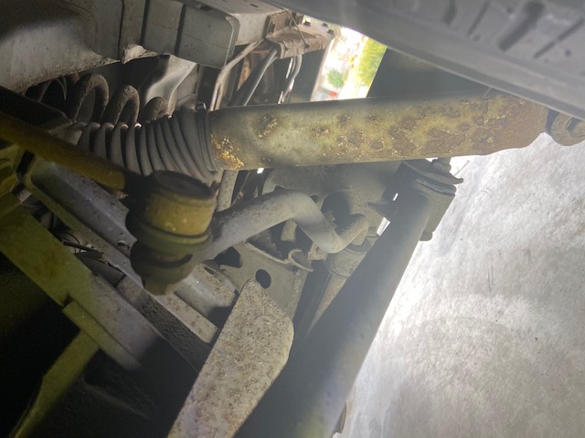

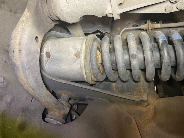

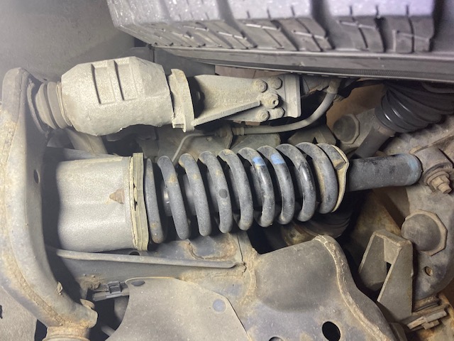

Hello from North Idaho. I just purchased this 1996 T4R from Canada. Has anyone seen a lift like this before? Seems to sit much higher then most I've seen. I think its a 4" but not sure. Anyone seem one like this before?

[MENTION=449039]wolf1776[/MENTION] That is a top strut spacer lift with rear coil spacers. Pretty cheap and basic for people that want the height of a lift and don't really care about suspension articulation. I've never seen one with what looks like an upper ball joint spacer as well. It looks like ther is an extra piece between the top of the spindle and the upper control arm where the ball joint attaches, You can remove the spacers (including the funky upper ball joint spacer) and be back at normal ride height, or replace it with better suspension components.
