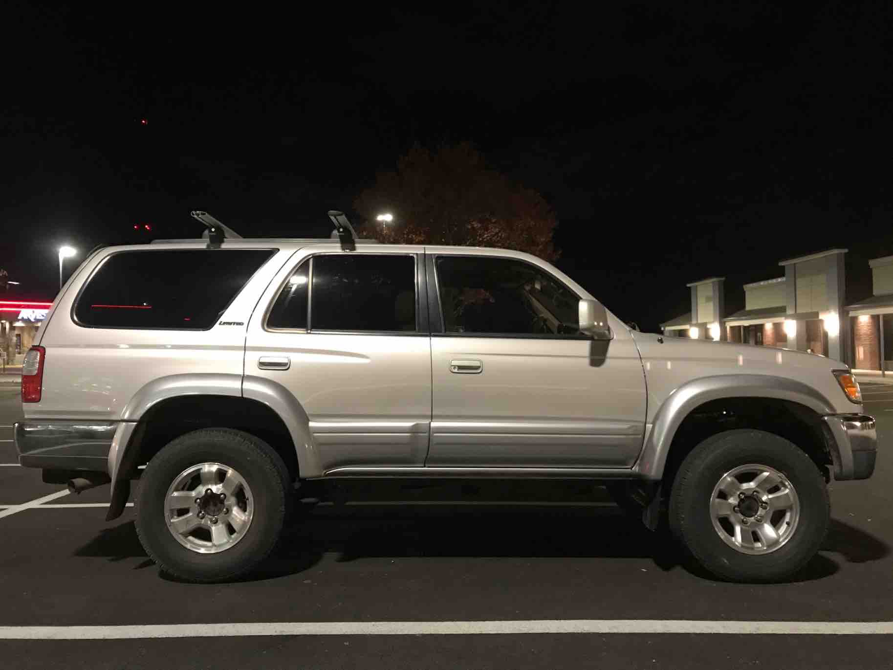

Picked up a brand new set of Falken Wildpeak A/T 3W tires in 265/70R16 from offerup.com
My T4R will not need tires until next year, but at $400, these were too good a deal to pass up.

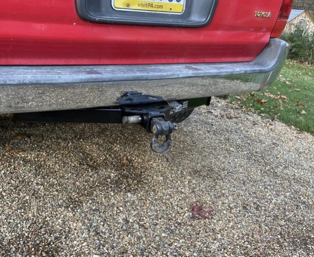

Hitch flip and some Gabriel Hijacker shocks. No more racks on the ground when loaded up for the weekend

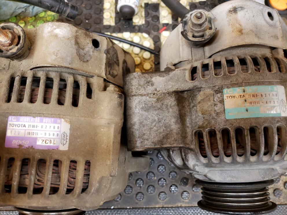

Today I upgraded from the stock '96 70A to a newused '02 80A alternator. Last winter I noticed when the electrical system was moderately taxed with headlights on, radio on and both heater fans blowing. I could audibly notice the fans slowing down or lights dimming when I hit the brakes or power a window up or down. We shall see how it behaves now...
I also swapped out the blower motor and fan for a newused one. My original one has been a little noisy on mornings for the last couple of years with morning temps <10°F.
The last thing I did was replace all of the rubber hoses up by the firewall related to the front and rear heater cores. There was some corrosion of the fittings causing some very small leakage of coolant.

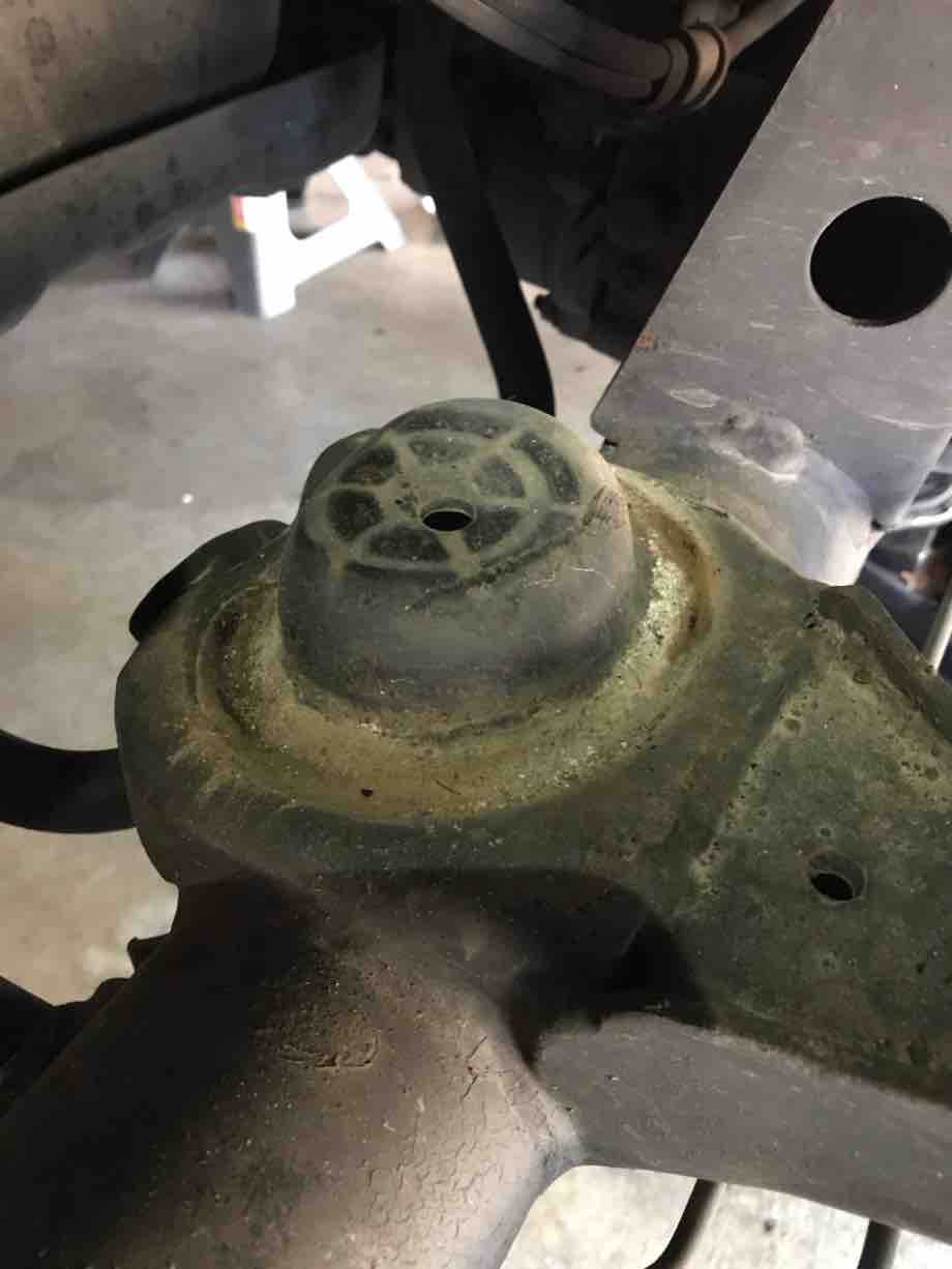

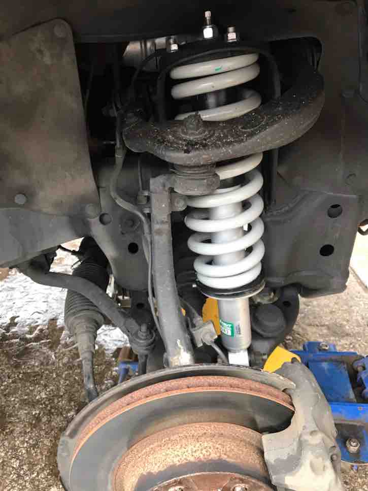

Did a small front end lift by adding 1/2" top plate spacers, along with new shocks.
I went with KYB KG9025 Gas-a-Just shocks, basic OEM replacement. Here they are side by side:
To install the top spacers, I replaced the original top plate studs with longer studs:
Here is the shock assembly with the spacer on top:
After driving around the block, I rechecked the hub to flare distance - it went from 21.25" to about 22.75", a bit more than I planned for. Hopefully it'll settle in a bit after driving some more (otherwise I'm going to have to raise the rear to make it level, not sure how my wife is going to like that). Here's a comp photo:

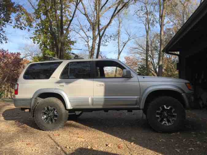

Tires too big! Knew it but couldn’t resist mounting them up since they were already on these rims I scored on CL.
Any body need some 285 mud terrains?

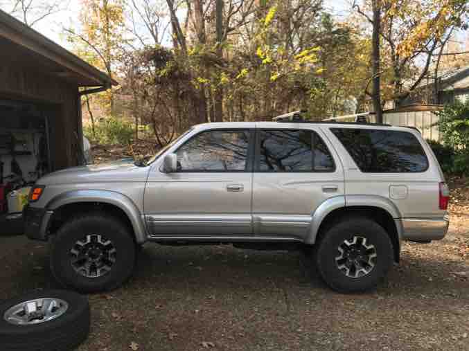

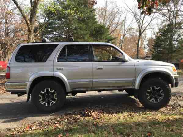

Also, for science, decided to throw on sensen front strut/coils @$116 for a pair, preassembled and moog “talls “ plus air bag assist... We shall see how long they offer an improved ride quality and restored height.
Think ill also try out the sensen rear dampeners to see if they can tame the bouncy-bouncy that has replaced constantly bottoming out the rear bumps!
Never would have rolled on those 285’s with no body rub! Drivers rubs the spindle though on the factory width rims.
