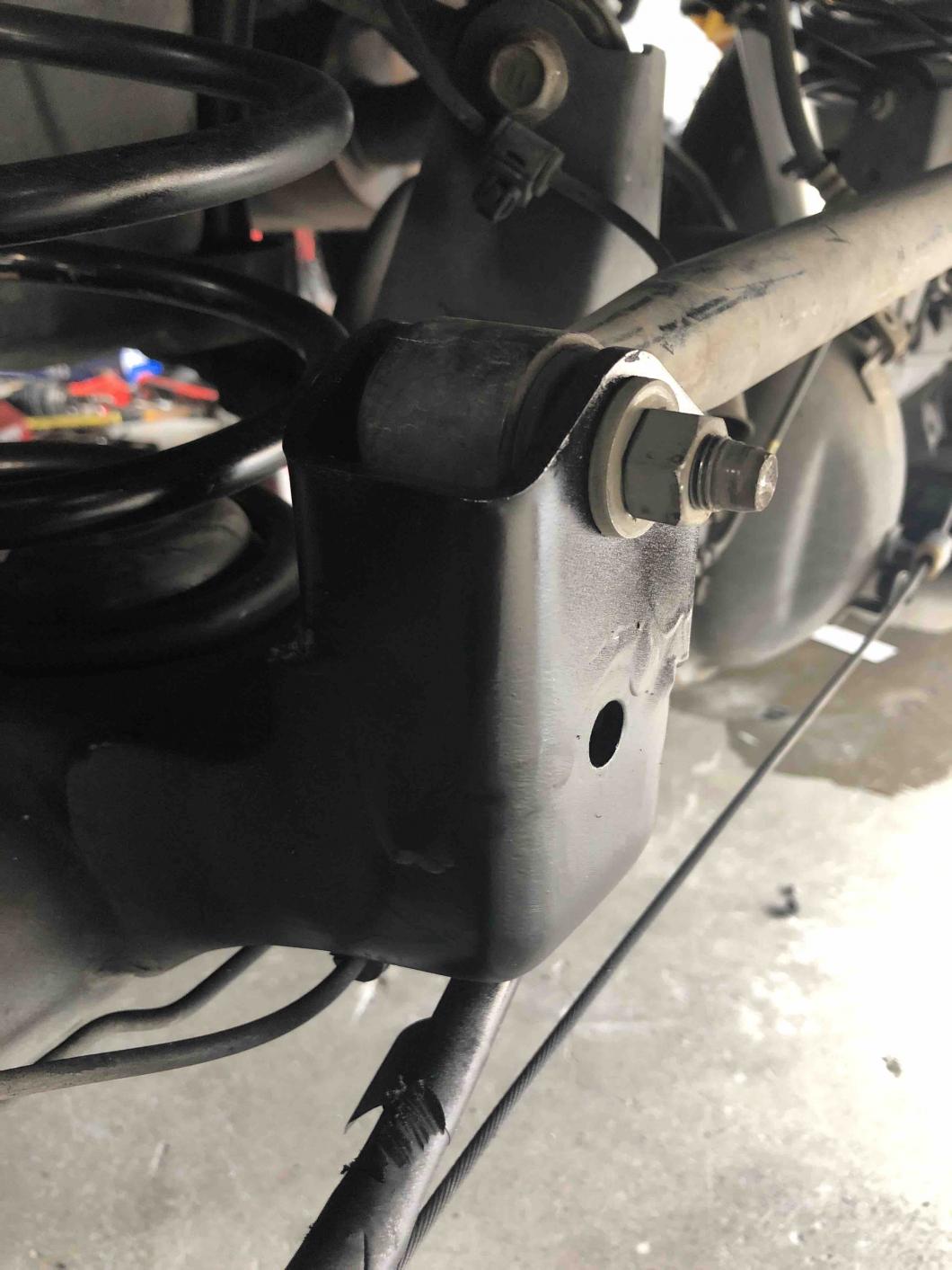

Installed new upper control arms, Icon 2.5 Extended travel coilovers, Icon 2.0 rear shock, toytec superflex coils, Panhard bar extender, and fresh Cv Axels!
