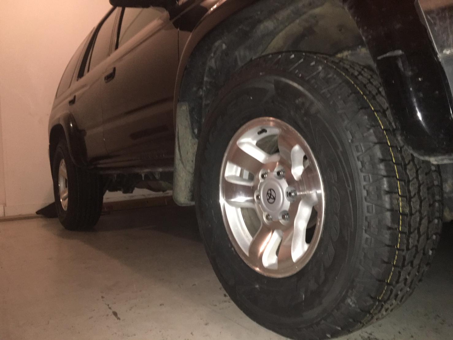

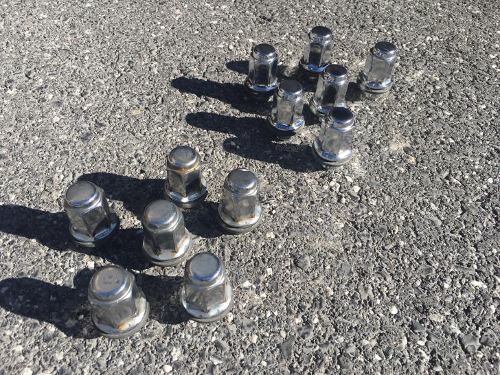

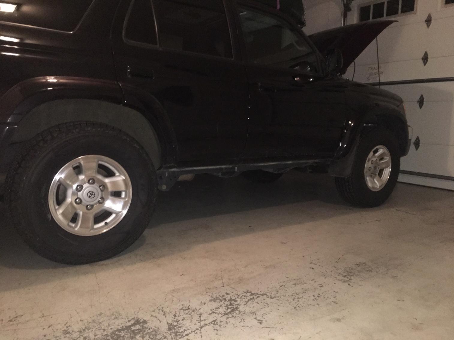

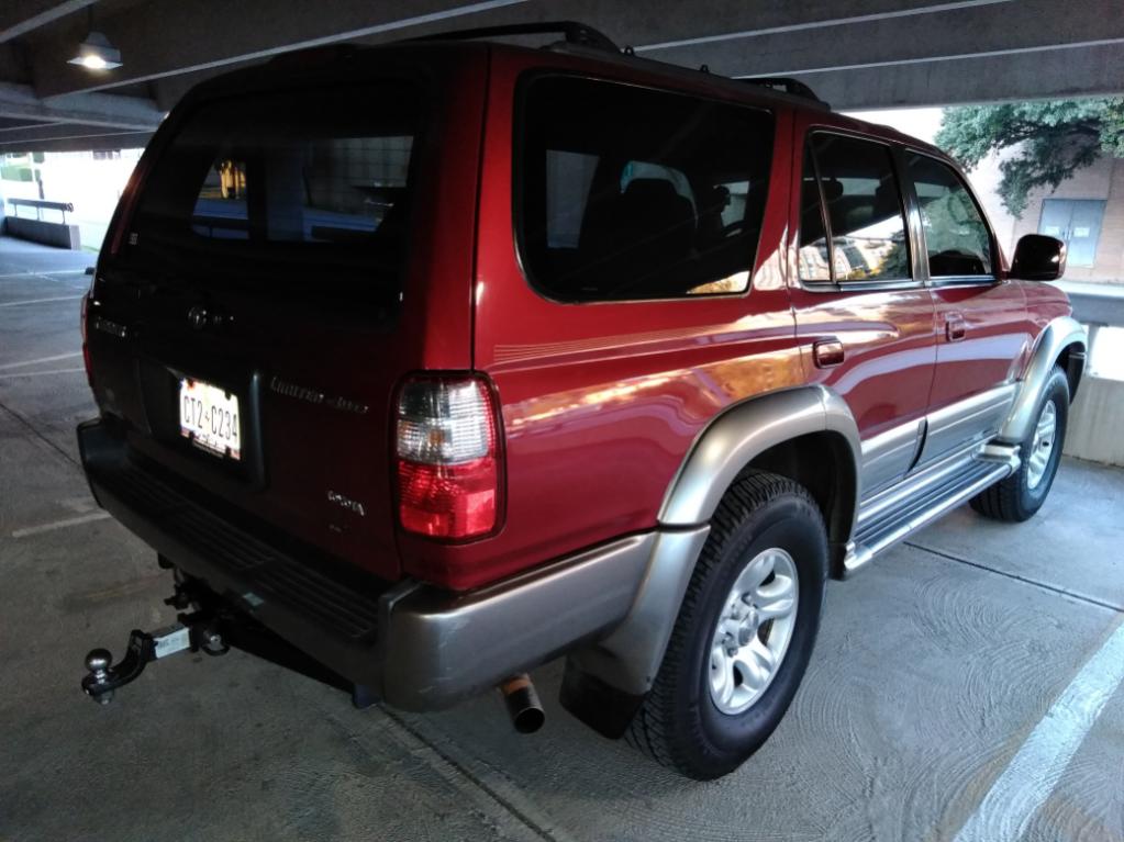

New Tires and Polished Nuts

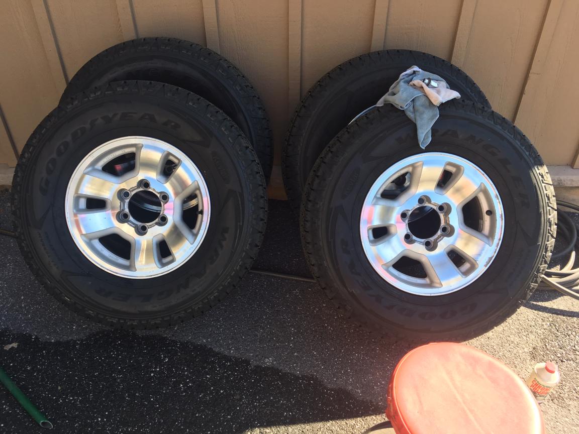

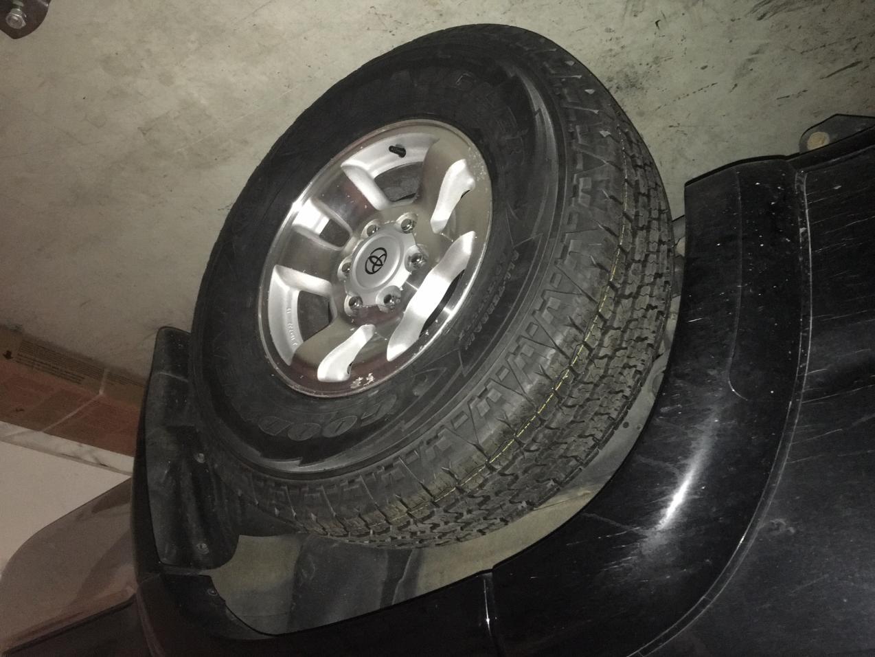

got the Goodyears installed. Painting the plastic hub covers with SEM 15083 Silver paint -
Done - bad paint match
Either have the wheels too shiny or I was thrown off by the fluorescent lights for a match at the body shop supply store - still - it looks better than the start -
sharpie marker to fill in recessed emblem!

Those wheels look brand new! Were they in really good shape to start? How'd you clean them or did you repaint them? My 6 spokes are looking rough. I've tried aluminum wheel cleaner and IronX without much satisfaction other than getting rid of brake dust.
I just picked up some 5 stars but it's going to be a while until I get them painted or powdercoated. I'd love to have my current wheels looking better until then.
Thanks man! They were pretty beat to start. I repainted them with VHT Silver wheel paint from Autozone. Prep was wash, go over the whole wheel face with maroon 3M scotchbrite, wash again, and wipe down with alcohol.
i hate to break this to you, but that sharpie isnt going to stay. you will need to paint it if you want it to stay. the wheels are very clean though!
