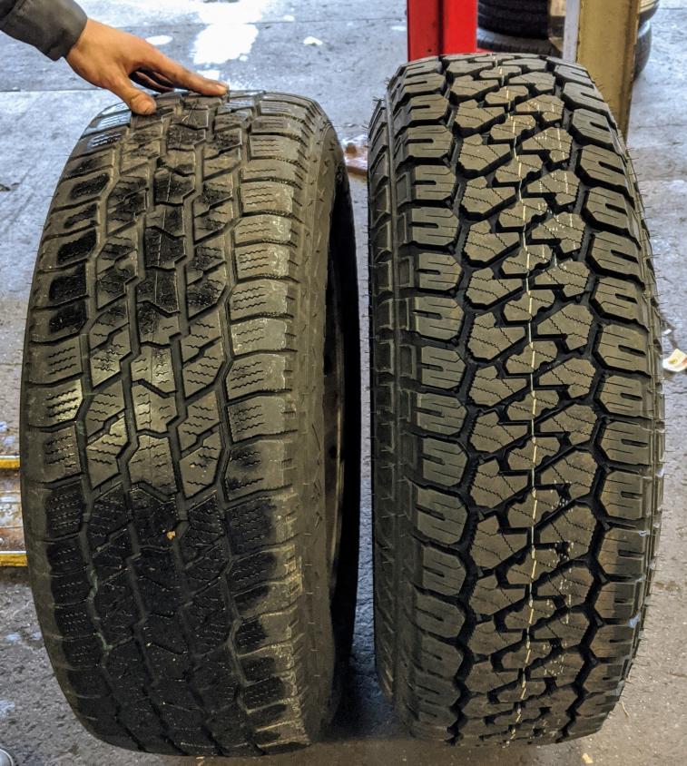

New shoes. Swapped my Cooper A/TWs for Firestone Destination X/Ts. Went from P265/70/17 to LT255/75/17 C load rated. Pic shows each as mounted on my SCS Stealth 6 17x8.5 wheels. Merely a 3lb increase per corner from the 35k mile Coopers to the LT Firestones. Very pleased.

34,117 over 4 years, 2 mos. I didn't measure tread depth, probably could have run them a bit longer; but there were a number of factors leading to replacement. They had developed somewhat significant oxidation cracking. Hate to admit that I never rotated them (I'll do better with these I promise) and an alignment toe issue (resolved yesterday) had caused irregular shoulder wear on the left front. Then of course, I'm in the Northeast and snow is coming, actually it's here.
I also wanted to move toward the pizza cutter camp. Though I'd planned on 33's (255/80/17), tire weights of 51+ lbs & E rating ultimately deterred me. I settled for true 32s (x10) with the 255/75s and I'm happy I did.
cracking in 4 years? are you sure the tires werent old? or were you just hard on them?
i can be the first to tell you, my mileage went down pretty hefty when i put my 33s on.

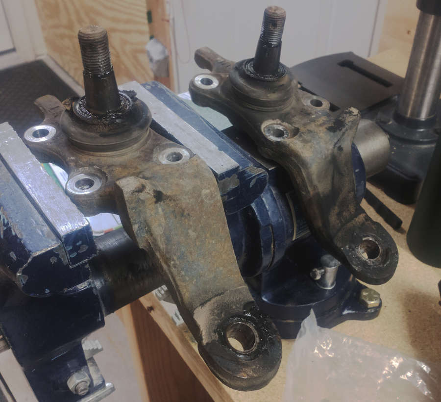

new LBJs :biggrin1:, thanks to the encouragement offered in [MENTION=120071]mtbtim[/MENTION]'s great tutorial. it was surprisingly easy, and took a couple hours including a short break after finishing one side. the old ones weren't completely borked, but they were noticeably looser than the new ones.

Is it possible to just buy only ball joint and not the whole assembly.. Could you press out the old balljoint, like the LCA bushings.

Not to the knowledge of this forum. There was an attempt to use just the ball joint from a Land Cruiser, but it didn't work correctly.
At $200 per set and only Extreme crawlers needing them more frequently than 100k miles, it's not a huge deal for now. Once the Toyota parts dry up though... Mall Crawlers can realistically go 200k trouble-free miles (and more, but that's my personal limit for the risks associated).
i'm guessing this pair was original, and thus it went 192k before i called an end to the fun. impossible to say if they were factory-original but they are OEM. thinking i'll keep them for a bit, just in case. i also went with new bolts. the uppers still are tight, so i'll hold off on those for warmer weather.
