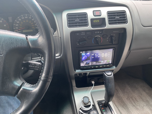

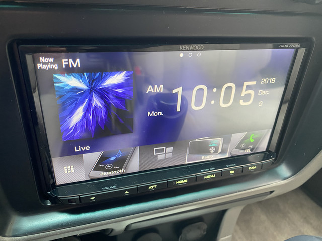

It was a few days ago, but I put in a Kenwood DMX7706S double din.
CarPlay is really cool, my favorite feature.
No bezel trimming required, pretty much a direct bolt in upgrade.
A tip on the mysterious and confusing orange/white illumination wire that many people leave disconnected for fear of frying their rheostat - Metra 70-1761 has an orange/white wire in position 10 of the larger connector labelled "dimmer" which can be connected to the orange/white of the Kenwood harness labelled "illumination". This wire gets 12V power when you turn your running lights on and will dim the display and hard buttons. It also switches the style of some apps such as changing the CarPlay Maps app from light/white style to dark/black for night driving. Pretty slick.
This unit does NOT have a dedicated power antenna wire so your power antenna will always be up when the unit is powered on, even when you are not listing to the radio. Guess I will have to do Taco whip or add a switch, we'll see.
Otherwise the install was fairly straightforward. You could literally do it in 30 minutes if you have the harness already wired up. However the backup camera is another story...that took a long time.

Does that USB plug below the unit work just like ones in newer cars? Assuming it's plugged into the Kenwood unit.

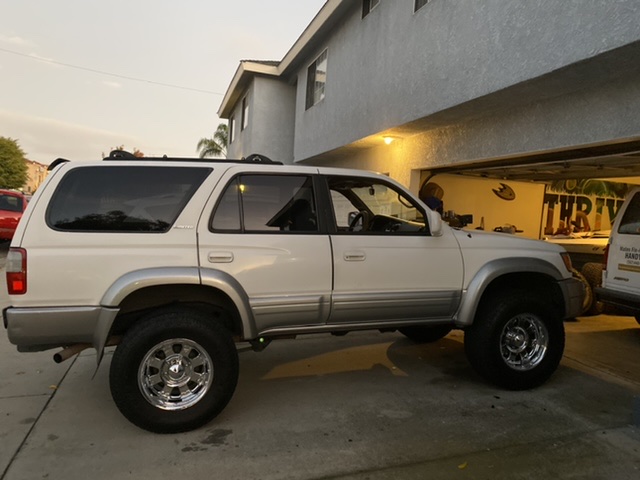

wife bought me new tires for christmas so I finally got to mount my trd pro wheels!
tires are 255/80/17
clean install - looks great!- I suffer the same antenna issue - unlike you (where I guess the signal prompt does not exist with the new HU) however I cannot figure out how to make my antenna go up ONLY when I want radio on my aftermarket Kenwood Excelon KDC X998. Forum search continues.

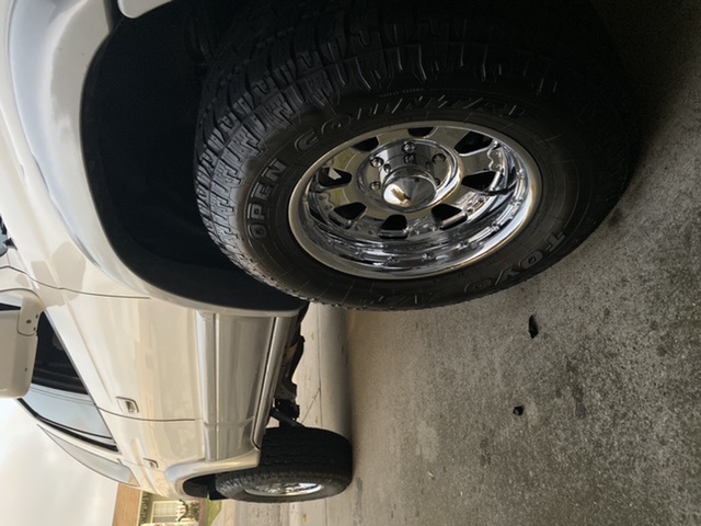

New wheels and tires
Shortly after painted my 5 star OEMS I got a maaaajjjjooor hookup. I got this brand new in boxes Boyd Coddington 17x9 w/ Toyo Open Country radials 285/70r/17 with 60% tread left. All for FREE. My cousin called me and said meet me at the tire shop I’m getting new tires and you can have my Boyd’s that have been sitting in my garage for 2 years. I never got up so quick to the tire shop I went haha. So stoked looks so much better and fills in the fender flares!

Wow, that looks great. I don't think I've seen a 3rd Gen with a snorkle before. And the TRD Pro wheels are a perfect compliment. Are you getting any tire rub?
thanks!
very minor tire rub and only at the front on turn/compression on the inner fender liner and plastic portion of the front bumper. it doesn't bother me much and will massage things eventually to where it doesn't rub on its own. plus I plan on removing the plastic on the front bumper and just running the metal portion.
