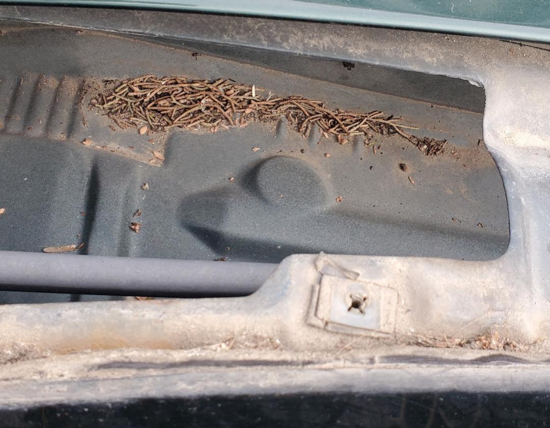

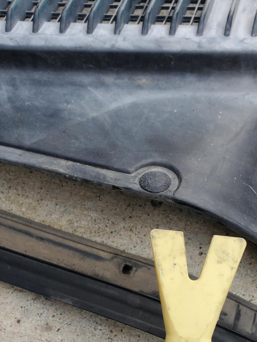

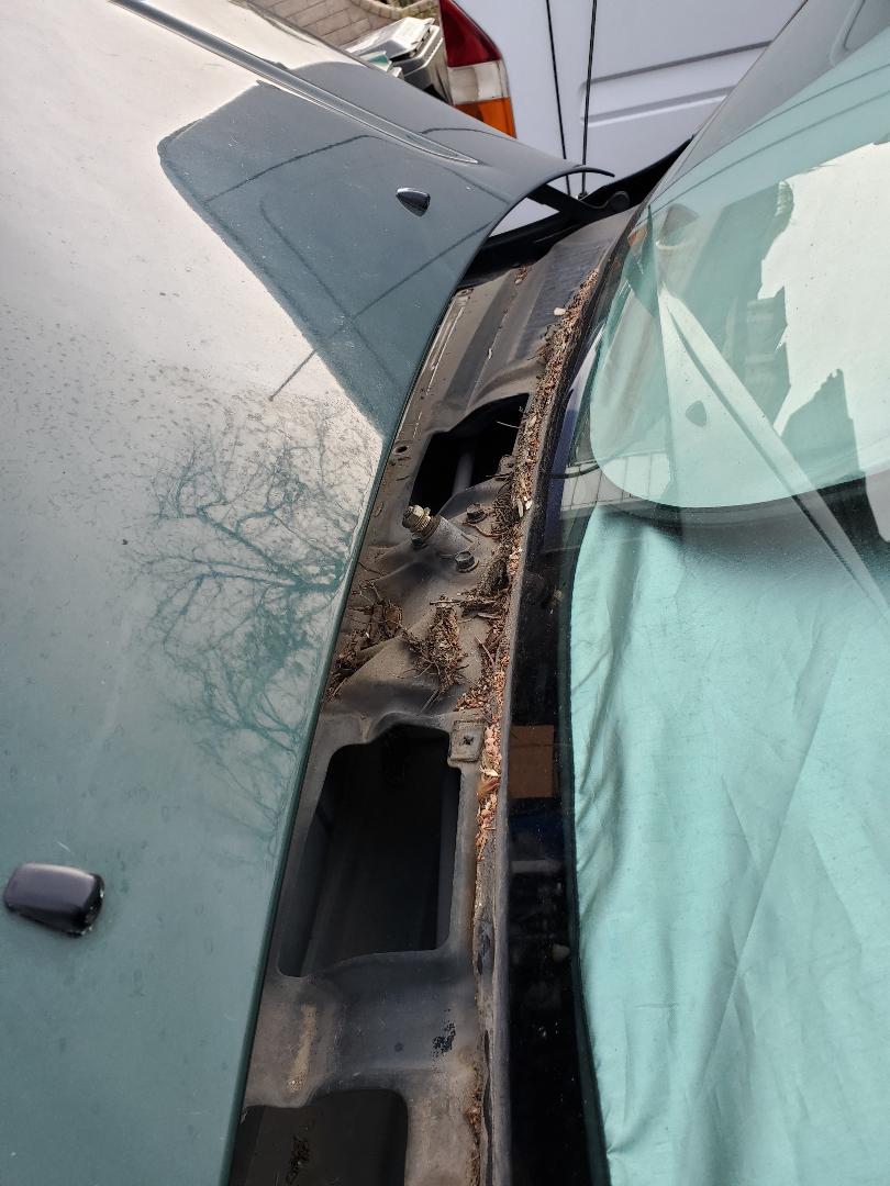

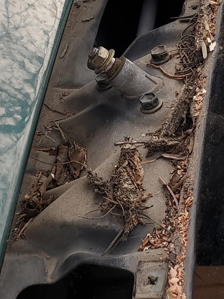

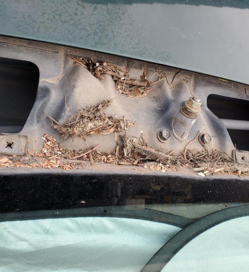

Was getting a few drops of water in the drivers compartment, suspect it's the grommet thru the firewall so I siliconed a piece of plexiglass in the corner above it to deflect any water from above. I noticed a bit of crud in the trim piece under the windshield wipers so I popped that out and cleaned out 21 years worth of pine needles and dirt. Glad I live in SoCal or this would be rusted out for sureI should have taken a picture before I vacuumed out the pine needles. There's a gap between the trim piece and my windshield because the glass was replaced(I can see a couple scratches in the frame around it) and there's excess silicone bead that doesn't allow the trim piece to fully seat. Trimmed it with a razor and now it sits flush against the glass, the gap was filled with pine needles. The 4 clips pop out with a body panel pry bar. The trim piece is badly oxidized and I would like to repaint it if I find the right paint color for plastic.

FWIW, vinyl dye would be better than paint. This is the stuff the "pros" recommend...
Solution Finish Black Plastic & Vinyl Restorer 12 oz.
But plain ole black shoe polish will achieve the same results (maybe not for the same time though?)
I used something similar - https://smile.amazon.com/dp/B00FIU54BW/ref=twister_B07XGFJCLK?_encoding=UTF8&psc=1
I used it on both the cowl and rear bumper trim pieces. It came out really good, although is you look super closely, you'll see the brush marks. So I don't look too closely.
The real question is how long does that good look last?
I use 303 Protectant and it does a good job for a few weeks, but then it must wear off and the trim is back to its tired looking self. :D

I should have mentioned that - mine's been on there for two years, and it looks as good as when I put it on. And my truck is not garaged, so it gets the full CA sun exposure.

That's the difference between a Dye, something that has color of its own, and something like 303 which is more along the lines of a colorless wax that temporarily restores some of the oils to the plastic. 303 is a failure at restoring faded plastic because it has no color of its own.... might help plastic from degrading as quickly and it does a fair job at cleaning plastic without stripping out the oils, but that's really the limit.
I'm just about to embark on the same plastics treatment. The product I used last time is no longer available, but it lasted for ~4 years before I sold the car... hoping that the Solution Finish is even half as good. Just be very, VERY careful to not get it on anything you don't want black. Remove the part if possible (as you have with the rain guard), or at the very least use plenty of masking tape.

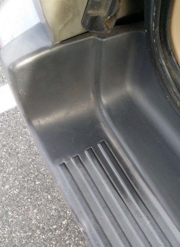

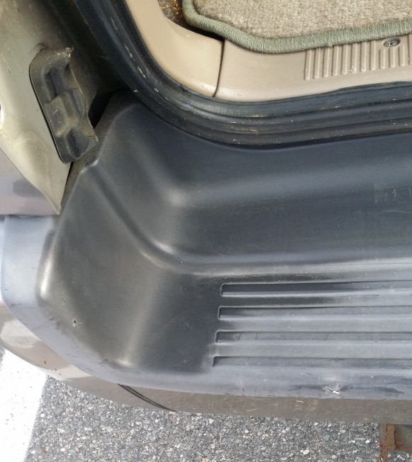

I've been experimenting with the heat gun as a way to restore the
plastic, and it ~works. I need to pull the panel to finish.

I've been experimenting with the heat gun as a way to restore the plastic, and it ~works. I need to pull the panel to finish.
I've tried heat before (colored plastics, dirtbikes) and it does sorta work, but it's still short term. Months instead of weeks for things like 303, vasoline, baby oil, etc... but there's a bit of skill involved in raising the oils without warping/distorting the panels. And it tends to lead to "tiger stripes" (looks like it sounds) as you heat a section at a time, usually more noticeable after those oils have faded away and it's back to looking sun beaten.
I had meant to ask if the plastic trim was originally Deep black or more of the grey-black.
