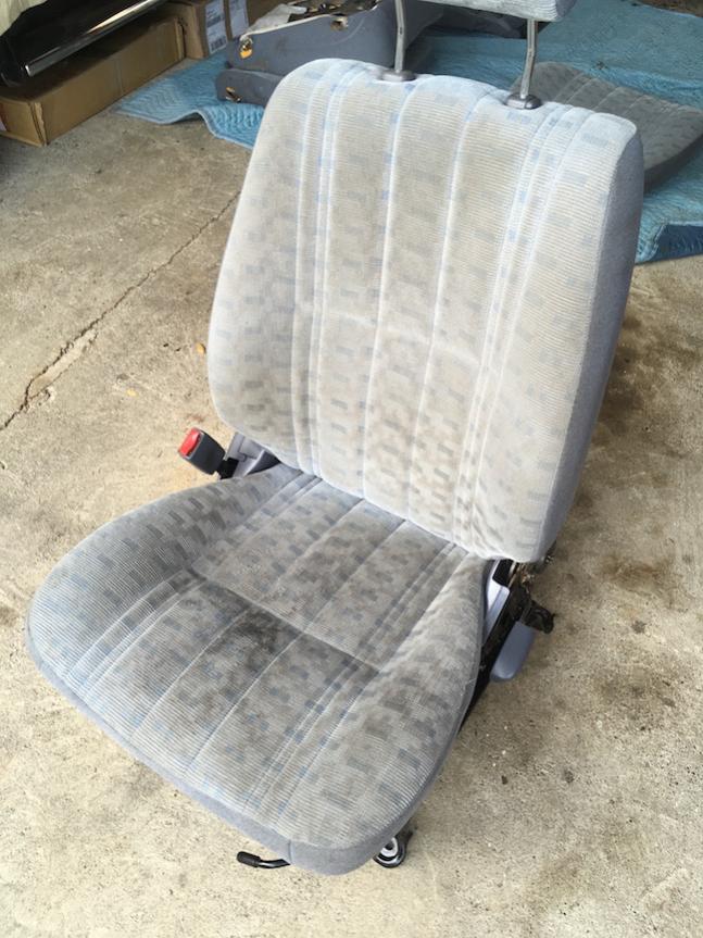

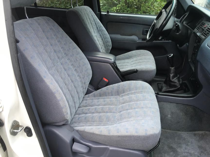

Another new member, rebuilt/cleaned my front seats
Picked up a clean/orig 2000 4Runner, 2WD, 2.7 5 speed, one owner, 160K.
Interior needed TLC, rebuilt/cleaned both front seats using parts from 2 donor cars. As bought drivers seat (I doubt it was ever cleaned) and end result.
First 4Runner for me, have owned Toyota pickups/Tacomas since the early 1990s, so not too foreign territory for me.

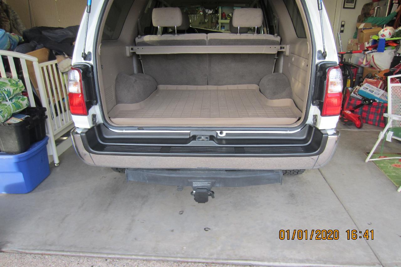

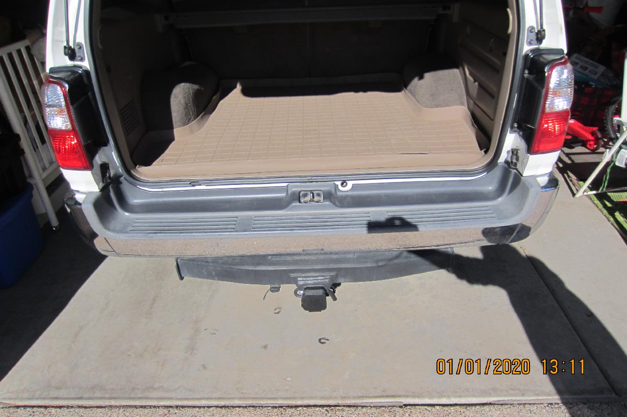

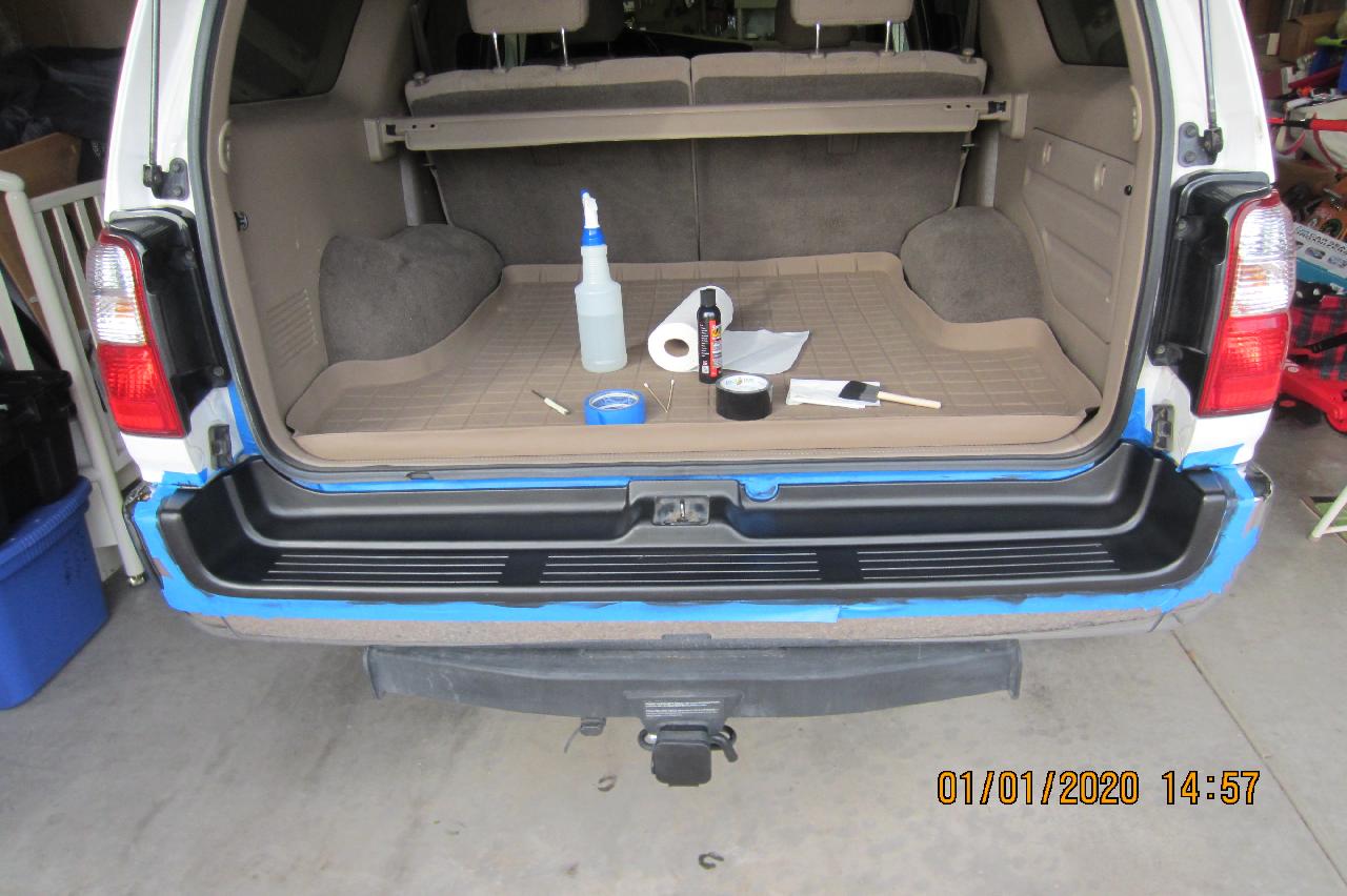

Decided to dye the rear bumper trim piece based on another post in this thread.
Looks pretty good. Only question is how will it last. This weekend I'll do the front bumper.
Car was fairly clean so prep was wipe down trim with wet (water) microfiber towel and then wipe down with towel soaked with IPA. Tape the area no matter how good you think you are applying this stuff. It will get where you do not want it.
My guess is I used 3 ounces to do this, and the remaining 3 ounces should be enough to do the front bumper. It takes a little practice to learn to evenly cover an area. Also, pay careful attention to not miss any uneven areas like the raised bars in these pix.
