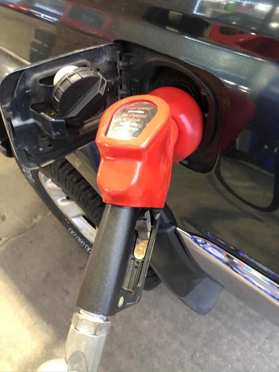

Filled her up with some well deserved premium.
Pricey stuff!
:wow:
Erm... do you NEED premium? If not, you're paying more for something you don't need and opening yourself up for more trouble with water in fuel. Unless you're pinging/have detonation issues with lower grade fuels the increased octane offers no benefit and beyond that, there is Zero difference with the fuel. Heck, back in the day when I was a pimply-faced kid and worked at a gas station, I had to add that octane booster to the tank after the fuel delivery (same fuel went into 3 tanks, I made additions based on gallons added).
And since premium is less often bought, it sits more often and tends to be more contaminated with water, silt, and is a little more "stale" (oxidizes more).
Too many people think that "premium" means better, hate for you to be one and throw your money away.

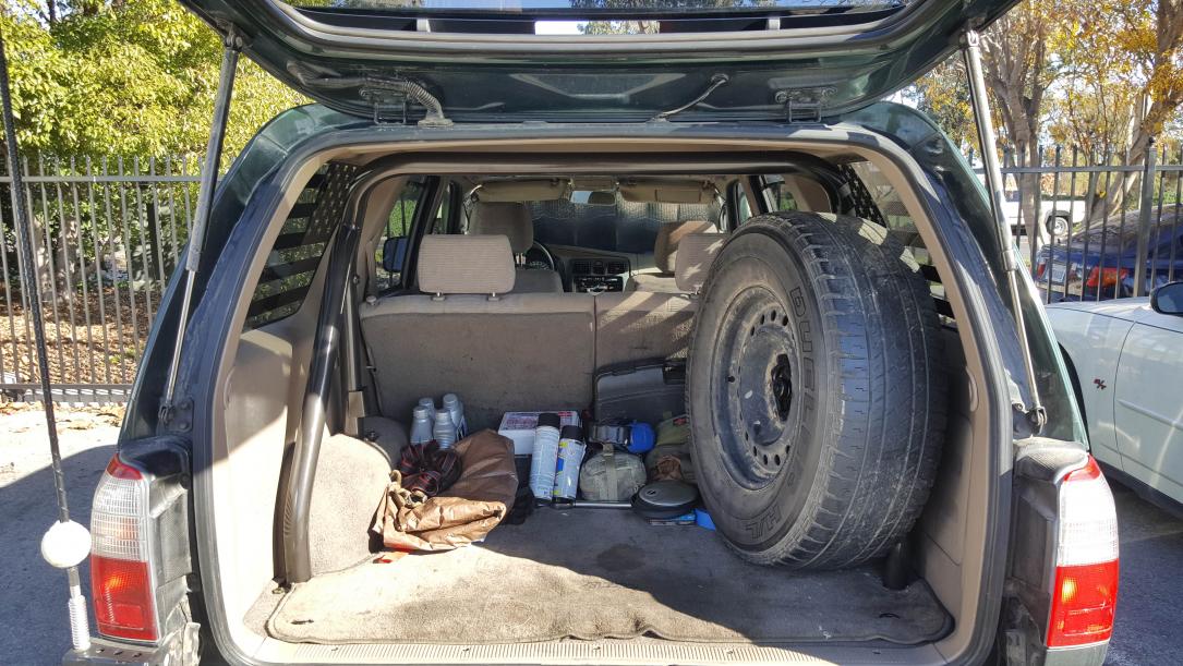

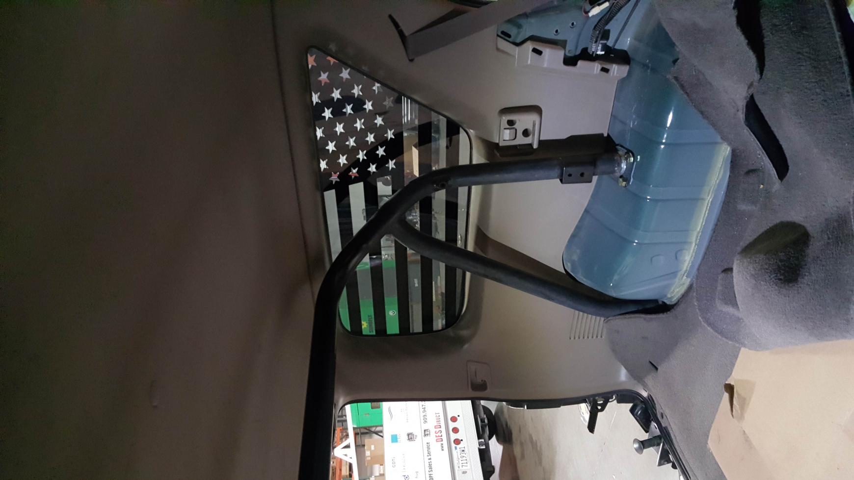

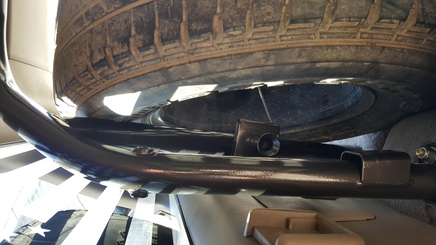

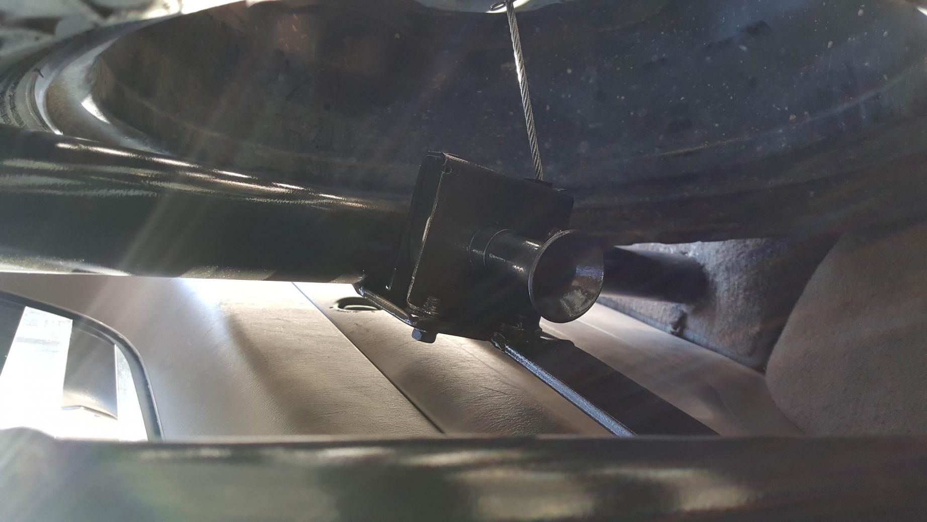

Did the 1st gen roll bar mod over the weekend and just finished installing it today. Made a spare tire holder out of the toyota tire holder thingy. Should have plenty of room for 33" or maybe bigger to fit back there. Took about 4 hours. Onto the pics.
Edit to add - I cut the carpet to mount to metal. As I have to pull carpet again to add a access hatch when I finish the f150 tank swap. Also don't mind the bald jankey spare it's all I have for now.
