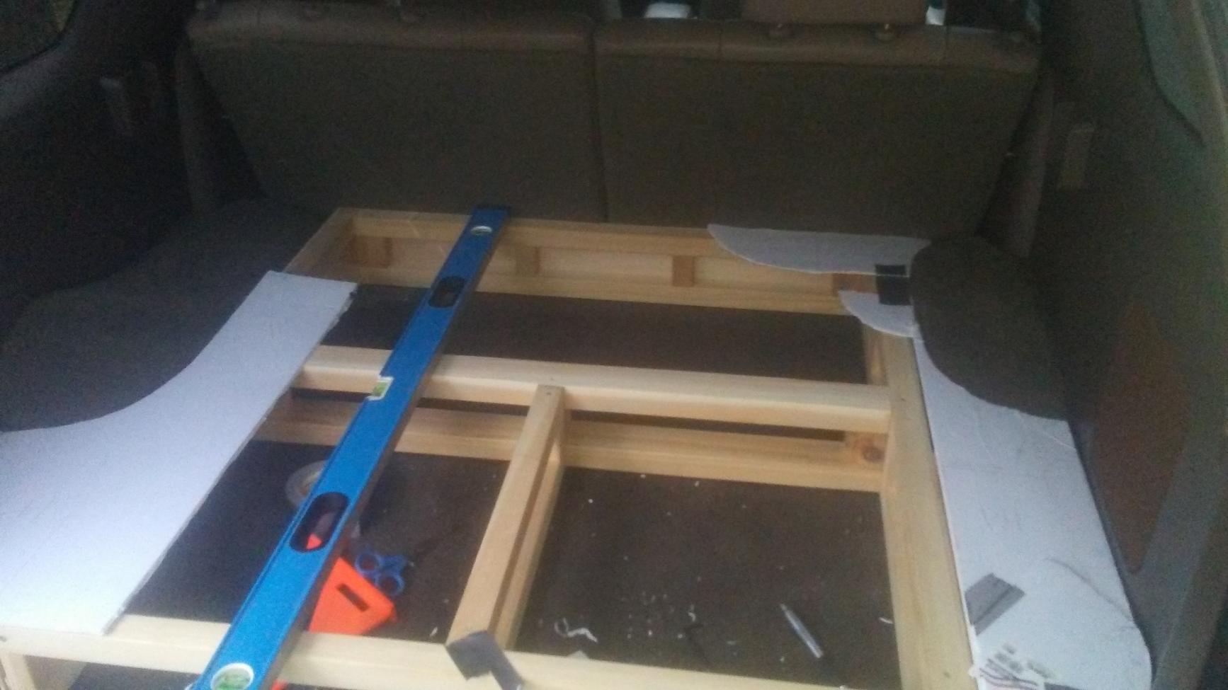

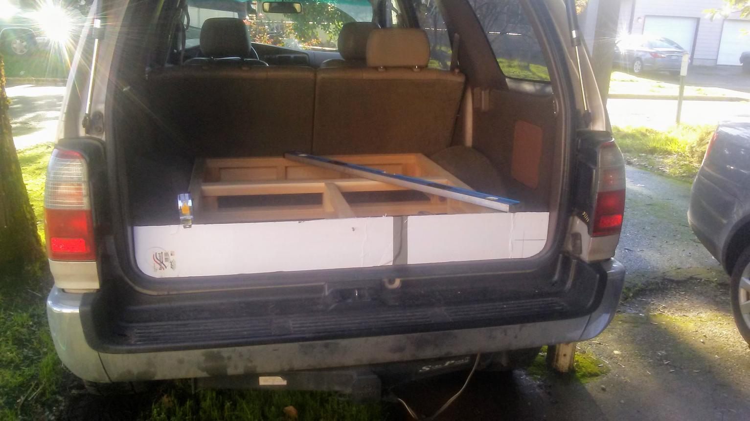

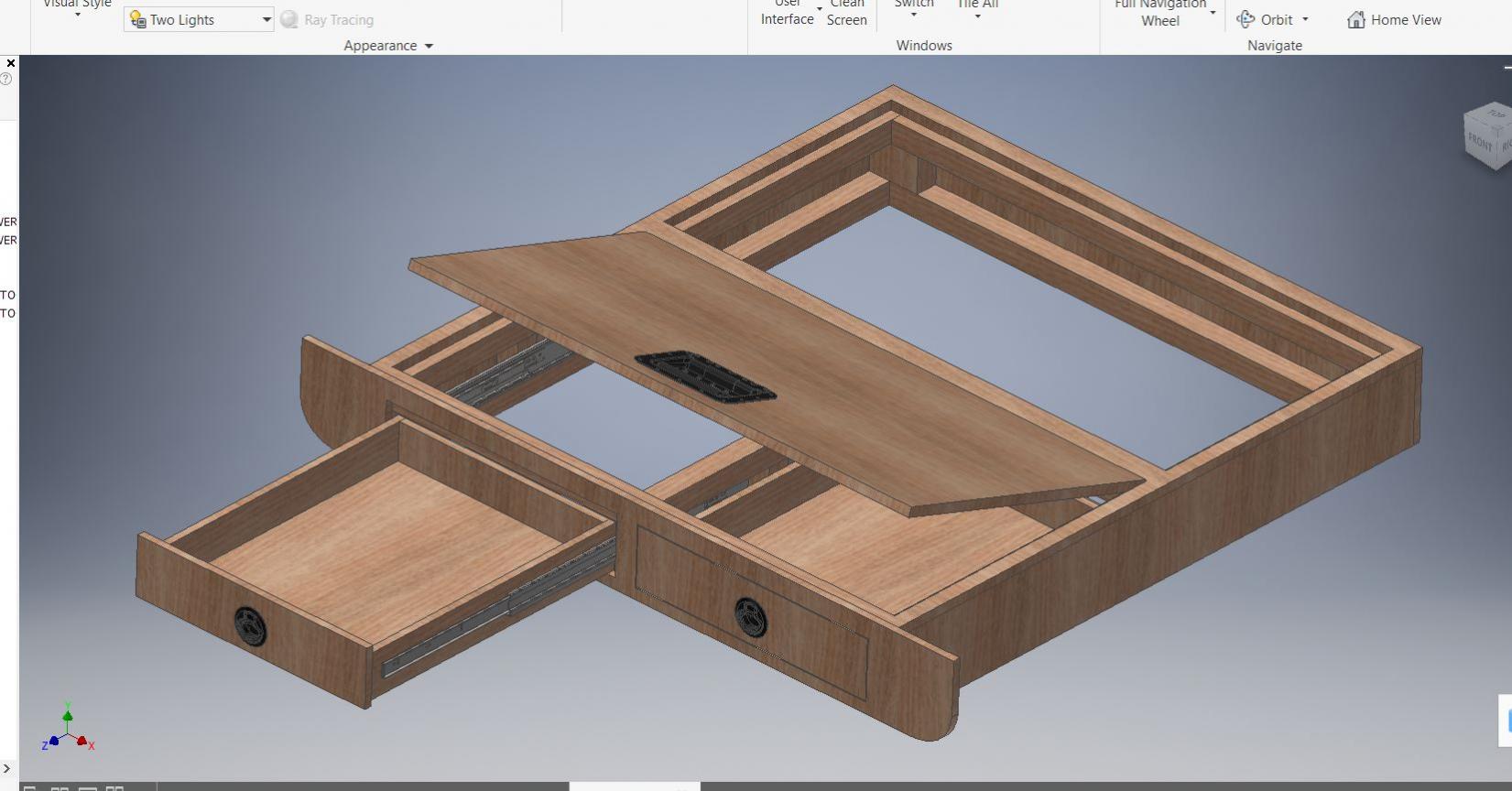

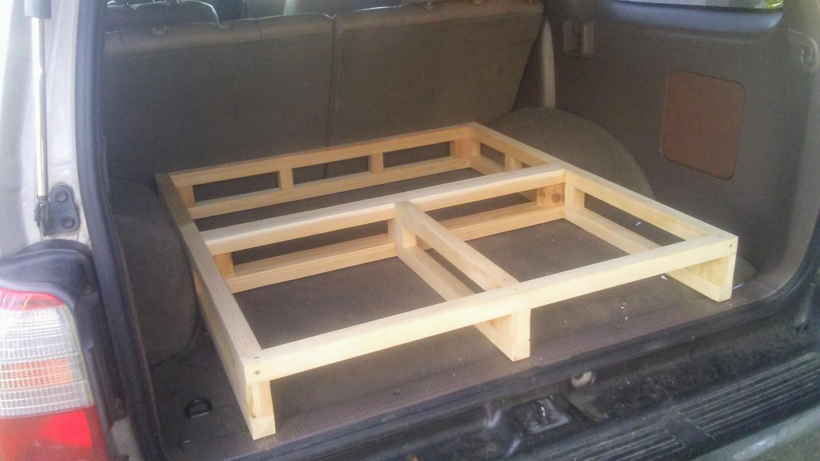

My current project, low profile cargo storage as I stuffed an 8" sub in the factory cargo hole leaving me nil. Still figuring out what I want to do with the back space...
Working on this project myself but will design it for sleeping as well. Do you have drawer slides and the other hardware picked out? Curious what you plan to use. Looks great so far.

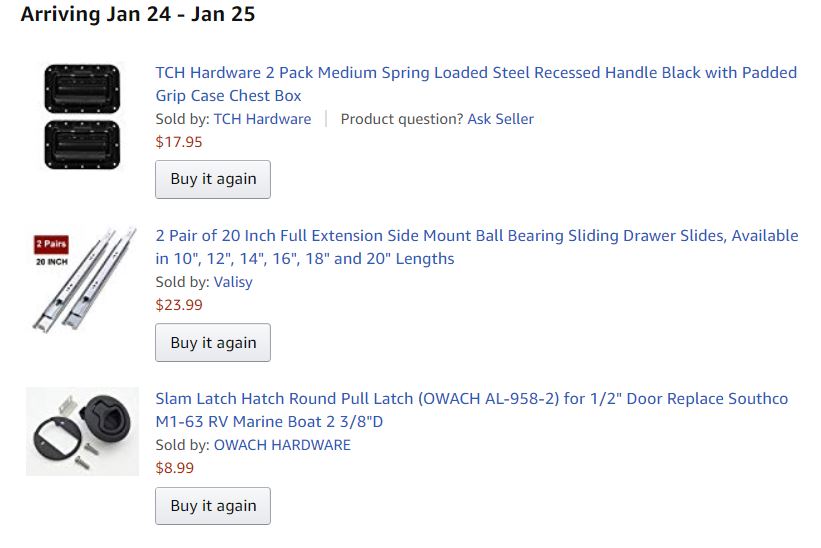

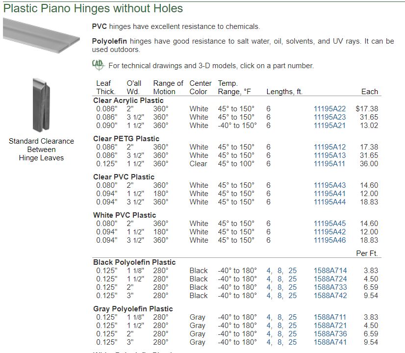

I do have some stuff on order. The hardware in the assembly are CAD files from McMaster-Carr for easy importing into the model, but found these on Amazon which are very close and think will work well. The drawer slides are slightly different from the model so I will have to adjust some side mount locations. For the hinges I plan on using something like pic'd below for a flush surface as I will be carpeting it. The rear-side pockets will have some sort of top drop panel I'm thinking...

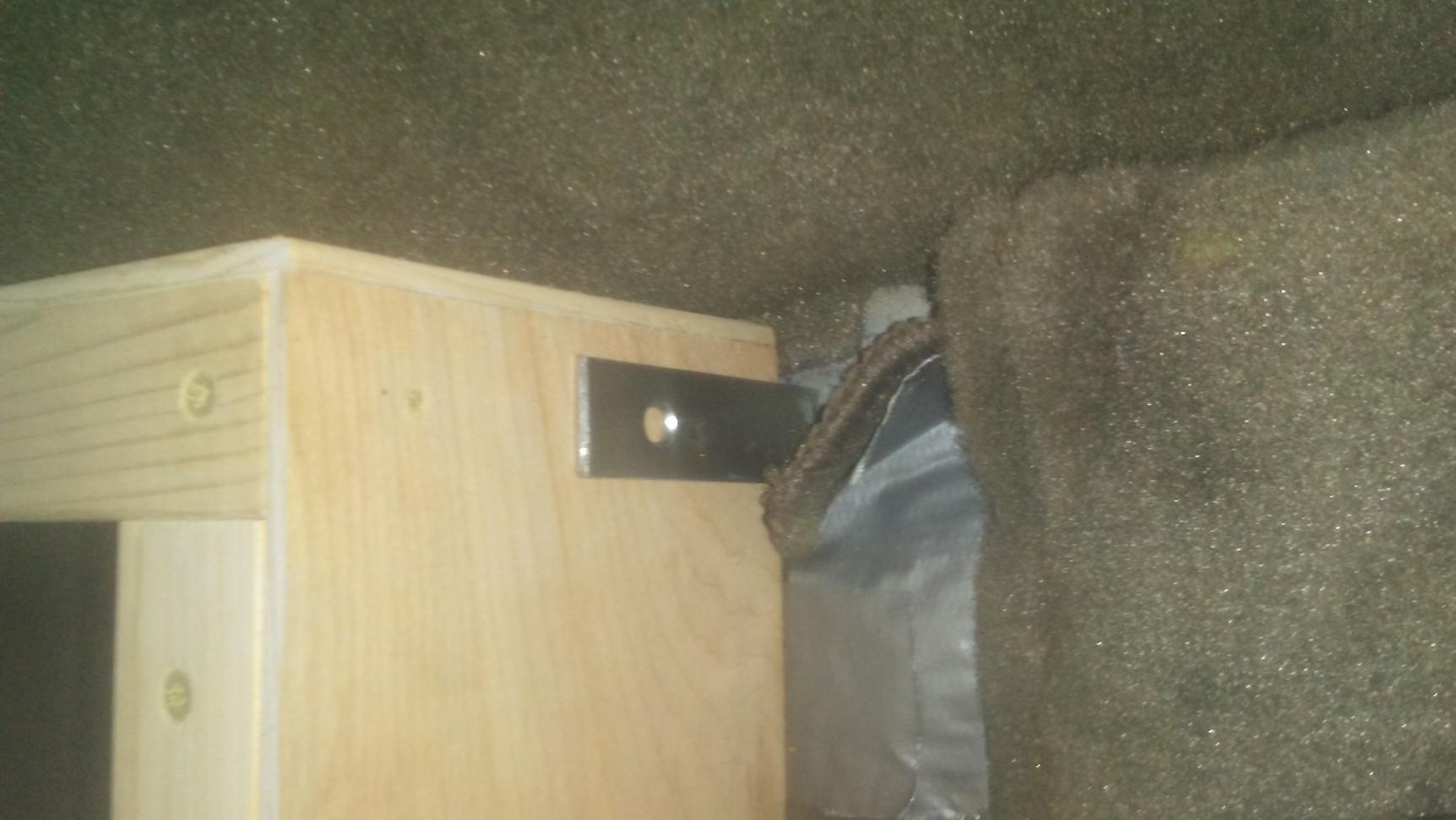

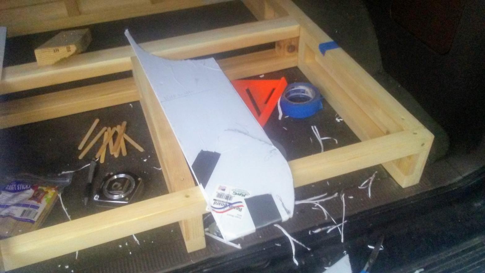

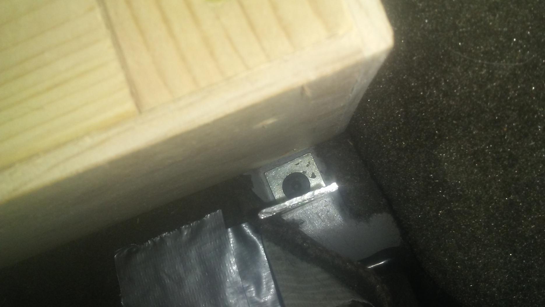

More progress pics. Got the front rear mounting solution done. Used holes from existing tie downs...ACE brand external 90* strap cut into two pieces, put in vise and bent. Template made for maximum coverage edge to edge...
