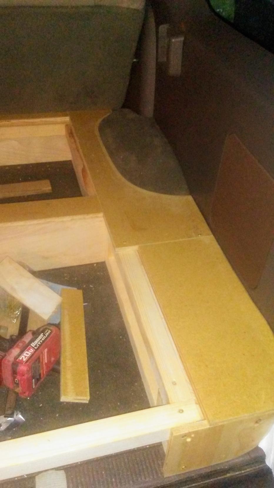

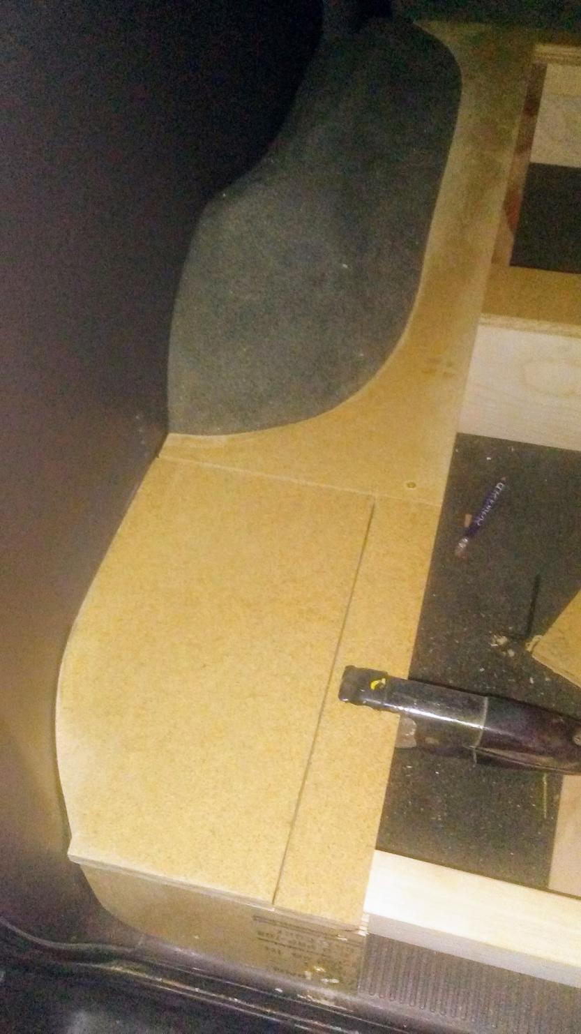

Made some headway on the cargo box. Had the contours transferred to foam board, then the 5/8 top I'm using (1/2 seemed to flex a bit much and 3/4 would encroach on my sub enclosure so I went in the middle for sake of drawer height), the hard part is done! Dialing in those wheel wells and the side cubbies took me some time with the templates and massaging of the wood, lots of scribes and palm sanding. Had to bevel the underside of the contours with my framing saw to compensate for the diminishing upward angle of the wheel wells for a tight fit. Got the lids ready to place and hopefully the hardware will be here this weekend. Still need to find a good matching carpet, thinking somewhere between speaker box and OEM plush...any suggestions?

Looks good! I usually use a non-backed automotive carpet that has some stretch in it for covering raised floor builds like this (generally custom audio builds). It's pretty durable but if it's gonna see a lot of use/wear it will show over time so a thicker more OEM carpet would probably hold up better.
I like to wrap the carpet around the edges to the underneath side for a nice tight look from the panel to the vehicle but it also helps for an edge ever pulling up with wear. The downside is you'll have to account for the carpet thickness in order to do that which even with the thinner automotive carpet it's probably a good .125" plus all around.

Thank you for the response, great info, just what I was looking for! The thicker stuff would certainly be nice for the wear and look, but yeah, it's pretty thick and would be very hard to tuck around the edges. That being said, I'm probably going to run whatever I use a scoche long around the carpeted wheel wells and feather it / tuck it into that gap (they're pretty damn tight around those), then stuff it down along the edges where the plastic is at for the fit and finish and to give a little cushion for any rubbing. I'll take a look at the non backed auto carpet. I kinda need that in hand before I do my final trimming...

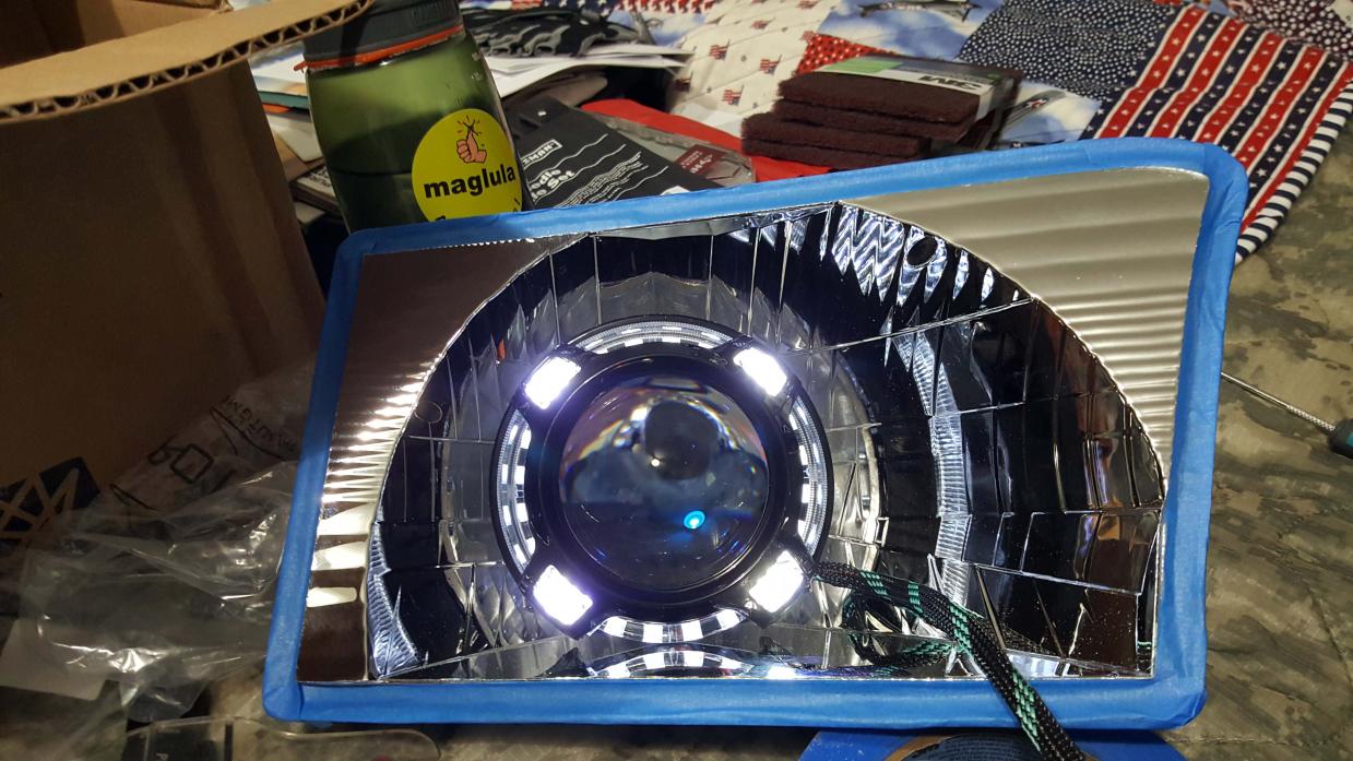

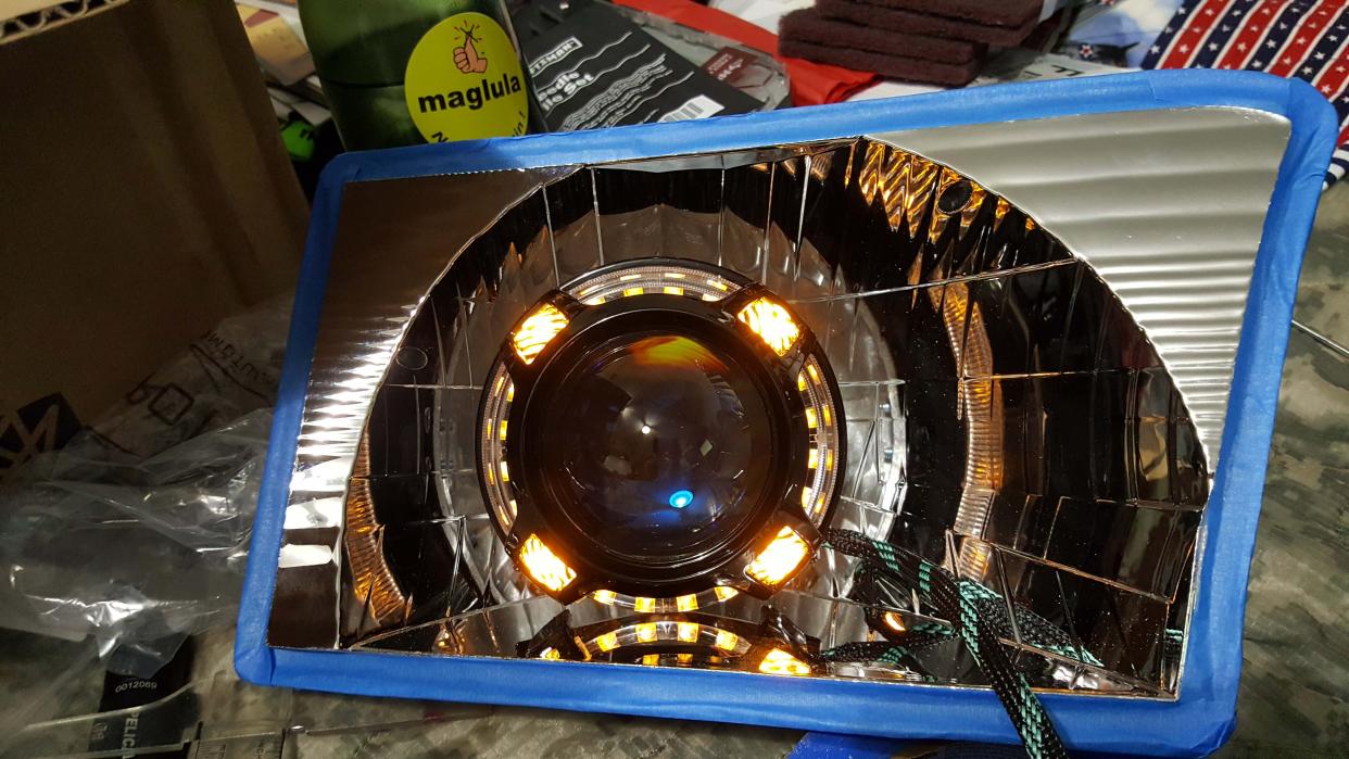

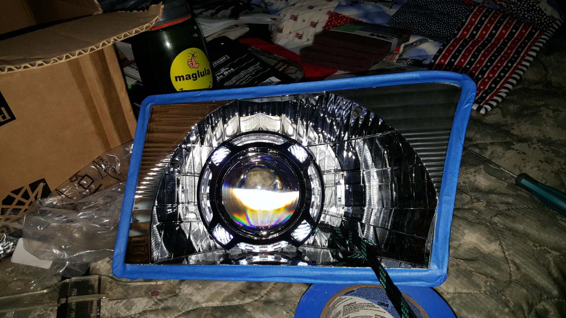

Well today I started on my projector retrofit, and we'll it's coming on great..... Except I'm waiting on replacement parts from the retrofit source. As of now I'm not a fan of them at all. So I made as much progress as I could with defective parts. Also got the headlights painted too. After that was all done, I proceeded to make some more progress on my f150 tank swap. Got the fuel level sender flange welded on and almost all parts needed to finish the swap. Just have to wait for some cash to order the last electrical connectors. Any ways only pics I have are of the led switch backs.

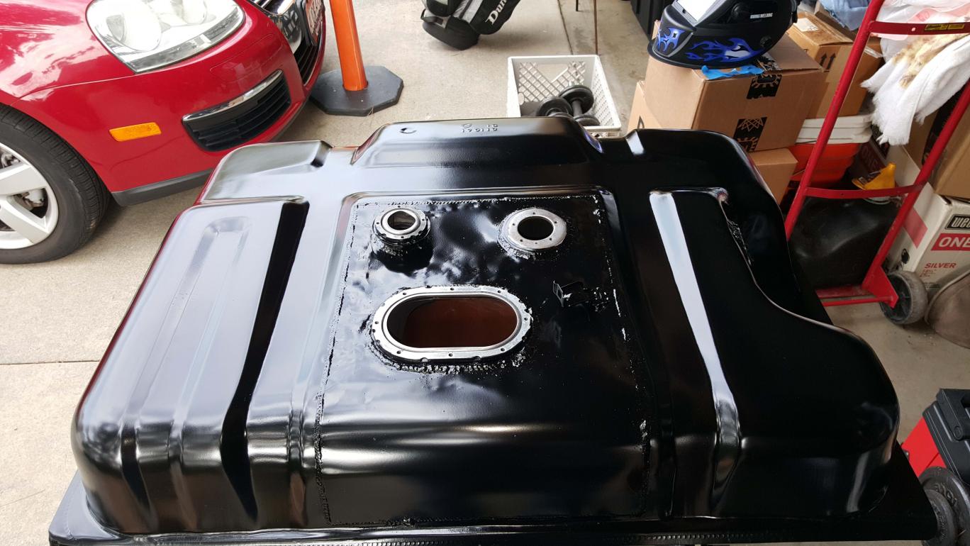

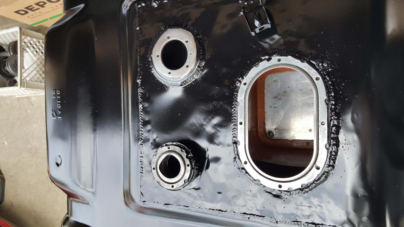

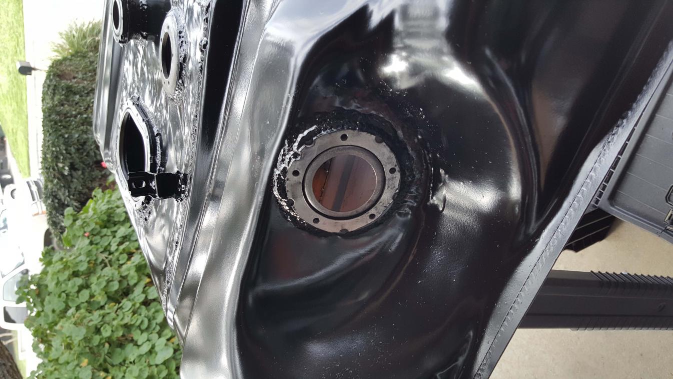

Well today I finished the work on the f150 tank. And boy I seriously hate welding sheet metal. Was able to pressure test it for leaks and only had 4 tiny leaks that were a quick fix. Running a modded 4runner fuel pump hanger, 4runner evap valve, 4runner fuel pump baffle and floatless fuel level sender. Will run a fuel level sender calibrator to get the sender to jive with the gauge. Truck side, I need to weld up the front mounts and re-route the exhaust and I can swap it in finally. Here's some tank pics the flange layouts kind of look like a face lol.

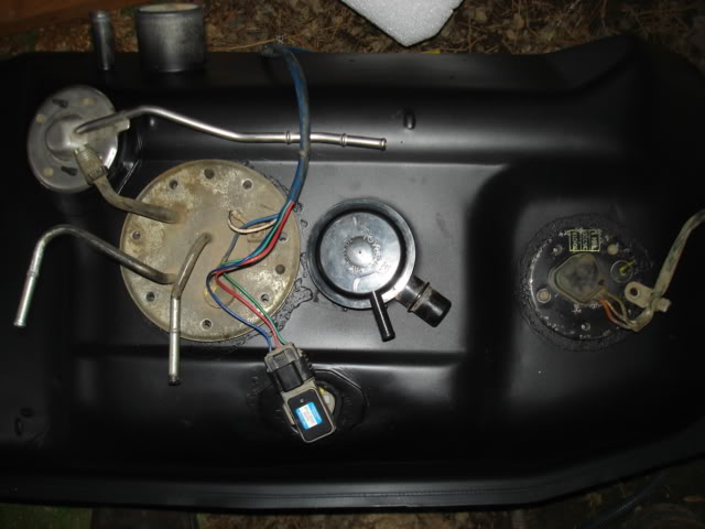

I remember this stage in my 88 Runner to 02 3.4 swap. Had to graft everything (EVAP sensor, EVAP tube, etc) except for the pump panel, just swapped pumps. I had the donor tank so I oversized cut the sensors and whatnot out of the tank, trying to retain the factory mounting...drilled holes, and pounded/contoured the cut flanges to the shape of the tank and soldered them in like sweating copper pipe (after prep of course) turned out well. You can kinda see the sensor at the bottom of the pic how it was mounted...

funny picture of fuel tank....watching SOLO with my grandkids right now...so fuel tank picture is fitting
