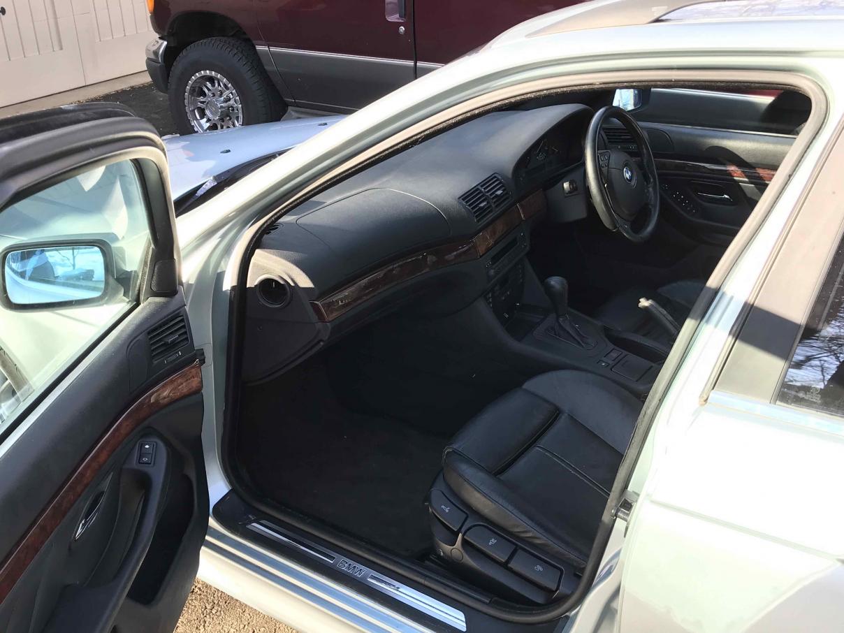

Those look like some manual BMW leather sport seats. Heres a picture of my BMW with the manual seats. If they are BMW seats the extendable thigh support and the side bolsters are what gave it away. They look great
