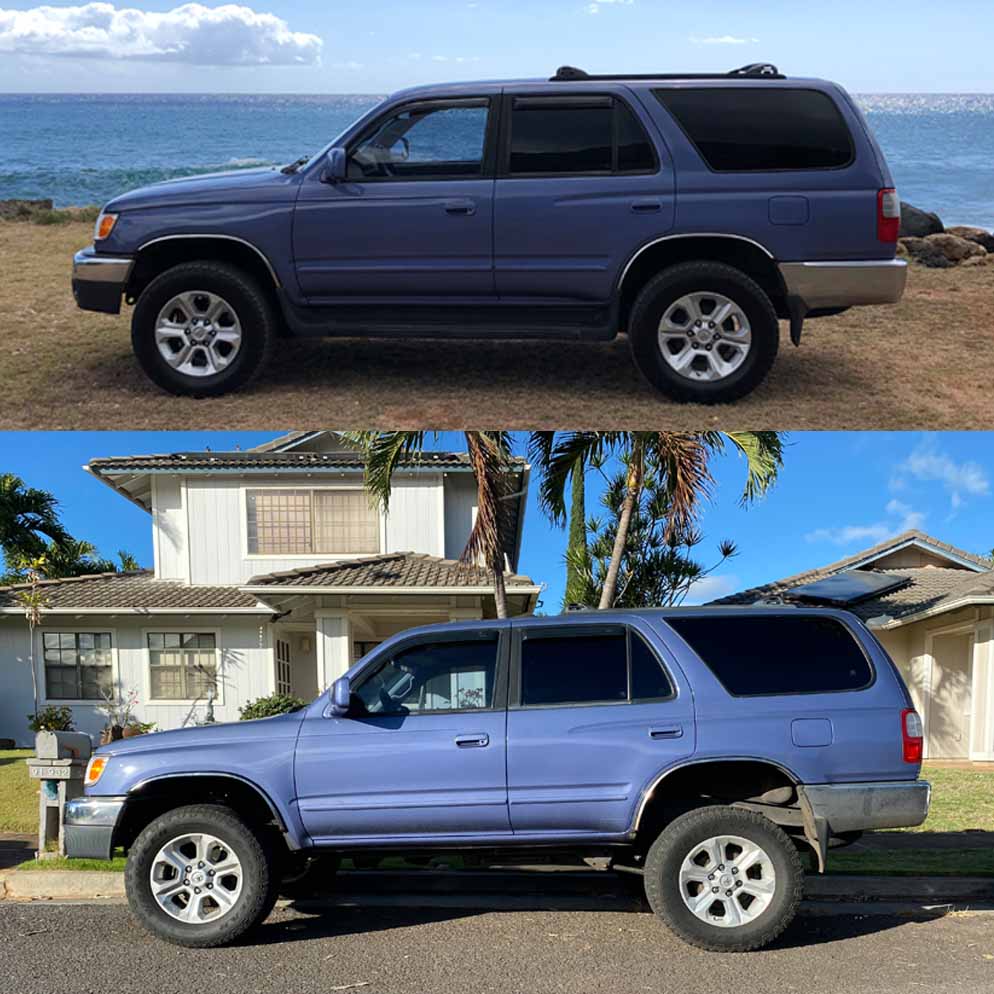

9 months after buying this 1999 SR5 I'm finally posting to this forum. I lifted it with SS 1.2 Currents (Radflo Coilovers) and feel it justifies a post lol. Bought the kit during SS's black friday sale, and had to wait a month for a friend to help me install it.
Was so stoked to install the kit that we forgot to take measurements of the height before the install... as a result I have yet to adjust the front height which is why the truck looks SUPER raked.
I'm waiting for the rear to settle so I can take a measurement of the rear height and adjust the front height about 1''-1.5'' below the rear.
Anyone know how long it'll take for the rear (tokico shocks/lc coils) to settle?
Or a measurement (ground to wheel well) of how high I should adjust the front coilovers?

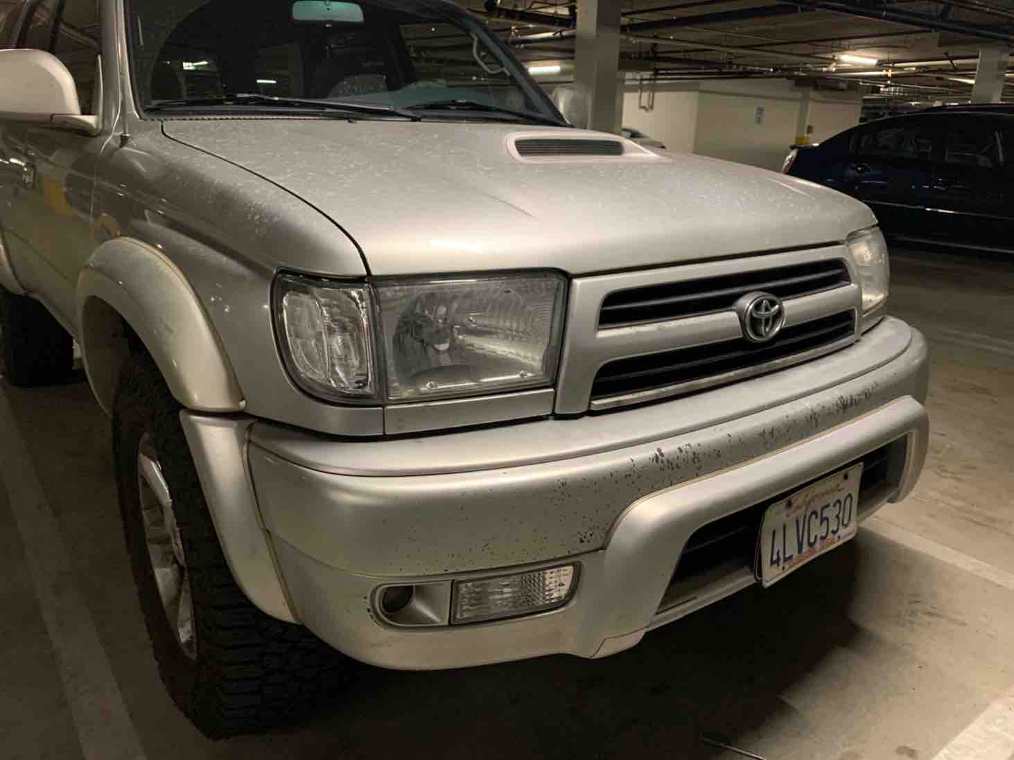

Finally got my clear corners and turn signals from Burtman Industries. The passenger side corner is a little off on fit but I can live with it fine. They look good and I'm now I'm looking for a less yellow looking light that's not too bright and hoping I don't get pulled over for it lol.
Also got my projector headlights and shrouds painted and trimmed down the housing to fit the projectors. Gonna wire up the engine bay soon but have to get done wiring to extend the length of the wires to reach the passenger side headlight.
Happy so far.

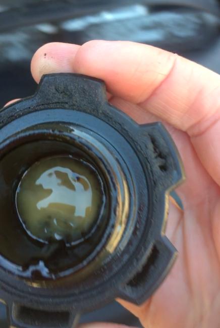

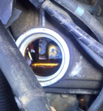

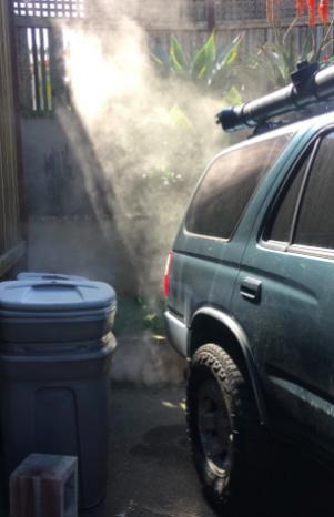

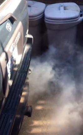

This is my first post, hope I am posting in the right area! Possible coolant loss, thick white smoke,
1998 3.4L 6Cyl 4x4 260k
About two weeks ago, I went to replace my front brakes/rotors and accidentally broke one of my hard brake lines, long story short, I had to leave the car for a few days. When I finished the job, I happened to notice that my overflow coolant cap was off, and the reservoir was empty. I put a great deal of coolant in, above the max line by accident. I just left it.
Now, I have seen white smoke in the cold mornings with a cold start before... but this afternoon, after sitting for a few days,... the car had thick white smoke. I let it idle for a few, and drove it up the block. Young guys in brand new audi yelled at me that my car was on fire, thanks jerks, I didn't notice my car sending smoke signals to the car gods, and unfortunate pedestrians!
I took it to a reputable mechanic about a mile away, it sat overnight. The next day when I spoke to one of the guys he said they couldn't recreate my problem! In fact, it passed smog that same morning (including visual!!!)! He did tell me that my coolant was about a pint low. I told him I had filled it and he immediately told me it was the HG (without diagnostics), told me it could cost about 2700$ to repair.
BTW I am a blonde female in my early 30's, not sure if that attributed to diagnosing a HG that quickly...
I left the car nearby and borrowed another car while I tried to figure it out.
My Symptoms:
- White, maybe blue smoke on cold start
- Lots of water dripping
- Smells burnt
- No overheating
- No misfire
- Engine Oil is at normal level, TINY amount of milky residue on cap, but otherwise oil was at normal level, didn't appear milky, or watery... (Oil change was performed recently, last few hundred miles)
My attempt to diagnose:
-Engine Block Leak Test: Stayed Blue
-Today, I added one bottle of Rislone Ring Seal Repair: Ran for over 40 minutes, took to a different mechanic, he saw O rings out of exhaust, did blow by type test at exhaust with dollar bill, but not sure what that result was, saw oil residue I noted and I said it was a small amount, so he let it be, he said to drive the car and hope for the best. (Maybe I am too much of a pain in the ass, no mechanic wants to deal with my Google searches)
-Added UV dye to Radiator: I don't have a garage, I made a black light flashlight, and have some old yellow glasses, I am going to look now that it is dark...
What I would like to do:
-Radiator Compression Test
-Seafoam
Thoughts?

This is my first post, hope I am posting in the right area! Possible coolant loss, thick white smoke...
Can't help with a keyboard diagnosis- my head gasket fail had sudden very obvious symptoms of missing, sweet-smelling white mosquito-fogger exhaust, a fair amount of white goop on the dipstick and in the oil cap, definite coolant loss, and latte oil- but wanted to say howdy anyway.
