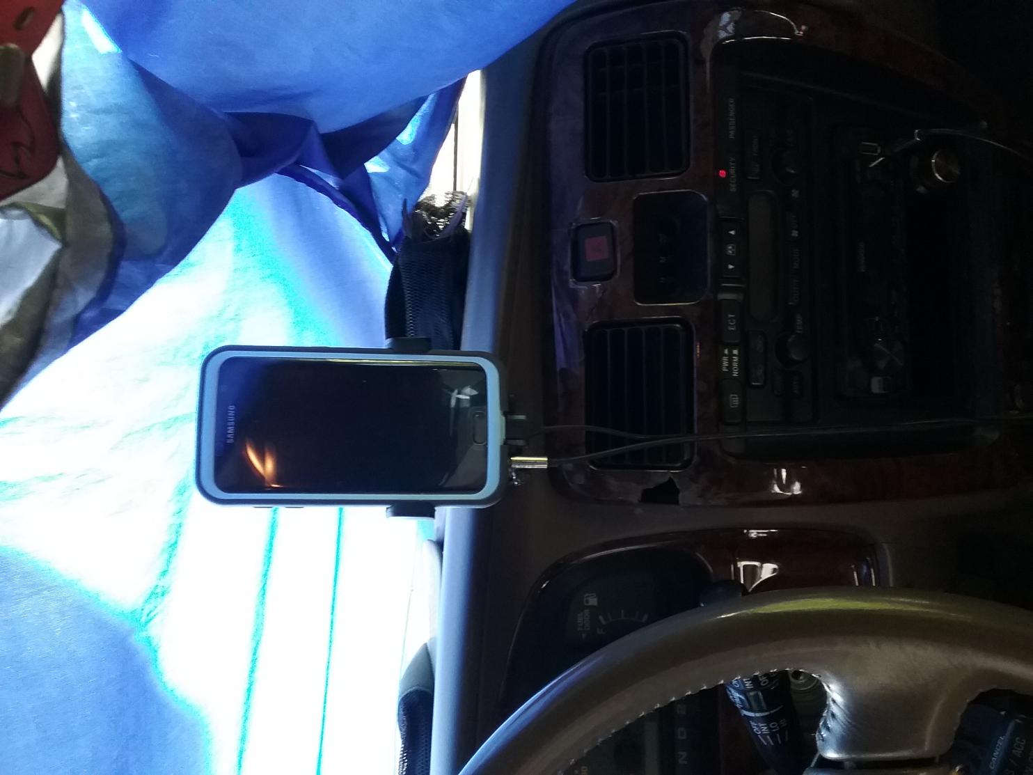

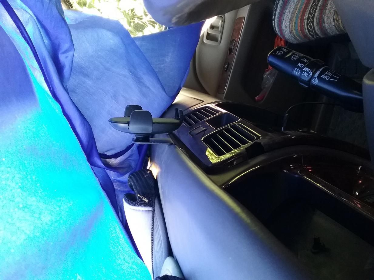

Homemade custom cell phone mount...no more bouncing out of the holder while offroad:thumb:

Use a small piece of steel. Cut and angled to match contour of dash. Drilled a hole through it and modified a cell phone holder to run a flat screw through its back plate and secured with a nut on backside of the plate. I initially used Velcro to attach to dash but moderate offroading with weight of phone cause it to fall. So now I've removed Velcro and attached plat to dash with small screws.

Very nice! I had the same design idea, but was trying to avoid drilling through the dash. Does it seem strong enough to support the phone with just screws in the dash (I assume the plastic part of it)? I was pondering using some type of inserts to make it a bit stronger.

The phone mount has a rubber washer between it and the plate. Flat lock washer between the screw and internal part of phone holder. Cap screw nut on back side. The rubber washer dampens vibration and any rattle noise. Haven't tested it off road but have driven like a maniac in my neighborhood (hitting pot holes, driving up onto curbs, etc) so far so good. I also put my phone in the holder before installing it and shook and threw it around and it held the phone the entire time. Won't be able to hit trails for a week to really test it ( maybe longer if my UCAs come in, I'd really like to get rid of tire rub).
This phone mount has a rubber back and feet that hold the phone. The side arms are pressure fit and have an angled hug like hand on each side. Small button on the backside spring releases the arms to remove phone.
