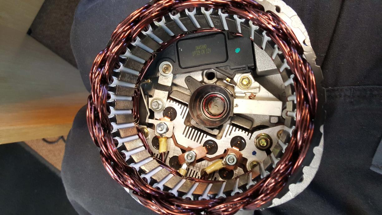

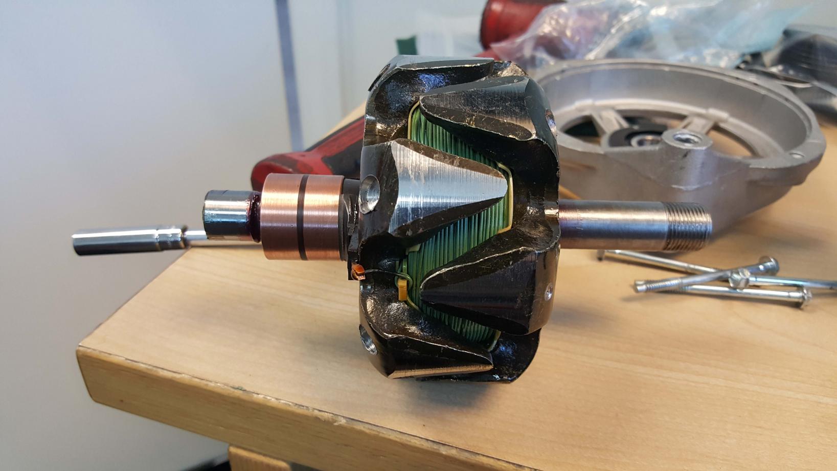

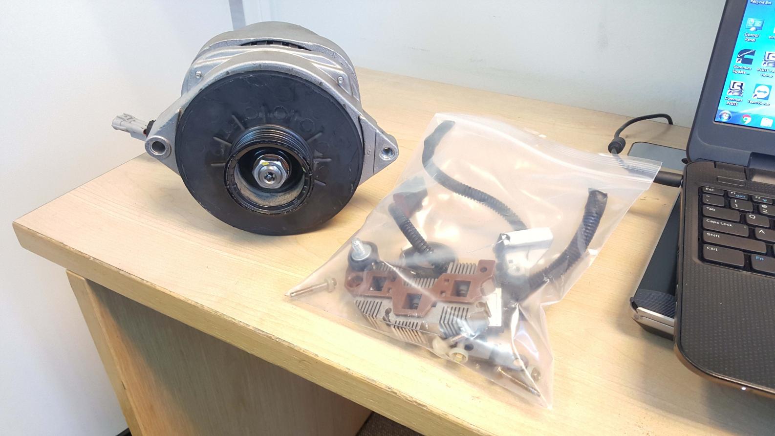

Just finished rebuilding and upgrading a cs144 alternator. Bumped it up to 200 amps, now just need to have it tested to make sure I didn't mess anything up. Was actually really easy, just unbolt and reinstall and 2 joints needed to be soldered. The rotor was shot so I scored a NOS rotor that was the early style but just a quick swap of rear bearings and it's all good.

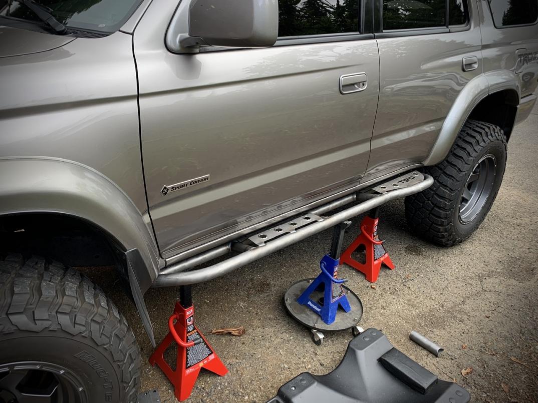

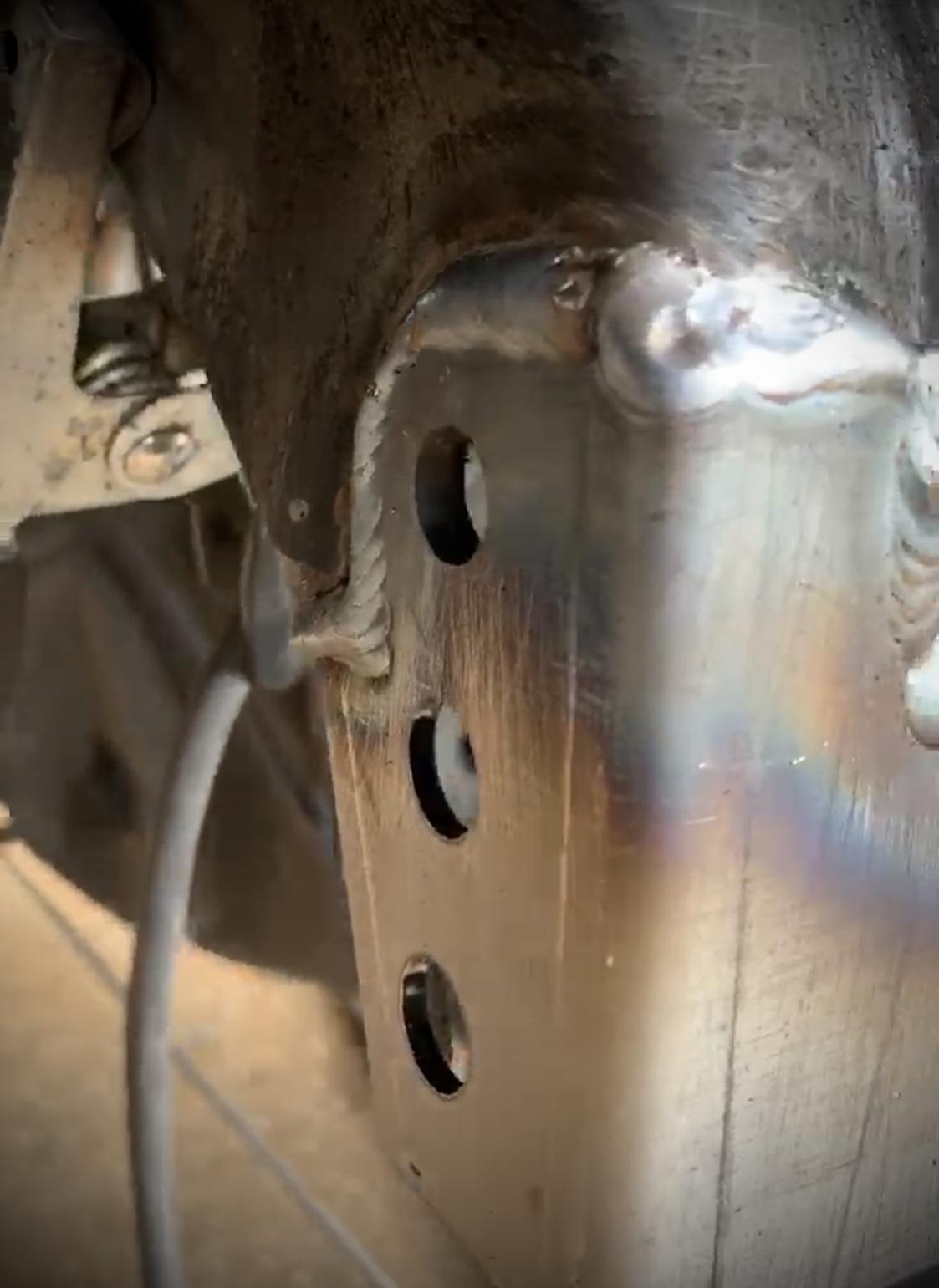

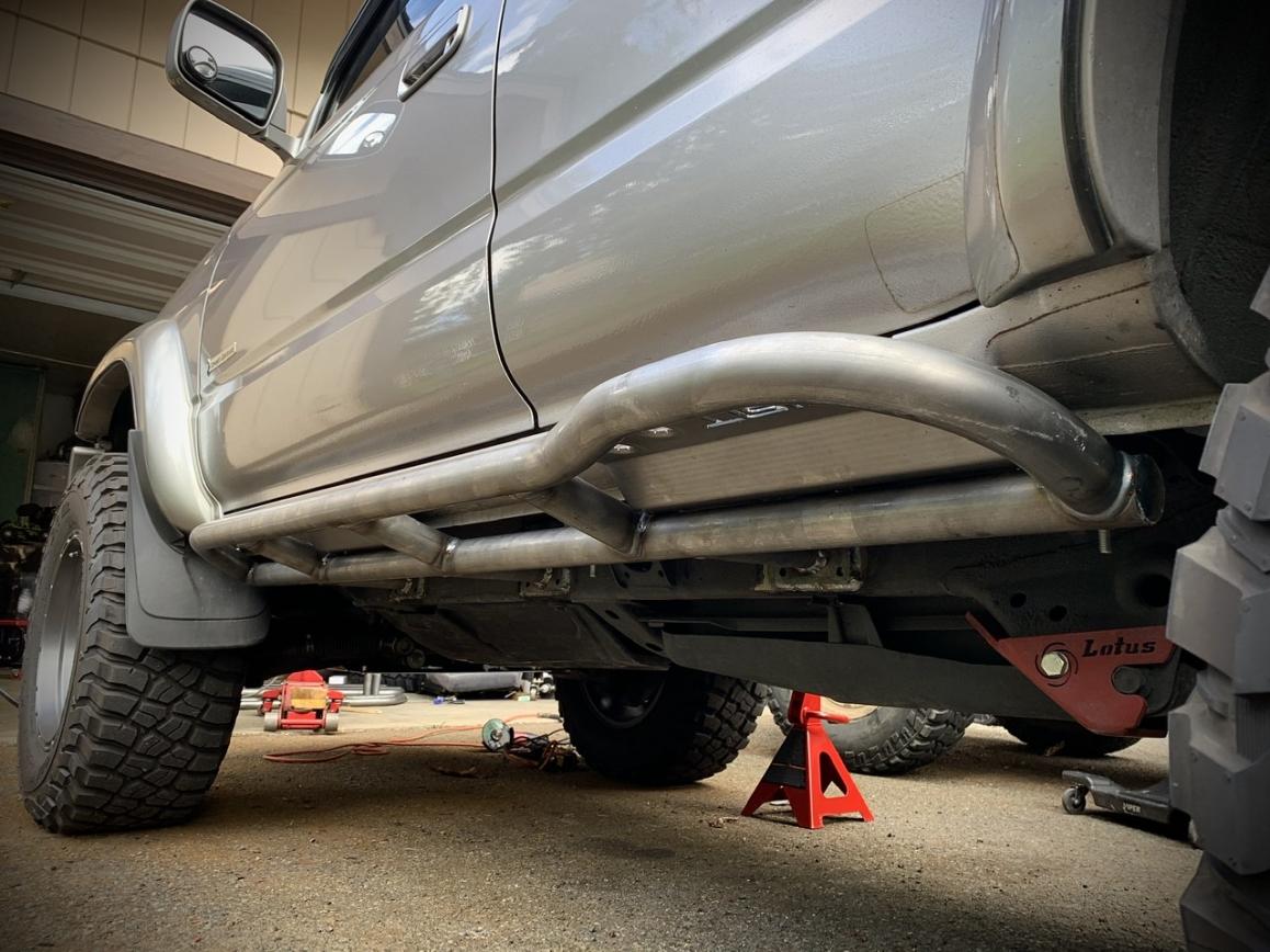

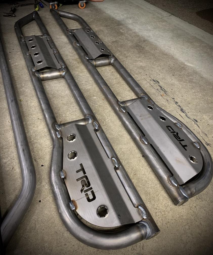

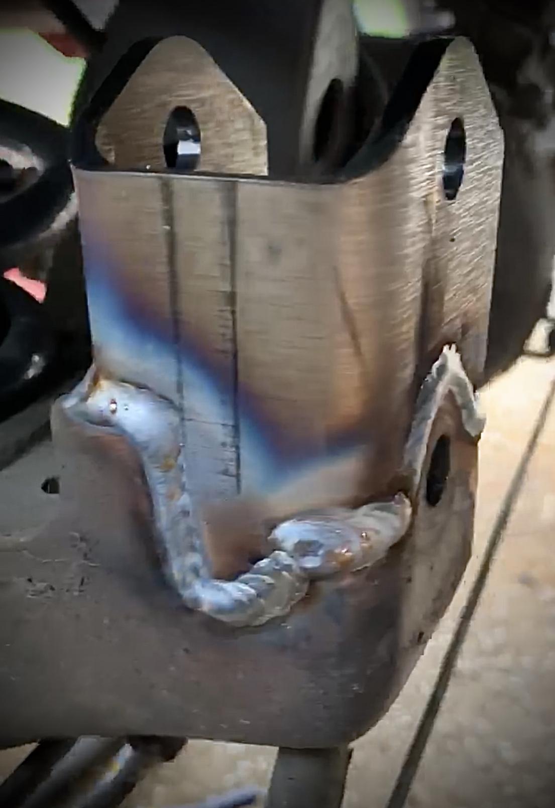

Integrated metalworks in Renton installed 4xinnovations weld on sliders and eimkeith panhard correction kit this weekend.
