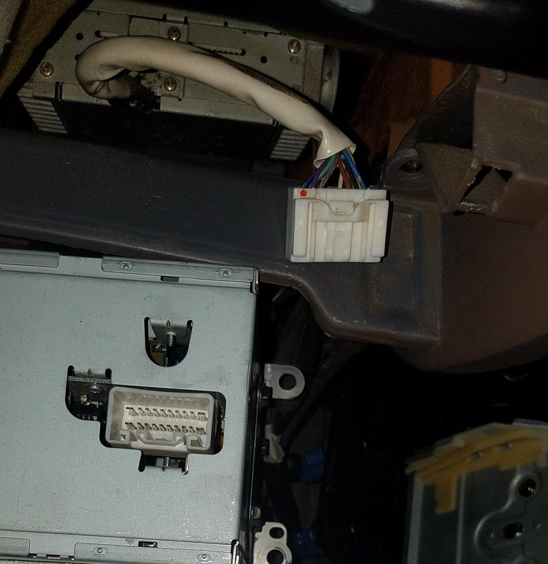

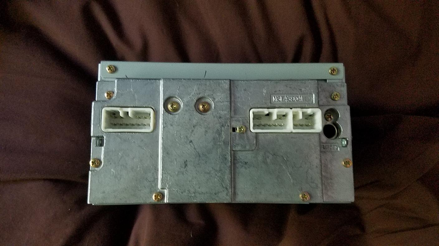

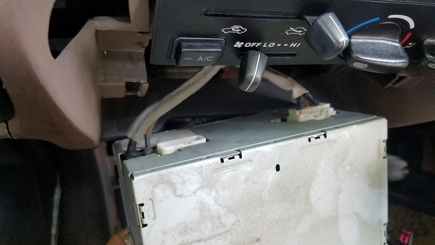

There wouldn't happen to be a way to connect an 01-04 Taco radio to our 4runners, would there? I assume not as we use one plug and two antennas, whereas the Taco used two plugs but one antenna, but thought I'd ask before I went ahead and sold it

No, we do not. We have two PORTS, and one plug. The Taco radio has three, of which two are used when the stereo is installed. The free spot is the same connector between both units (and on opposing sides).

Pull out the factory external amp and see if the two plugs that go into it fit.

Ah. The way you worded it confused me. I thought you were saying we had a single antenna port. Like the other poster said the factory amp has 2 plugs going into it and only the one coming out to head unit. Try what he said

I actually don't have the factory Tacoma plugs, if that's what you mean, but if someone here knows where to get one to try I'm all ears

I do not mean that. The factory single plug should lead you back to a small box/amplifier bolted back behind the radio opening. If you remove that and unplug it, there will be two factory plugs back there. When you install an aftermarket radio like most people here have, you need to remove and discard that amp to plug in the harness.

Oooh, so you mean remove the amp itself and check the connections behind that? That makes more sense if so, and after watching this video it doesn't look like they have one, so might be worth trying!

That may be what you need to do to get it done. When I replaced my radio, I also got an antenna plug adapter to combine the antennas. I used this one, but since I did it about 7 years ago, it doesn't appear to be available from them Amazon.com: Antenna Y Adapter 1 Plug to 2 Jacks Motorola Type: Home Audio & Theater

Good to know something like that exists, I figured there had to be something. Thanks, will try again maybe tomorrow or wednesday
