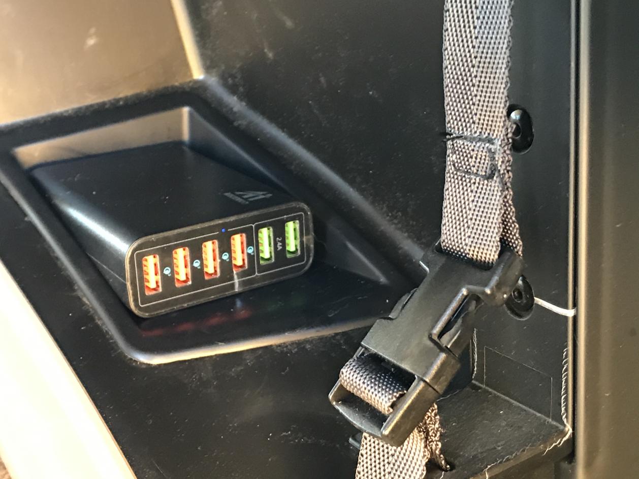

Put a multi-port USB charger in that funky storage compartment in the back.
I hunt with dogs using GPS tracking collars on them so I figured this would be a great place to charge the collars and handheld unit. There are times I’m charging 2 collars, the GPS handheld, my cellphone, 2-4 walkie talkies, and a ham radio. It’s looks like spaghetti up on my dash. (I usually just toss the stuff on the rear floorboard with all the cables going back there...)
Now, no more. I can do most of the clutter stuff back in that little compartment!

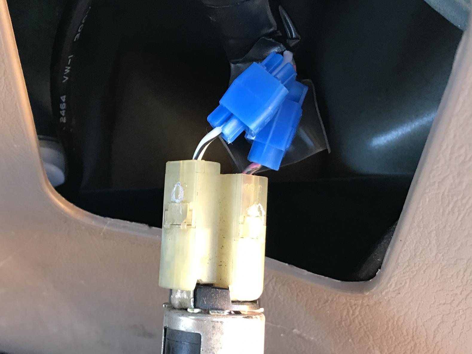

I clipped off the cigarette lighter plug and tapped into the power outlet. That eliminated the fuse but I figure it should be okay. The nice thing about this particular hub (besides the nice fit) is it defaults to “on” when you power it up. No need to turn the switch on the unit.
I wish I had taken a couple more pics but it’s pretty self-explanatory...
I drilled a hole so the power plug could plug into the hub and ran that cable through the inner panel to the power outlet wires. Used those wire taps and snapped it all back into place, done

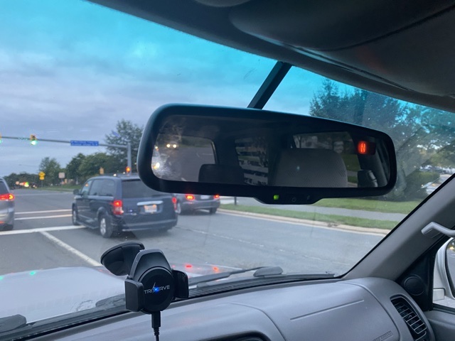

I did my rear view mirror installation . Self dimming and with a compass. Very happy with it
