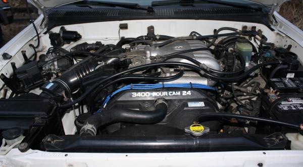

Got under the hood and replaced about 8 or 9 vacuum lines with new silicone ones and new clips. Also did the radiator overflow hose and new clamps.
I am hurrying to get all this done before the weather changes. I am working outside with all this.

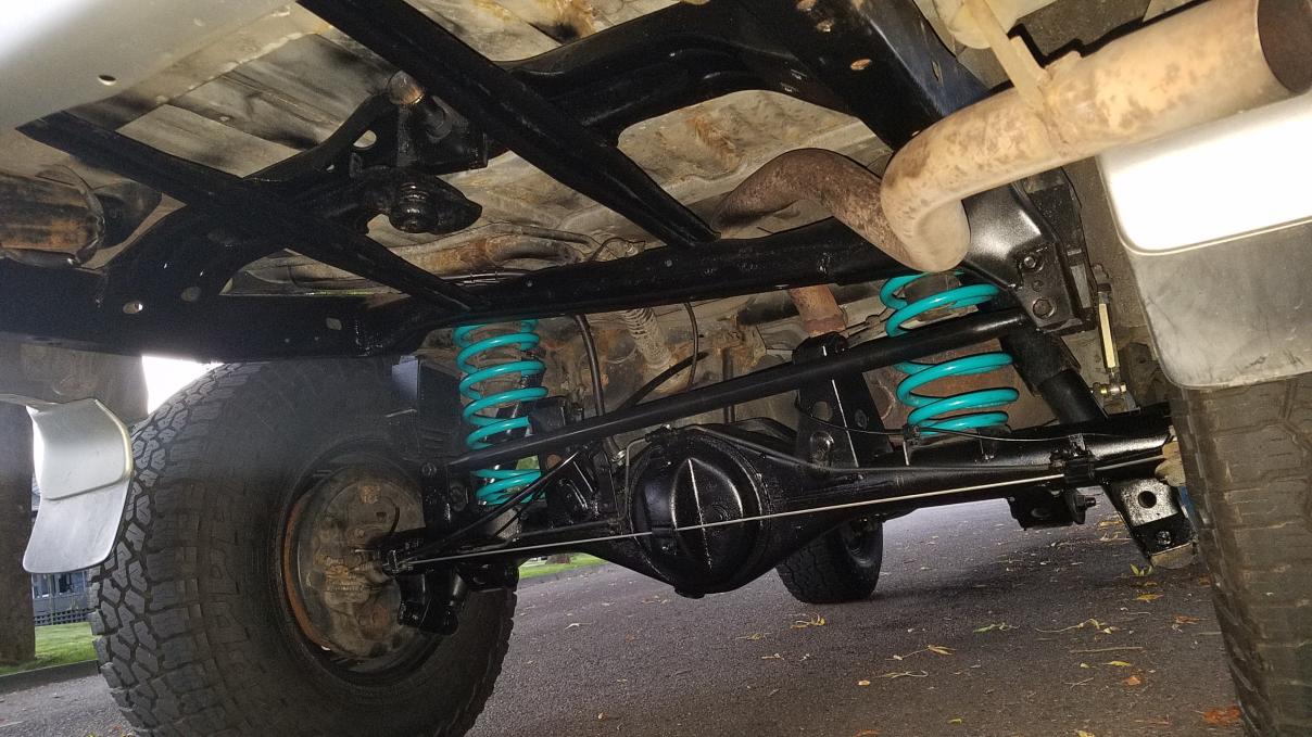

Was started with getting rid of what very little rust I had on my frame/axle turned into touching up all of it. Exhaust is definitely next. Got a little nozzle coming to get some spots inside the frame too since I noticed some orange poking through the holes but it's pretty sparse, worst of it is pictured above the tailpipe actually
Hit it with a wire brush and scraper, 2 coats of rust converting primer, then 3 coats of farm paint (on top of the loads of good paint already there). Front and back side, but didn't feel like doing the bumper mount since it will be tossed eventually for a tire carrier, and outside of frame is near perfect
Little overspray here and there but it won't be noticeable with a nice coat of mud - doesn't have to be pretty, just has to work :artist2:

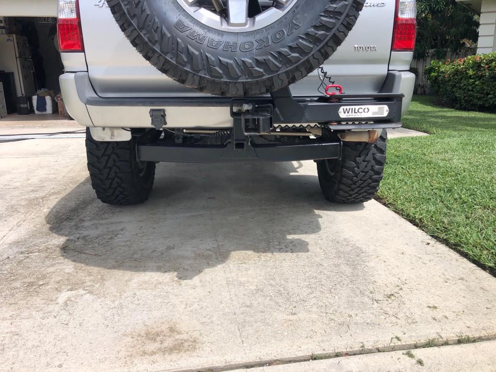

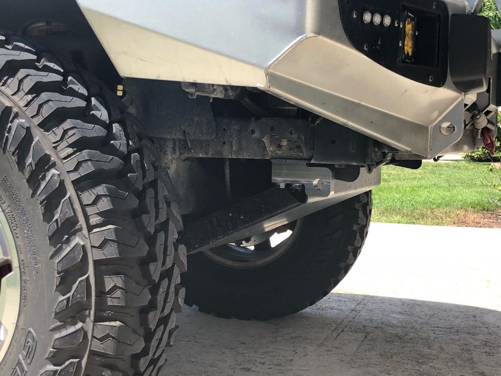

We are prepping for GSMTR 2020 in late October. There are things I’d wished I had done a while back but better late than never.
4crawler Recovery points
Then I flipped my hitch (cut & weld) to get the swing out higher off the ground.

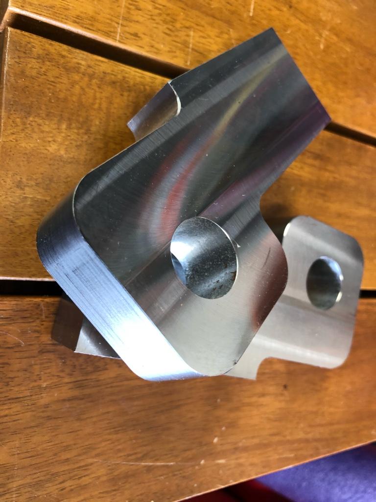

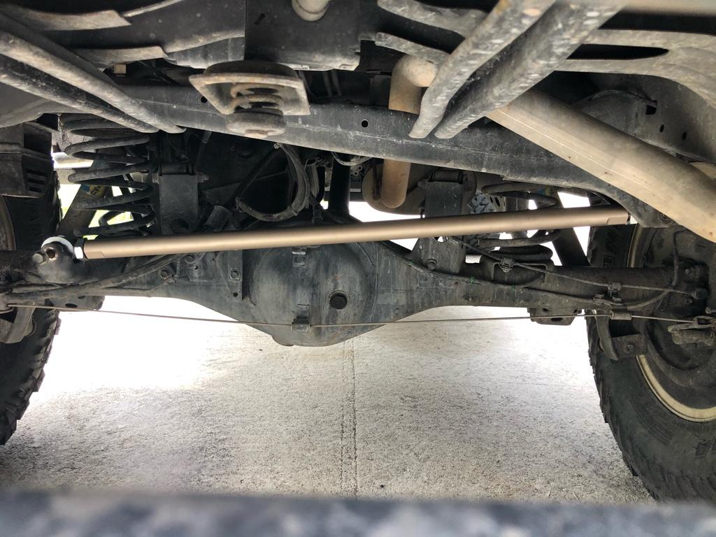

A new panhard from Front Range Off-road paired with Eimkeith Panhard Correction Brackets. (Photo is pre correction)

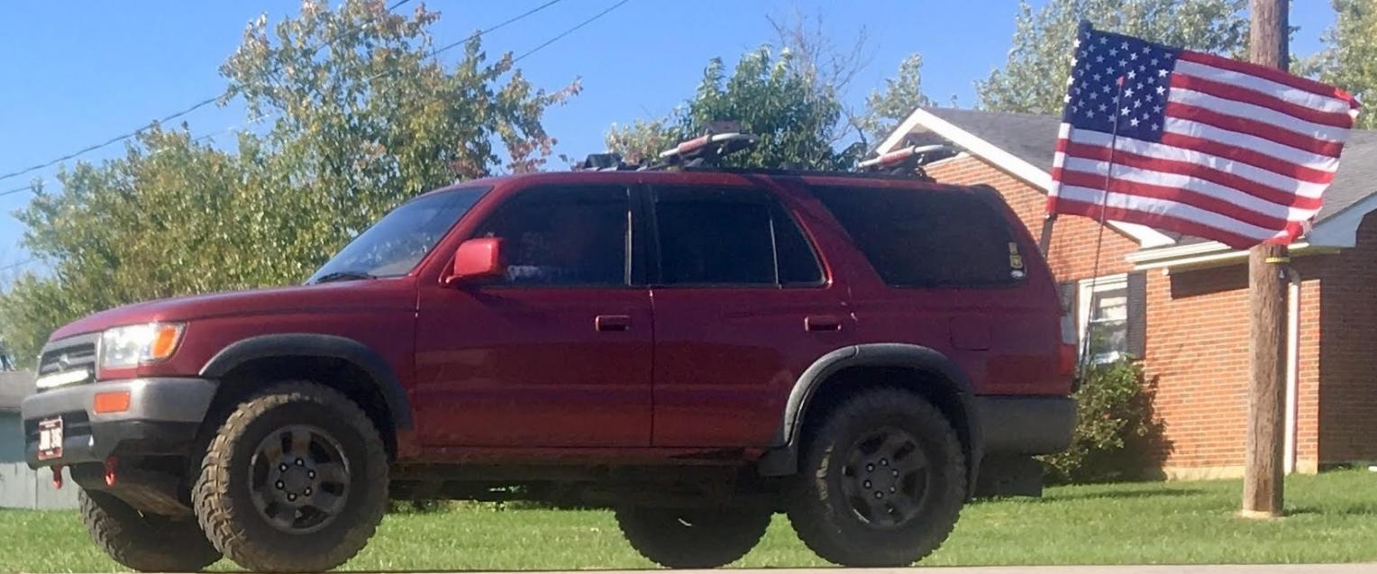

Roscoe on the move - with USA Flag
I've been wanting a way to fly Our USA Flag for a long time. Got this from "Drive a Flag". Excellent quality. Removes quickly. Flag flies well at 55 MPH.
I think it would do OK at Interstate speeds too.
.....and I finally figured out how to attach a pic. All I needed was some time...

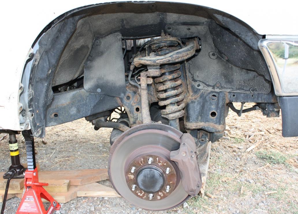

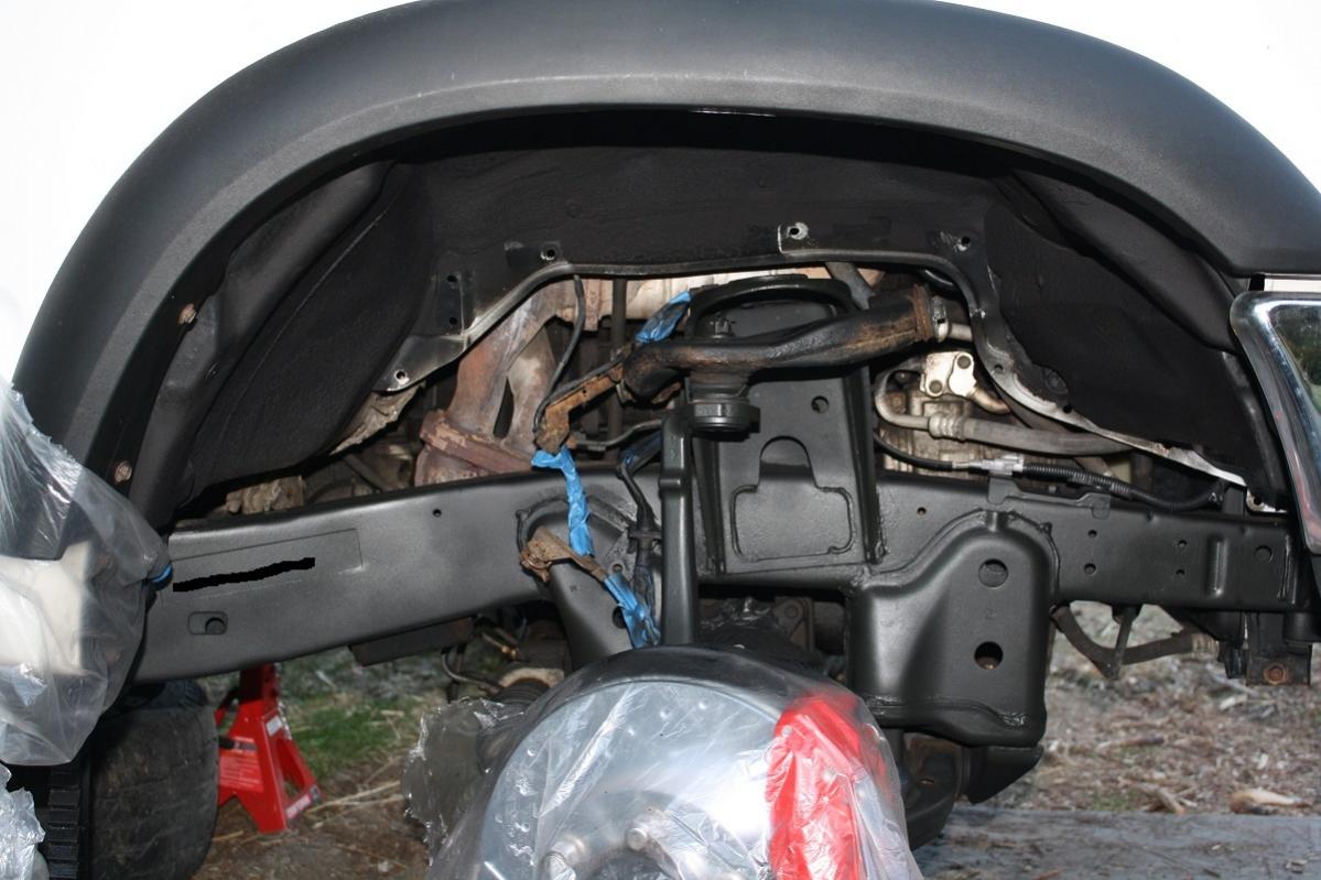

Kept on going with the rust control up front. I don't just shoot it with a spray. I have a process.
Wire wheel on a angle grinder to get the big stuff.
Cordless drill with a wire wheel to get into a bit smaller areas.
Dremel with a little wire wheel.
Hand brush with a very stiff wire brush.
Clean with soapy water then simple green.
Mask off a bunch of things. I hate over spray and that everything coated look.
Do the wheel wells with Duplicolor brand undercoat.
Do the rusty things with Rust Reformer from Rustoleum.
Matte black paint to finish.
I like the way it is coming out. I have 1 more well to go. JBA UCA's are in Thursday so those will spice it up a bit along with those new coil overs and Tundra brakes!!:whoo:
First shot is where we started, second is where we are today!! Cannot wait to get the rest finished up and see how she sits after all this.

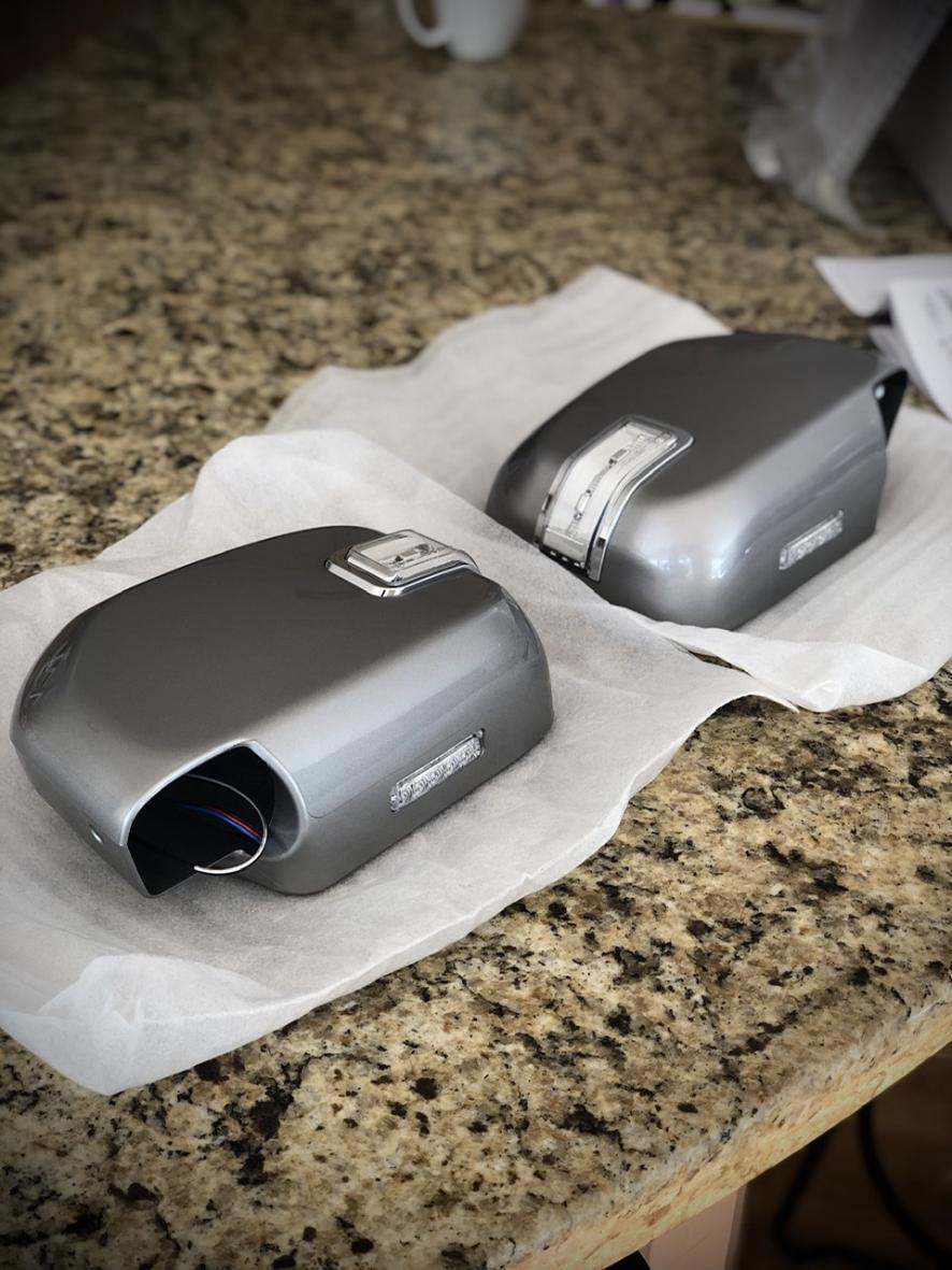

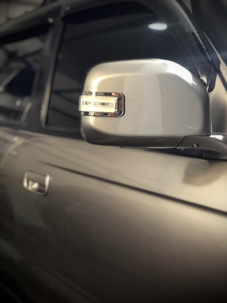

Attempted to install LED mirrors today... 3h later and a bunch of cuss words the passenger side is on, albeit not yet wired up. The screws holding the internals in are super soft and held in with dabs of lock tight from Toyota. In addition, need to cut OEM harness to get the wires through the grommet and solder back together. Will tint the lenses smoke xpel ultimate when everything is done.

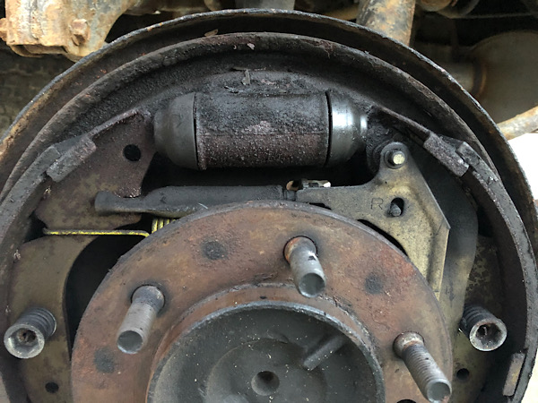

Baby steps
Removed passenger drum on new 2000 SR5.
Even has some brake shoe left. And a bit of rust.
Betty never ceases to amaze me.

I really like those!
Those three screws are a PITA to get out for sure. I have found that using a real JIS screwdriver rather than a Philips can make a big difference. All the "Philips" screws on our trucks are really JIS which is a non-cam-out design unlike a real Philips.
You probably already know this but info for others reading!

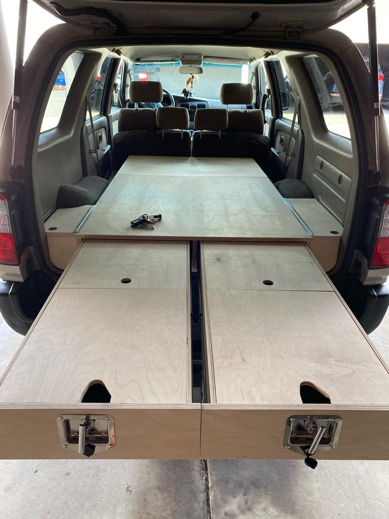

Shout out to Solid Wood Worx for the sleeping platform and slide out drawer system super sick!! Can’t wait to put this to use!
