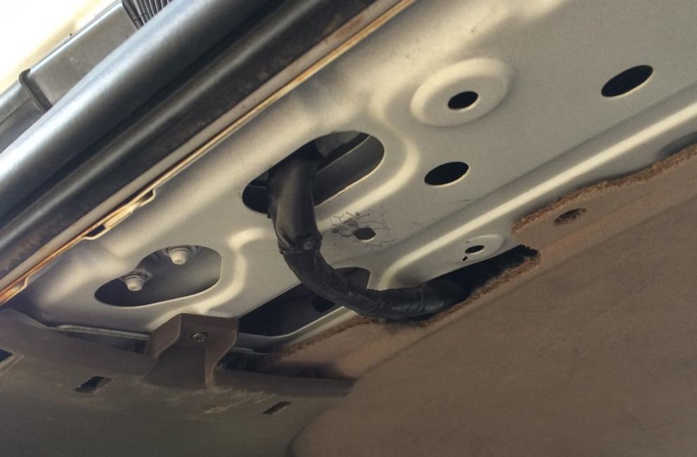

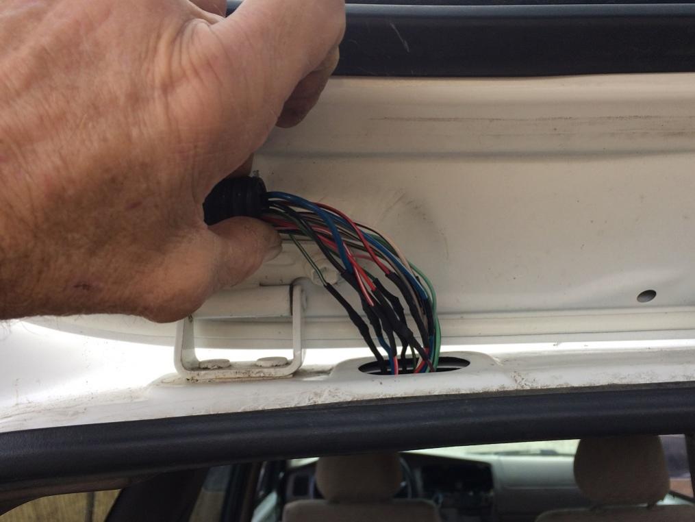

Posted a couple days ago about many wires being broke in rear hatch interchange area. Had 6 broken wires and 4 that were bare...:banana: Rear defrost, plate lights, 3rd brake light and wiper were non functional yo.
Glad to say after today we are back to fri-kin-mint. I soldered all 6 breaks then shrink tubed them. Just gave the worn ones a wrap or 2 of tape and good to go. I had to remove the back plastic trim around the rear light. That gave me access to the underside of the wire loom. I pulled out a holding clip and stripped back some insulation to give me some wiggle room. Went at it with the strippers, solder gun and shrink tube and it came out great. I work best in tight spaces anyway...:boink:
The clip inside was a total PITA to get out. I scratched the heck out of the paint there. I am working outside in nearly freezing temps so that did not help but a little embarrassed of the damage I did. I normally am way better than that but got impatient. None of it will be seen but you know...other than that I am very happy to have that done!

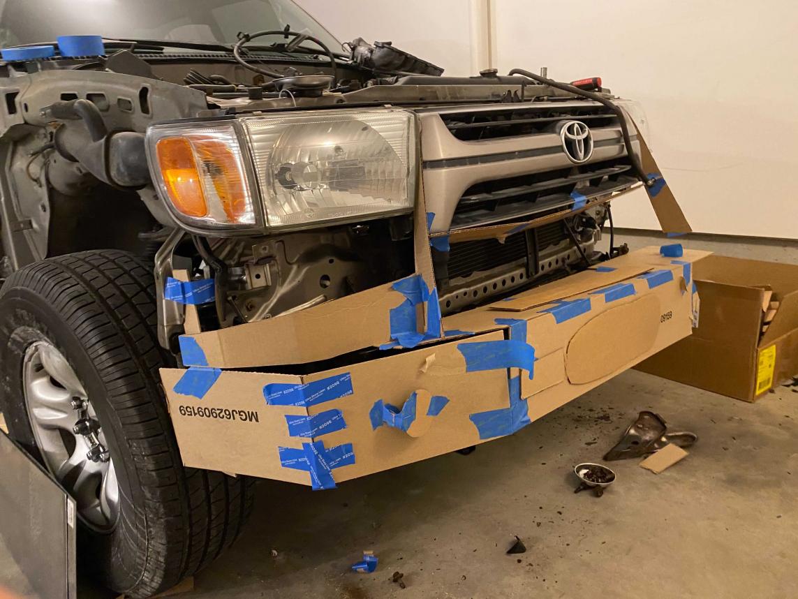

Designing a new customer front bumper for my 3rd gen! Who else has done their own fabrication on a 3rd gen?

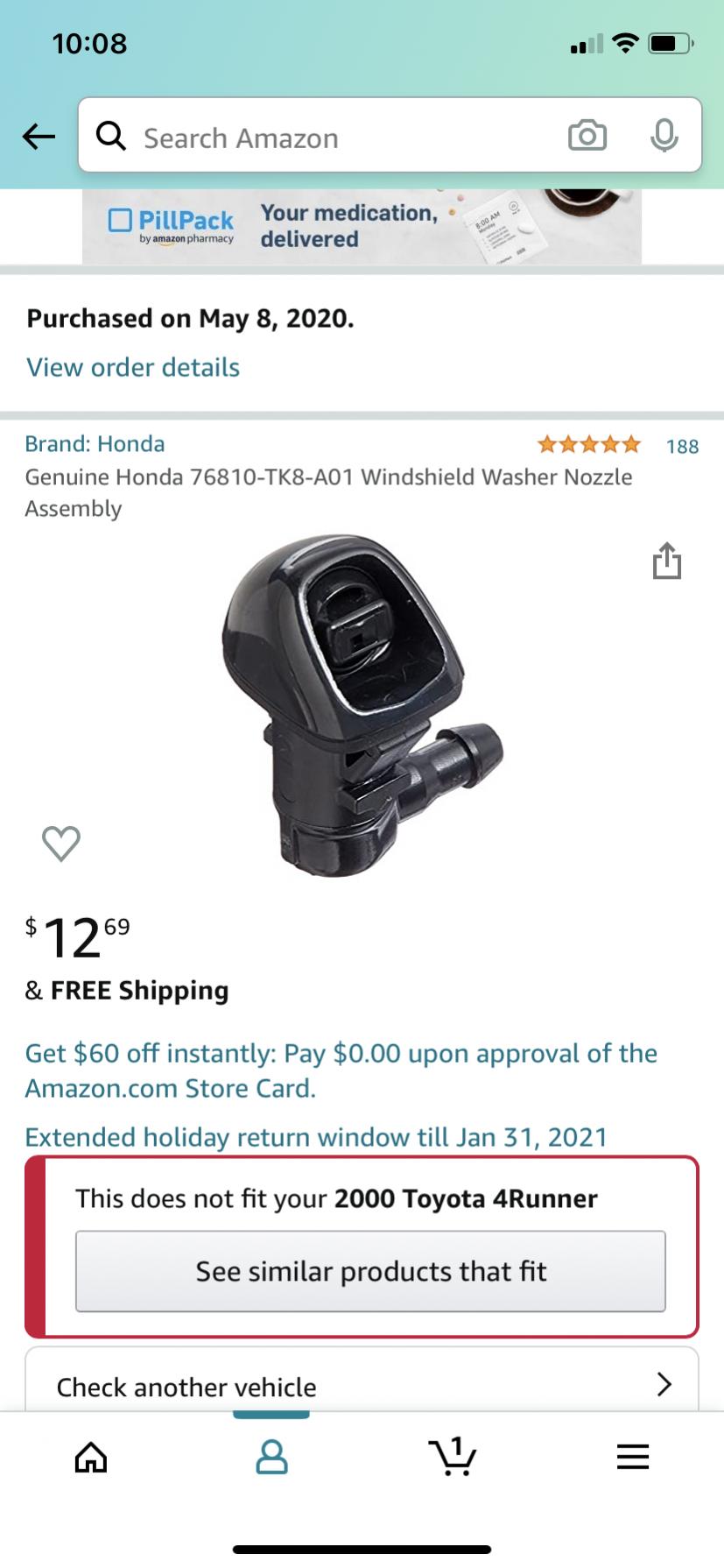

Fan spray pattern washer nozzle upgrade. Tried the 3 hole spray pattern ones from a RAV4 and was just never happy with the pattern. These nozzles come from Honda and are a direct replacement for the factory nozzles. Hardest part is squeezing the clips to get the old ones out, then taking a couple minutes to aim them properly.
Honda part number: 76810-TK8-A01

You know, I've thought countless times how the spray kinda sucks, but it never once crossed my mind to change out the tips. Might give this a go!
For the $20 or so that it cost, and how easy it is since they're a direct fit, it's definitely worth it. I was never really happy with the crappy job the stock nozzles did in the winter with snow and ice on the windshield, these should be immensely better.
are these the ones? saw a couple different ones on google at first glance

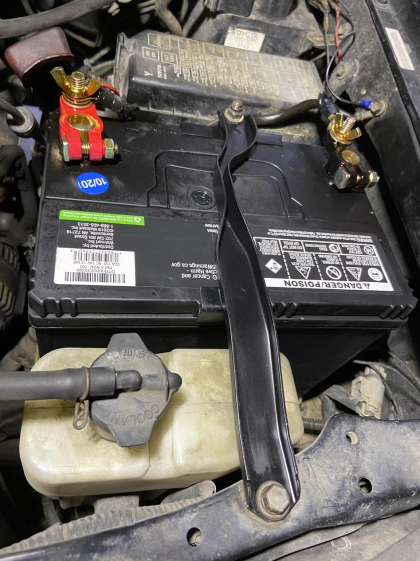

Alternator was intermittently charging, and gave me a dead battery while running errands. Grabbed a brush holder from the parts store and even though my old brushes were trashed, it didn’t solve the problem so I grabbed a parts store alternator from O’Reillys. I’ll probably eat the core charge and have my Denso rebuilt locally soon.
I also got a free group 24F Everstart Maxx battery (mine was still under warranty at Walmart for a couple months, $100+ saved there). Also my negative battery post terminal was not tightening all the way so I took the opportunity to upgrade to marine terminals and coated with Noco NCP2. I wire wheeled and painted the battery hold down since the paint was trashed and the metal showing had corrosion build up, and welded a couple pieces of 3/16” plate steel on the hold down brackets since the new battery was narrower than the old one. Same mfr and group size, so it was weird that they made it smaller. Also went from 750 to 700 CCA :noidea:
