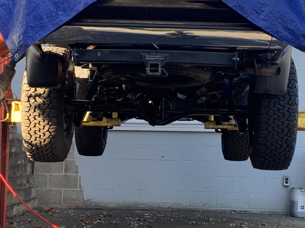

Man, sorry to hear that. That’s a shame. Hope you are ok, guessing the elk is not. My new to me 4Runner has never seen salt but certainly will be in its new home in Pennsylvania. Full oil undercoat with NHOU. One pic of rear differential attached

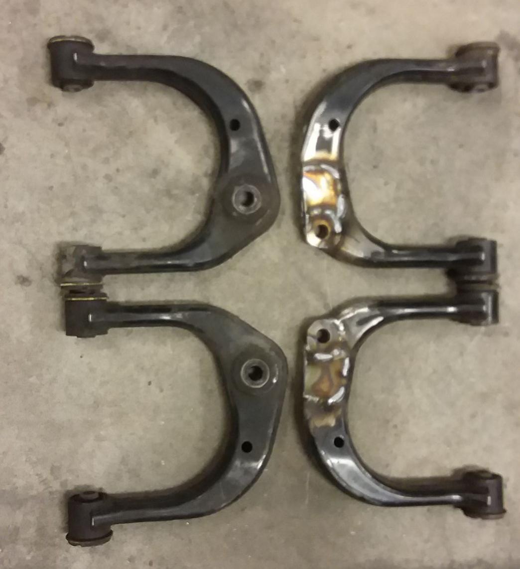

Sorry to hear about your situation. Sounds like it could have been worse. Im sure you’ll find a good shop. Today installed SPC upper control arms and brake fluid flush.

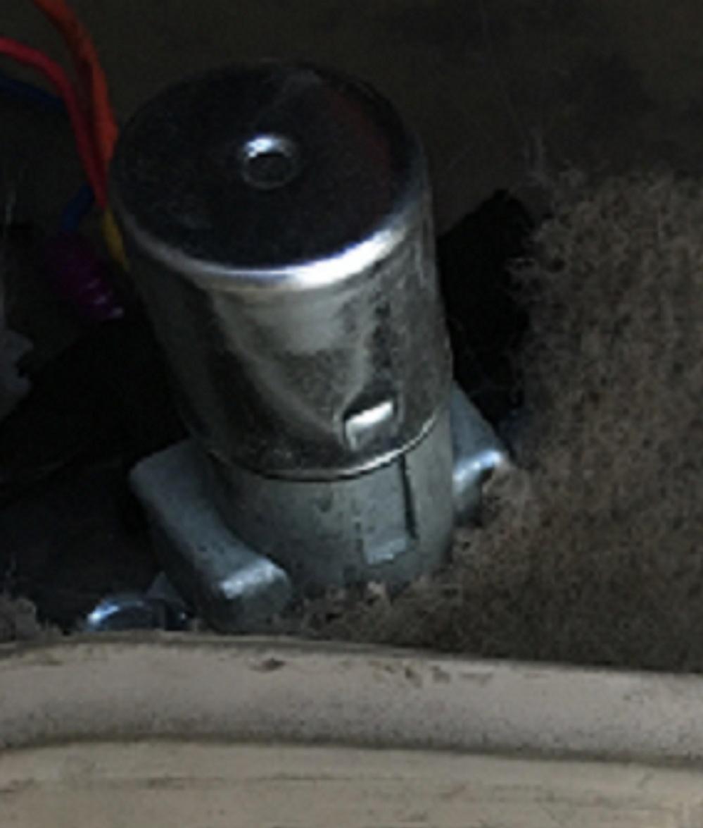

"Old School" foot operated dimmer switch
My Sweet Wife gave me a nice 30" LED light bar from Tractor Supply a couple years ago. I mounted it on top of the front bumper back in the grill. I removed the bottom part of the grill so it mounts flush. A really good light.
I use it frequently at night on little country roads in Kentucky. Obviously I switch it off when I see headlights which brings me to this mod..........The "old school" cars & trucks had the dimmer switch mounted to the floor (showing my age). That always worked well.....SO.....I got one at the auto parts shop and installed to switch my light bar. Just had to trim a small semi-circle of carpet and it fit great. Wish I had done that when I put the light bar on. SO HANDY!

Foot Switch continued
In case any of Y'all haven't seen one of these before - commonly found in cars before the mid 1980's......

The old dimmer switch on the floor was so nice, need to put that one on the mod list after I get this last mess finished. How useful, to have it control your lightbar. Good one.
The "old school" cars & trucks had the dimmer switch mounted to the floor...
Had one of those on my 52 Chevy truck, you just hopped no one was coming downhill while you were double-clutching to go up hill. :D But even my '66 Beetle has the dimmer on the turn signal stalk.
As for your lightbar, I would have personally used a trigger wire from the high beams to a relay to power the lightbar. Not like you'll ever use it without high-beams and that makes it 1-switch to dim everything vs the 2-step shuffle of hitting the floor dimmer and light stalk.

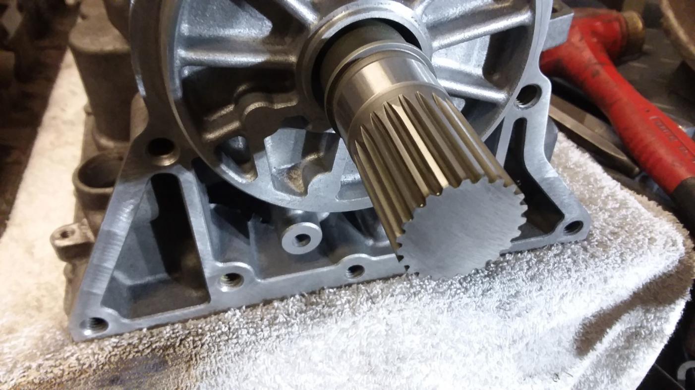

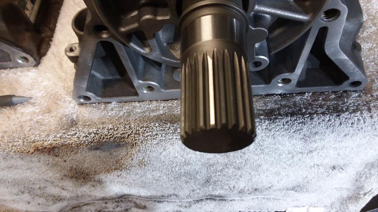

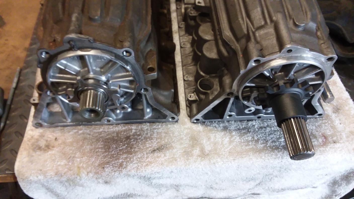

With the help of a local toyota/Suzuki builder who has a shop and some welding skills. Got my 4x4 tranny/tcase in. Trail gear crossmember tcase skid plate welded up to frame... now to start building a front axle.
Also thanks to [MENTION=78895]DeathCougar[/MENTION] and [MENTION=107222]HiLife[/MENTION] for coming through with some parts I couldn't find locally.
