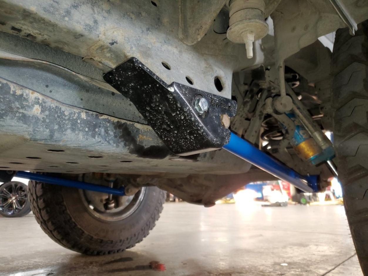

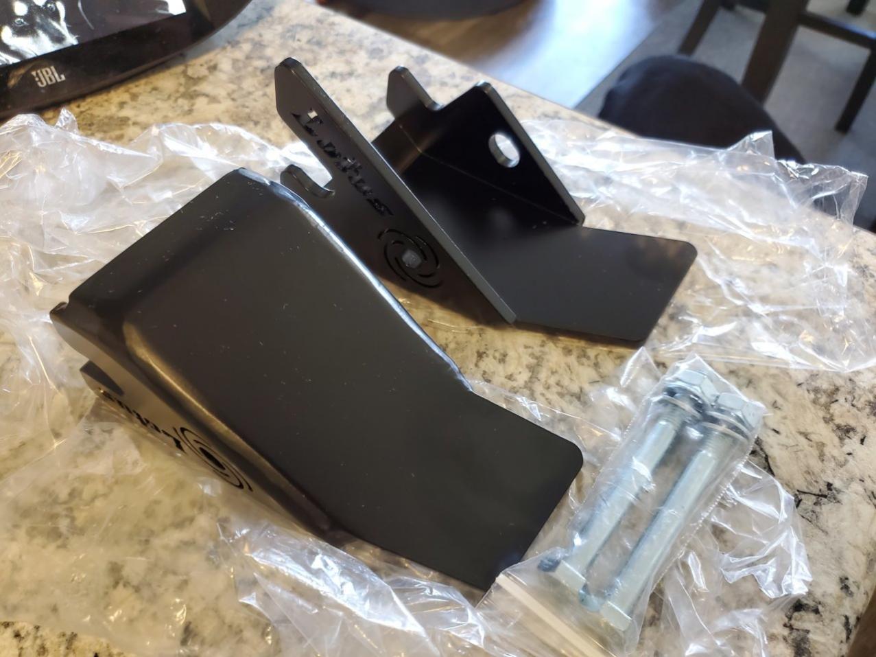

Tonight, I just started a Satoshi grill mod using a 2nd Gen Toyota, hard to find, radiator grill letter emblem. - Will post up once completed.
Due to a lack of welding, let alone any non-battery-powered electricity, I installed a set of Shrockworks bolt-on sliders in the vacant (holiday) parking lot at my job. Much cursing, flying hot metal shards, and a $50 step drill bit later, they are rock solid.

Got any pics from how it looks from the side?
Are bolt-ons better/worse/same as welded on ones?

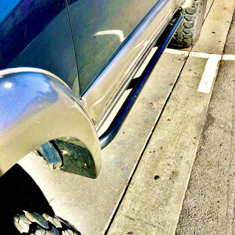

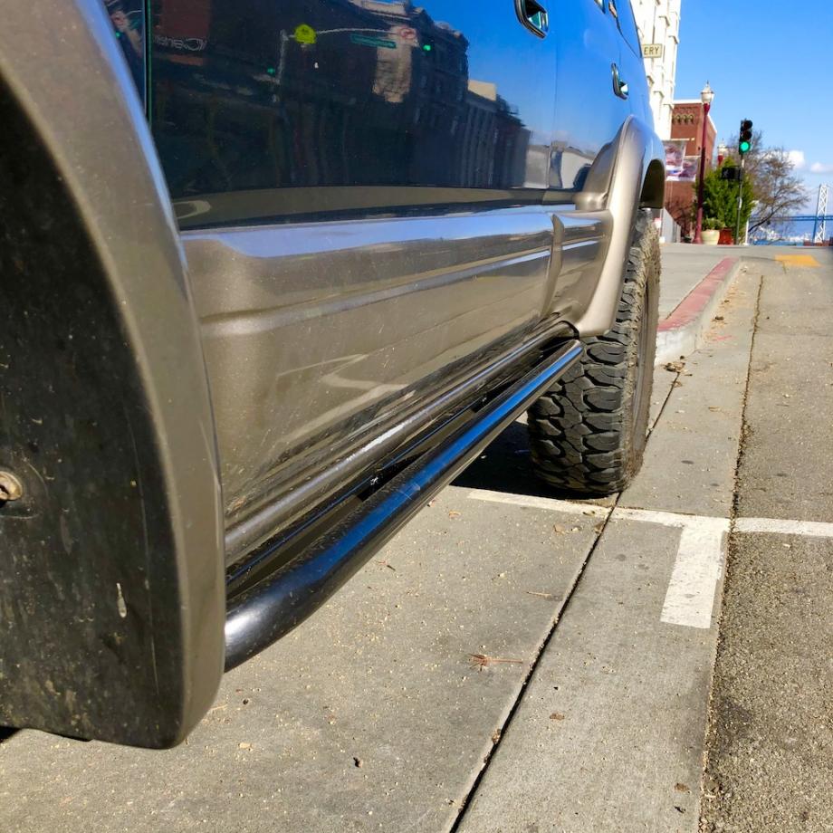

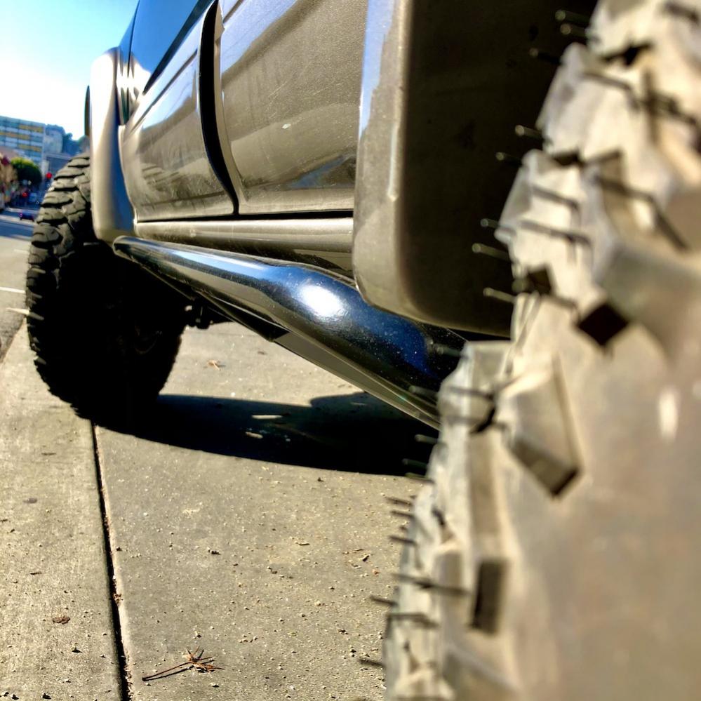

I'll grab a side shot today - they are subtle (I got the 30 degrees angled-up version). The flat version can be used as steps - not so much with these.
There are pros and cons for both welded and bolt-on sliders. The important thing is quality of the steel used, the skill of the fabricator, and the design. Nowadays a lot of people go with a kick-out design. I went as basic and tucked-in as possible. Minus 5 Overlander points.

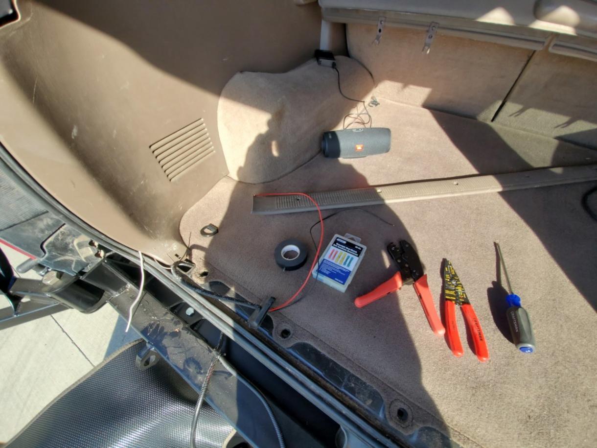

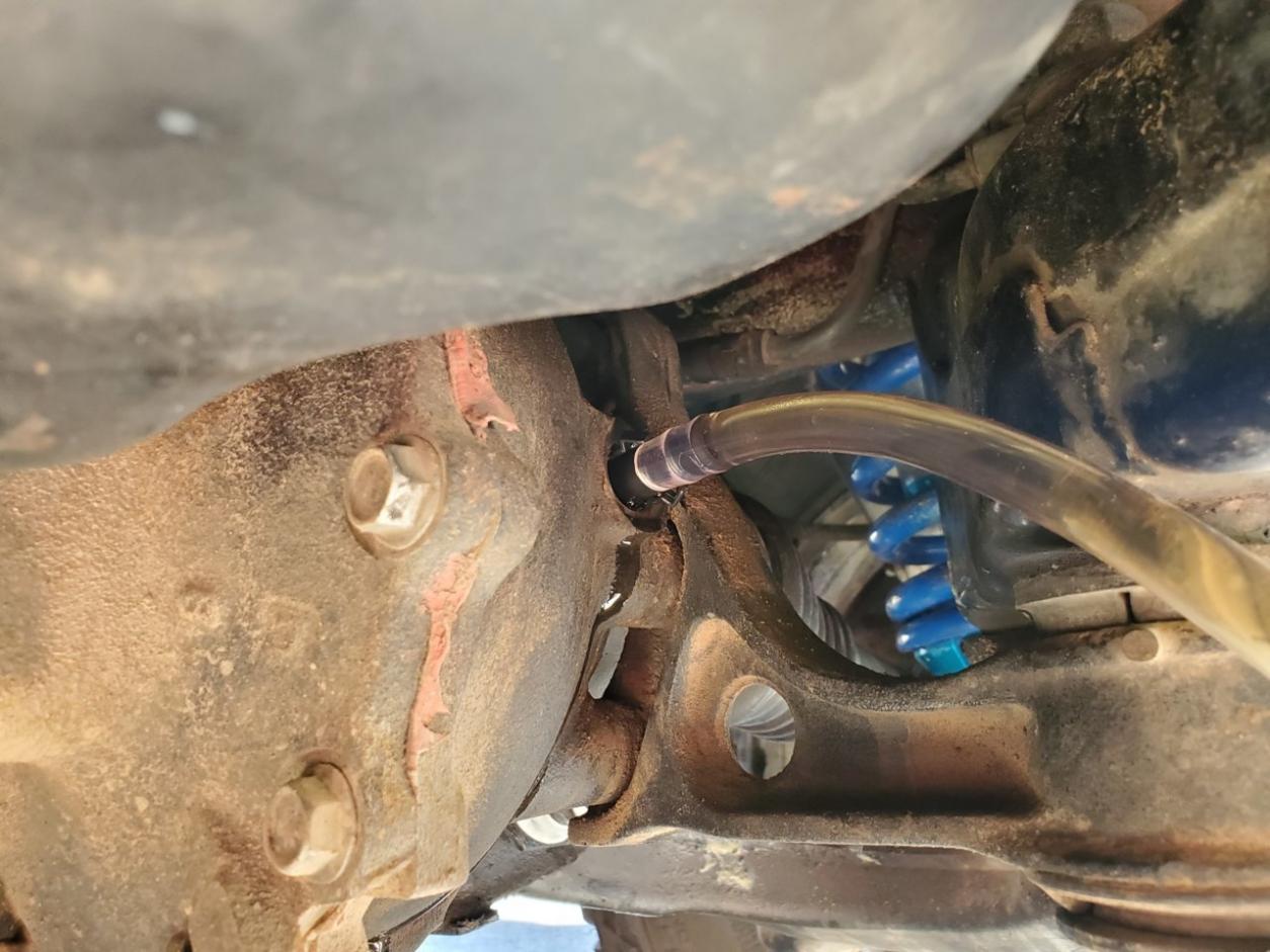

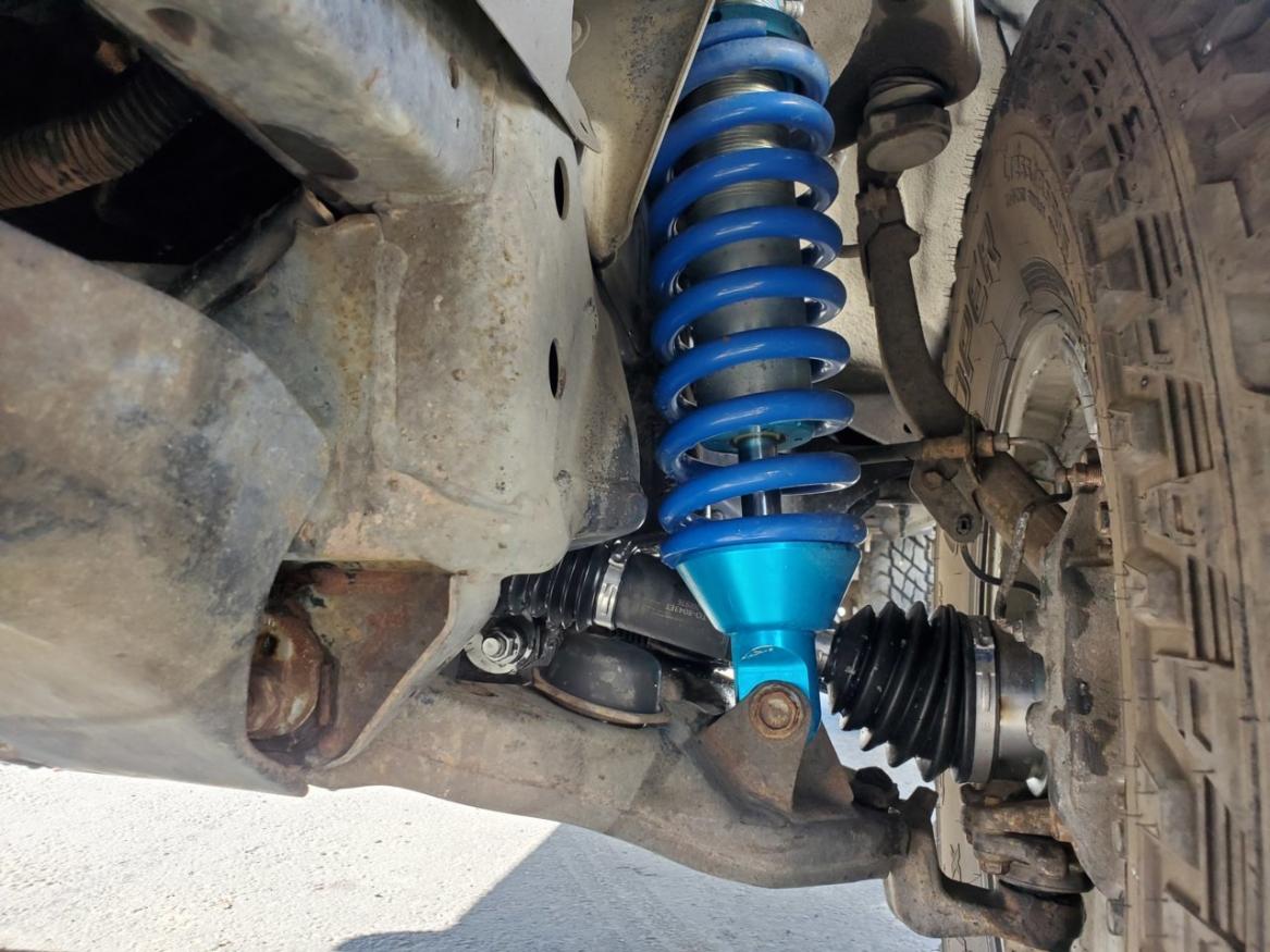

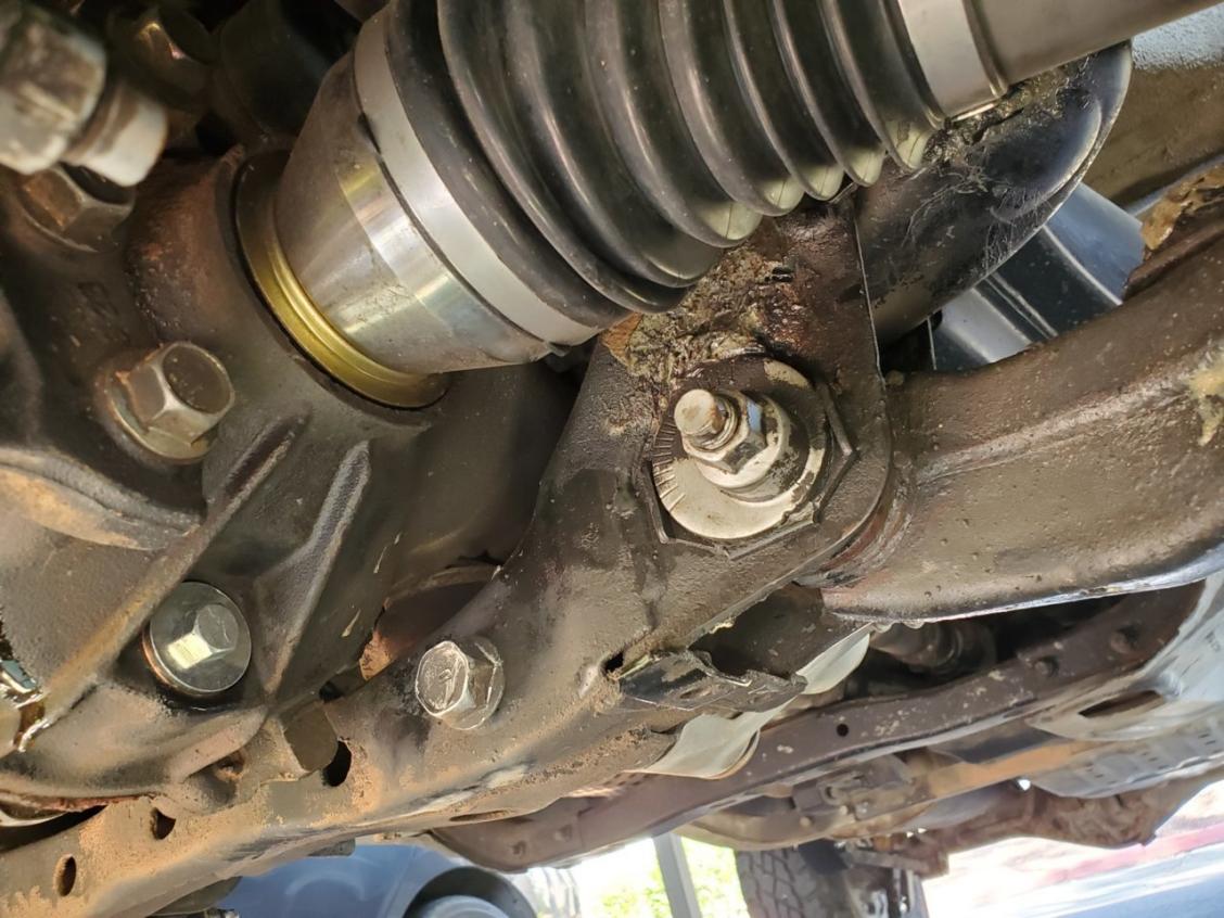

Couple of things; replaced my other cv axle so now I've got ext cv axles on both sides, front diff drain and fill not to mention replacing the drain plug for the lexus plug, wired up a rear LED light for my dual rear swing out, rear LCA skids, and rear lower links.
