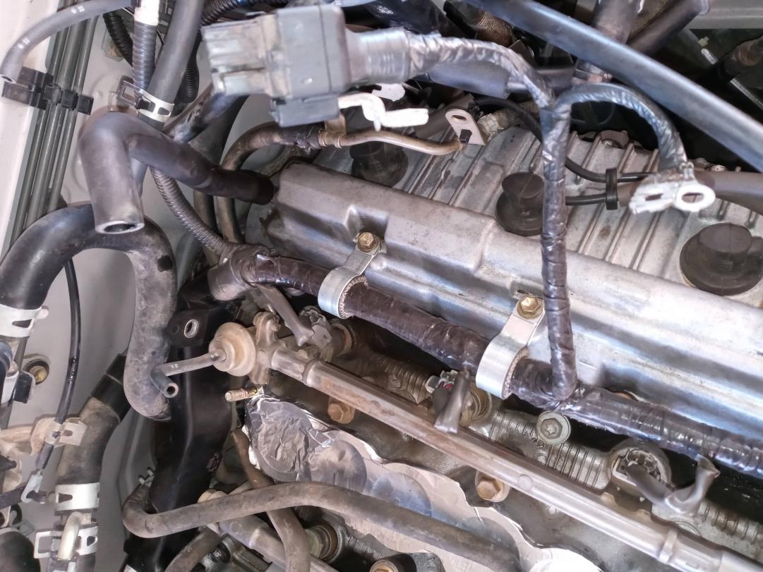

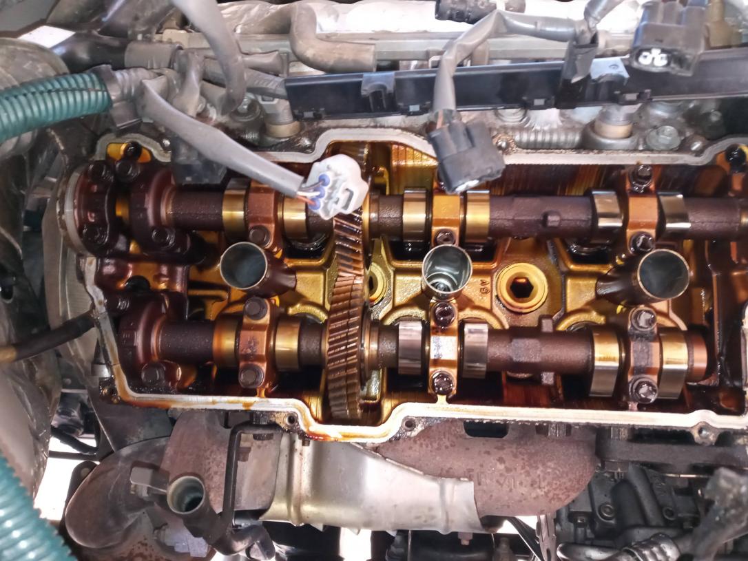

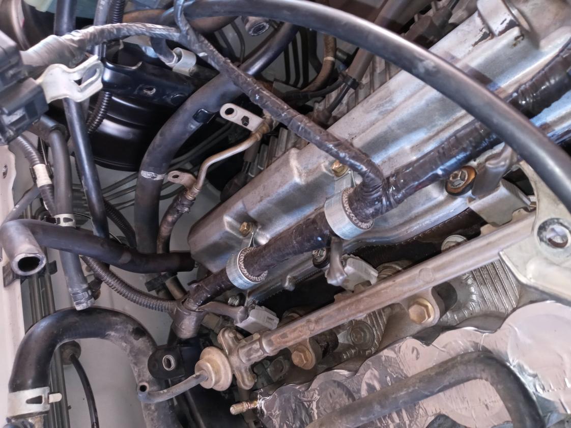

Did the VCG job today, it was about time. Bought the Runner at 165k, 225k on it now. Nothing but Toyota branded 5-30 oil and OEM oil filters from the dealer since I've owned it...every 3-5k miles, new oil filter every other oil change...very happy with how clean the top of the heads look. Lost the “hardened” PCV valve grommet in the baffle so had to dig that out, and flush (the biggest pain). Everything else was pretty straight forward thanks to Tim and his videos (thank you Tim and Sean!). Underside of the valve covers had a little scale. P/S wire loom cover was okay besides the mounting tabs to valve cover (you can see where they broke in the first pic), D/S loom cover crumbled into a thousand little pieces as expected. Wrapped loom with self fusing silicone tape apparently good to 500*f and made some new mounts from modified cable straps and some leftover silicone intake tube to stop the chaffing...

Nice idea with the mounts for the wire harness. My tabs broke when I did the job a few years back. I may try something like this. Thanks!

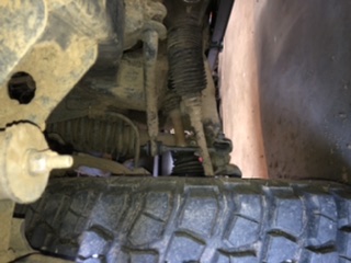

Got this parts in. Still waiting on steering rack bushings. Then I’m doing the replacement this weekend [emoji16][emoji16]

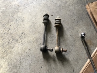

Scrounged up some rear end links from a 2nd gen for the front of my third gen. They’re an inch or so longer, we'll see if it makes a difference.
